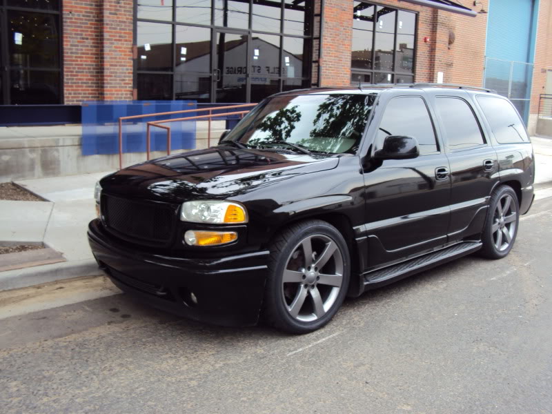

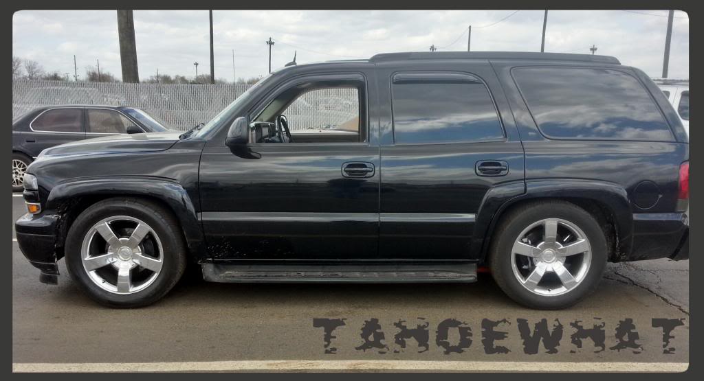

Model/Year/2x/4x/AWD:
- 2003 GMC Yukon
Advertised drop:
- 3"/5.5"
Fender height front/rear:
-32.00/32.50
Front:
- LCA's : Stock
- UCA's : Stock
- Spindles : Belltech
- Sway Bar : Stock
- Tie Rods : Stock
- T-bars : stock
- T-bar keys : stock
- Shocks : Belltech Street Performance
- Steering : Stock
Rear:
- UTA : Spohn adjustables
- LTA : Spohn adjustables w/ DJM relocator kit
- Springs : DJM 5.5" Trailblazer
- Panhard : Spohn adjustable
- Sway Bar : Stock w/DJM end links
- Shocks : BellTech Street Performance
- Air Assist : None
Wheels & Tires:
- Wheels : 26" 2 Crave No.4
- Tires : Lexani LX-7 255/30/26
Considered upgrades:
- Belltech sway bars, upgrade brakes, air assist. I'm sure theres more that I can't think of.
Brief impressions of setup:
Rides way smoother overall. Bumpy on a bumpy road but thats the nature of a slammed truck. Handles amazing and very responsive.

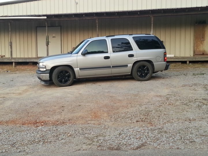

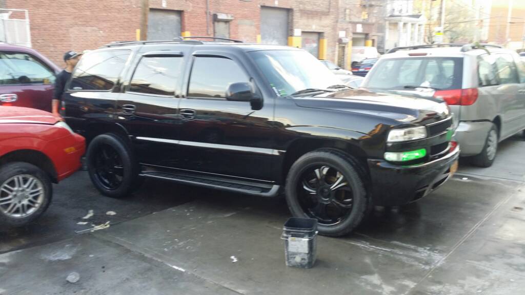

- 2000 Tahoe LT 4x4, Light Gray Metalic
Advertised drop:
- 3"/5"
- 32.25"F/33.25"R
Front:
- LCA's : DJM 3" Drop Arms
- UCA's : stock
- Spindles : stock
- Sway Bar : stock
- Tie Rods : stock
- T-bars : stock
- Shocks : Bilsteins
- Steering : stock
Rear:
- UTA : stock
- LTA : stock
- Springs : Belltech 5305
- Panhard : stock
- Sway Bar : stock
- Air Assist : None
Wheels & Tires:
- Wheels : 22" Foose
- Front Tires : Toyo ST-2 305/40/22
- Rear Tires : Sunny 305/45/22
- Eventually would like some lowering keys in the front, and remove a couple dead coils in the rear to lower it another inch or so.
The front rides very smooth and controlled with the Bilstein shocks. Would like the shocks to be a bit more firm for the front but overall ride is excellent.
The rear ride is much improved since installing the Bilstein shocks in the rear. Very controlled, firm but not too harsh at all.

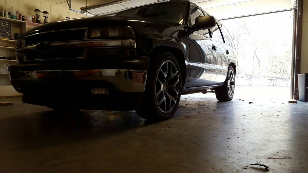

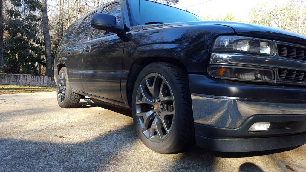

2001 Tahoe.
2" front DJM Spindles with Bilstins HD shocks
Rear 3" coils with drop brackets for shocks and Bilstins HD shocks and Air helper bags in rear springs.
Tires and wheels 275-55-R20's Nitto 420 tires
To do Spohn performance rear adjustable kit and panhardbar. And Upgraded sway bars.
