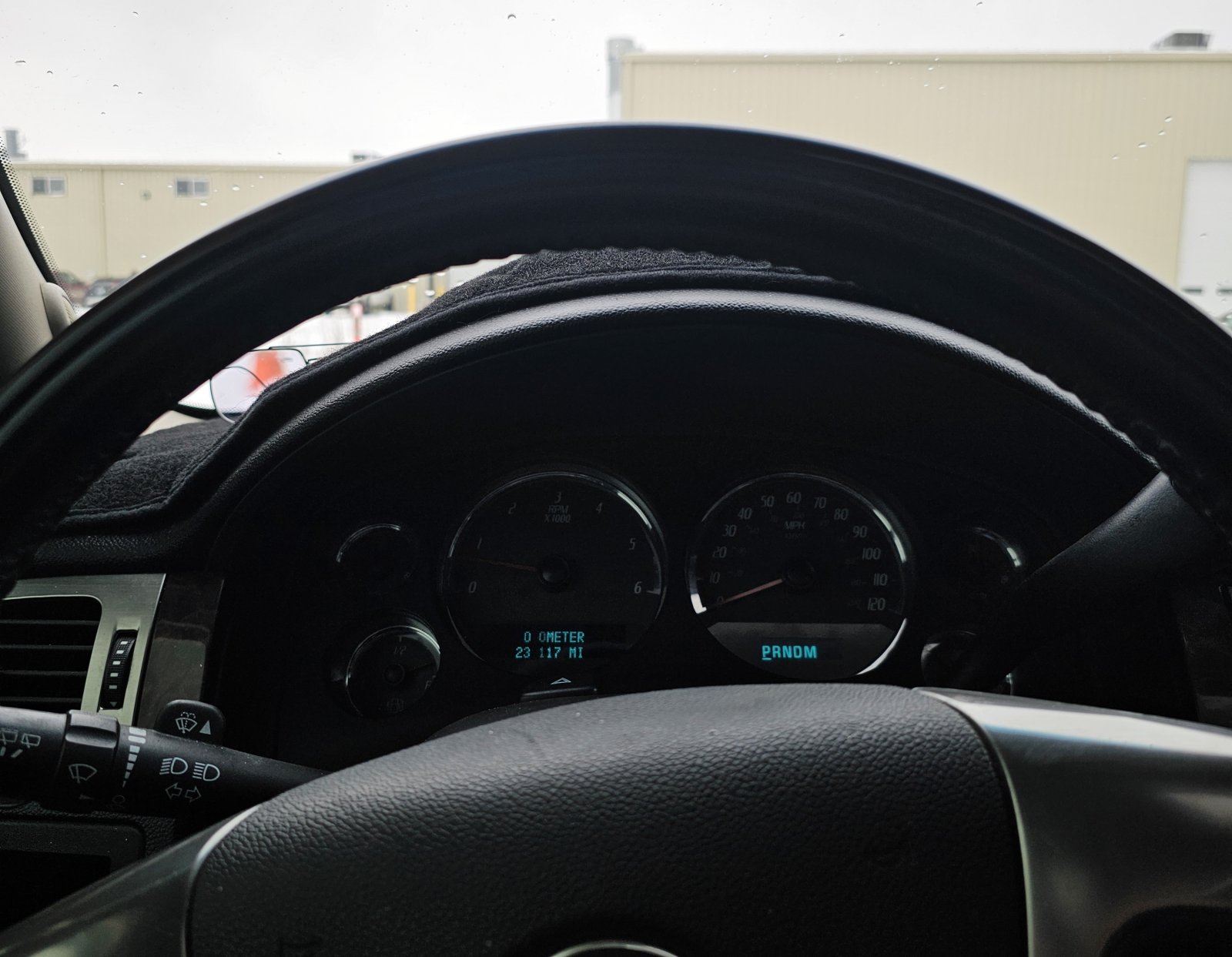

Driving my wife's 2014 Avalanche I notice the IP lights are always on during the day when lights set to auto even on bright sunny days.
The IP lights on my 2007 Yukon never are on during the day when set to auto. Normally i turn on park lights so i can see the IP during the day.
On a sunny day It's very hard to see the gauges and speedo. Here is a pic i took today around noon with truck running i took of the IP.
Is this normal for an 07 IP and later changed to always on in later years?
View attachment 449396View attachment 449397

It *seems* to me that there could be 3 modes for the backlight.
Daylight, backlight bright, guages bright.
??dusk??, backlight is dim, guages have no backlight!
Nighttime, backlight is dimmed, guages are dimmed.
0-3000 ohms on the signal wire (white) from BCM to ground will give you daytime bright backlighting.
5000-15,000? ohms will be nighttime dimmer.
It will switch when dipping below 3k ohms, or climbing above 5k ohms.
When I wire up some resistors and switch from dim to bright (10k -> 680 ohms), the guages will blackout for ~3seconds before going full bright.
But the DIC display does not blackout. (Don't remember if there is a delay or not.. don't think so)
Switching from 680 ohms -> 10k ohms, the display & guages go from bright to dim, with no blackout or delay.
Does your avalanche also have a dashmat? Perhaps try swapping light sensors and see if the behaviour changes?
