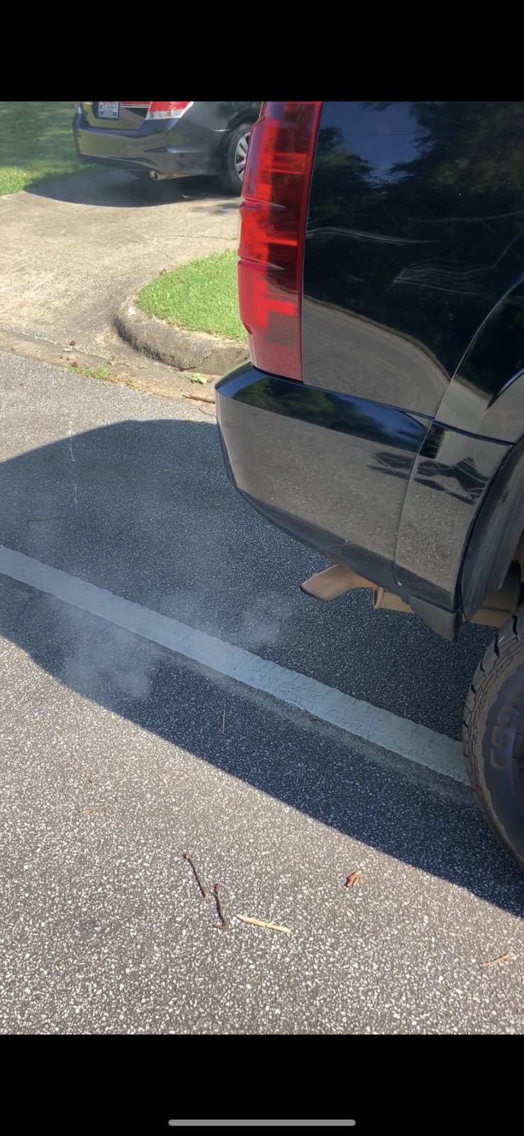

Anyone have anything similar before?

I get that same smoke after a cold start as it warms up. That is normal. When driving the heat builds in the exhaust. When shut off engine the heat will cause condensation in the exhaust system while cooling down. Then that condensation gets heated up on a restart and causes smoke like this. That is grey smoke and a byproduct of this process. When you have coolant burning white smoke it will look thick, like cotton candy. I see no problems with this smoke.
I would guess that if there is a problem in the evap system this same smoke could differ than what you are used to seeing and of course that needs to be addressed.

Problem is it spits this consistently at idle and even heavy when rolling down the road
