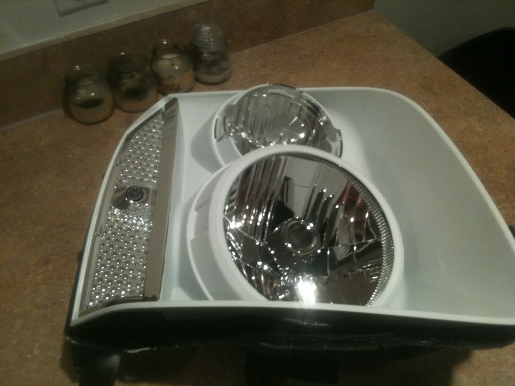

Here is one I done gonna see how I like it before I seal it up may change not sure. 486608c1.jpg e9dc1ba3.jpg 97461f82.jpg

hhmmm that looks like a matte white. my neighbor has his gloss. matte def looks better IMO. sorry cant get pics camera on my iphone is acting up for the second time in a month lol

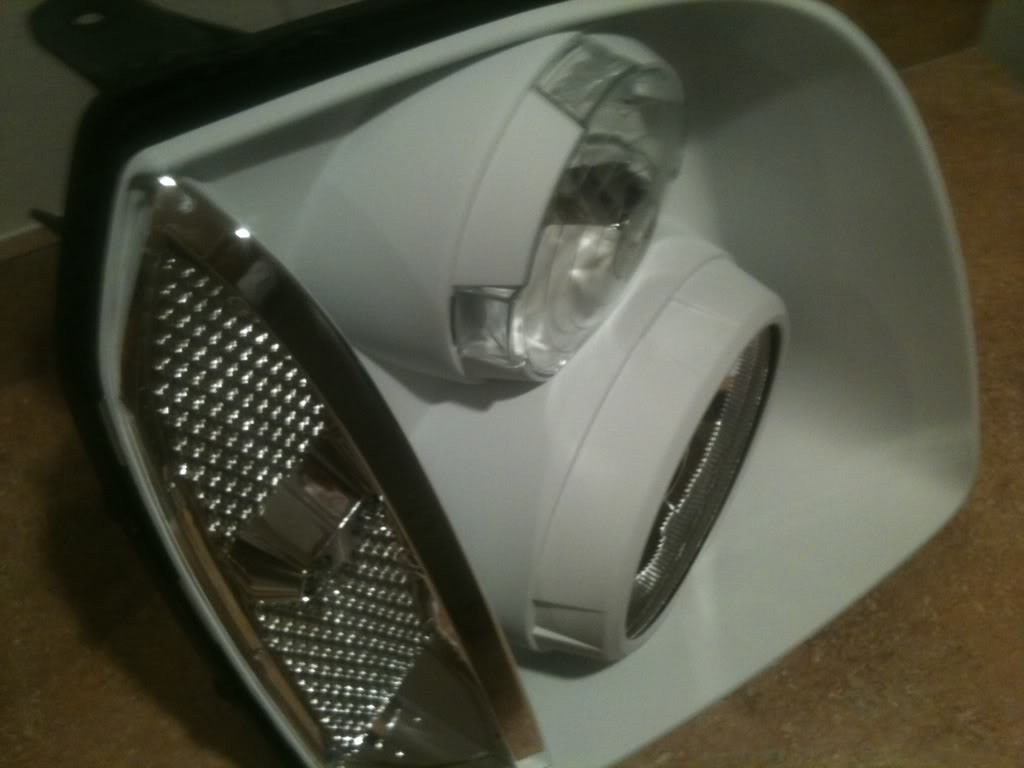

So how did u separate the lights did you bake them?

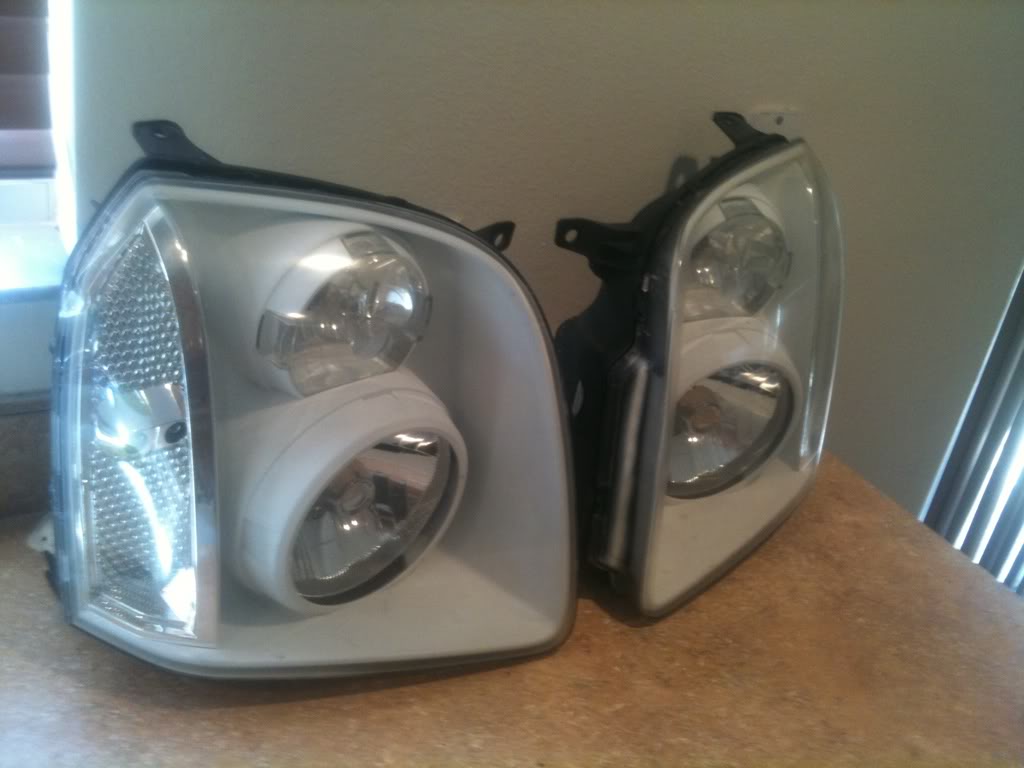

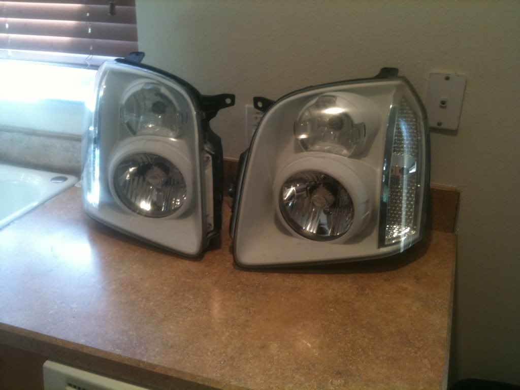

Yeah I put them in my oven on 250 for 5mins then pulled apart with a flat blade, and still had to use a heat gun for the parts that was stuck real good

And yes it is matte white

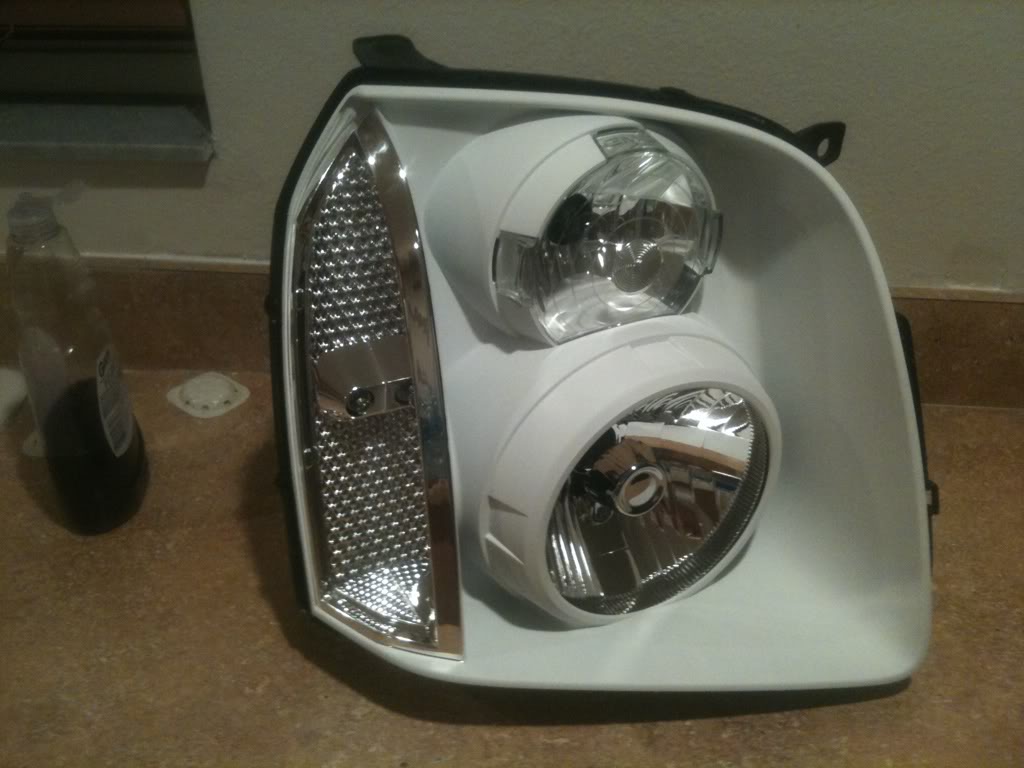

Does painting them hamper light output? or is it just aesthetics?
light output doesnt change since your not painting the reflector.
so are you just going to leave the amber reflector off? An all clear one would look good IMO, but I have no idea if they make them like that

You want to see one that is all chrome just without amber ls that what you are saying? I still have to paint the other one so I can snap a picture of what that would look like for you.
