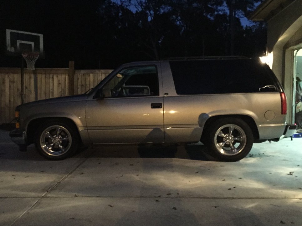

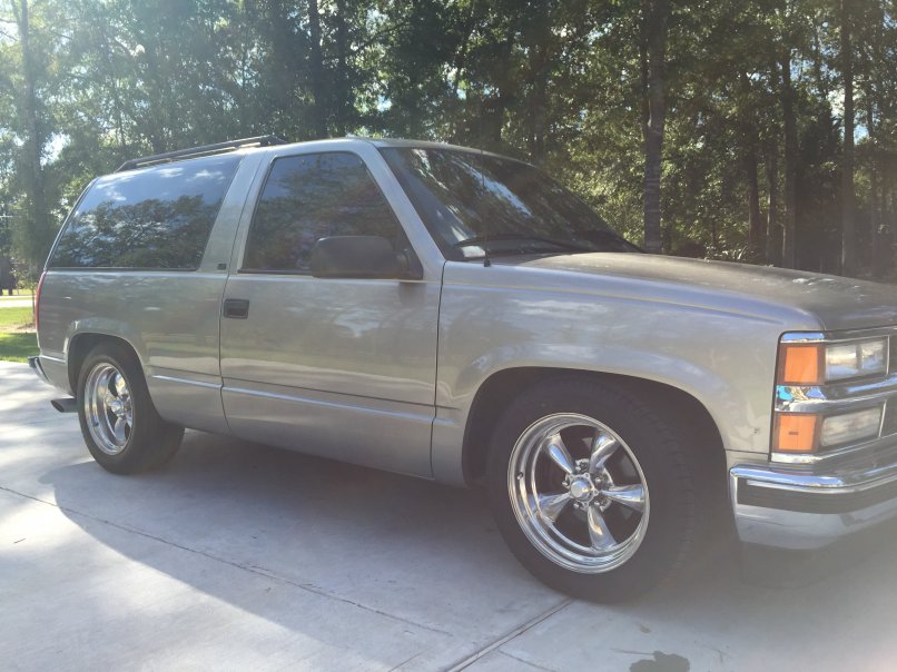

Well here she is!
Her new home!

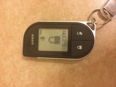

Added a Viper 5706v alarm and tinted the windows 5% out back and 20% up front

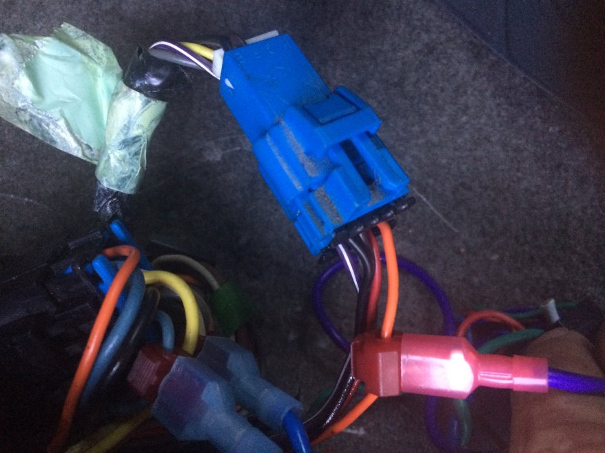

Also for anybody having problems with their locks not working the alarm guy helped me out. These two harness are behind the driver side kick panel by the hood release latch. I thought the actuators were out but he got them to work by jumping the 2 orange wires. I tried the fuse and it was good. I changed out the keyless entry relay under the dash and that didn't work. Ill still be searching for a solution instead of the jumper wire but its working fine as is now.
