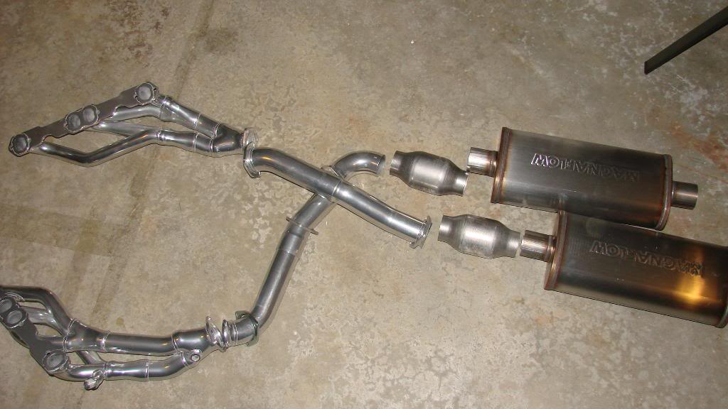

Running mine true dual from headders two 2.5 magnaflow cats 2.5 x-pipe and 2 two chambers mufflers with dumps for the exit all runs on the passenger side. Will start 2.5 then go 3 inch after x pipe into mufflers should sound nice and no more pops.

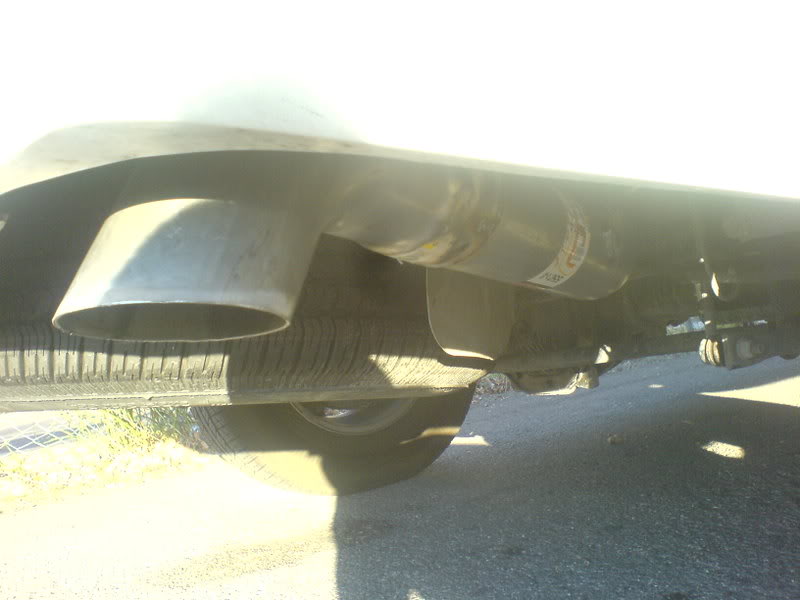

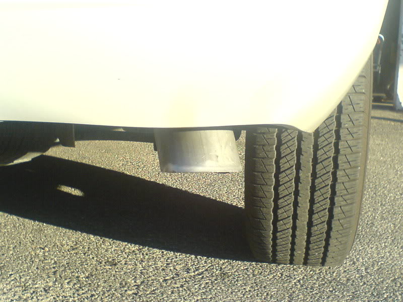

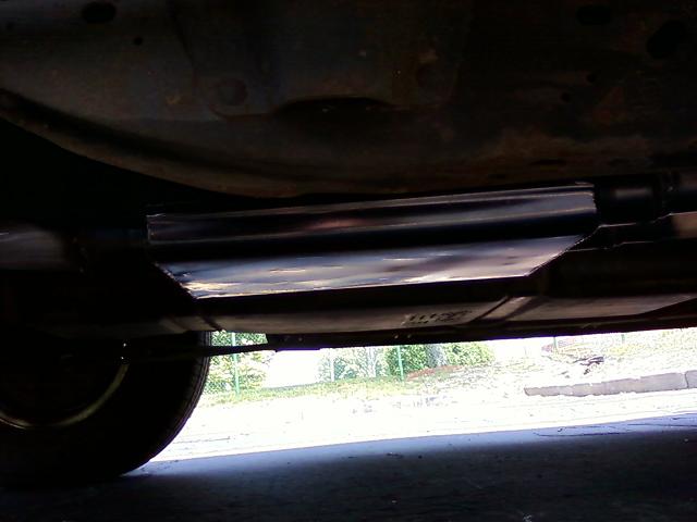

I'll post up some pics of mine tomorrow if I finish by then..
Edit: Here they are.. it's not pretty but it will do for now

Thats a sweet set up. I'm planning on doing mine like yours but I have a 2wd so I have quite a bit more room. Is it obnoxiously loud? What kind of power are you making with your set up? I'm jealous.
718frankb,
Very creative. How does it sound? Is it a Flowmaster? If so what series?
DJTricky,
How does it sound inside with the Flows? Any drone?
destroyer1362,
How does that sound with the Borla? Also how does it sound from going to a di/si to si/so? Specs on muffler?

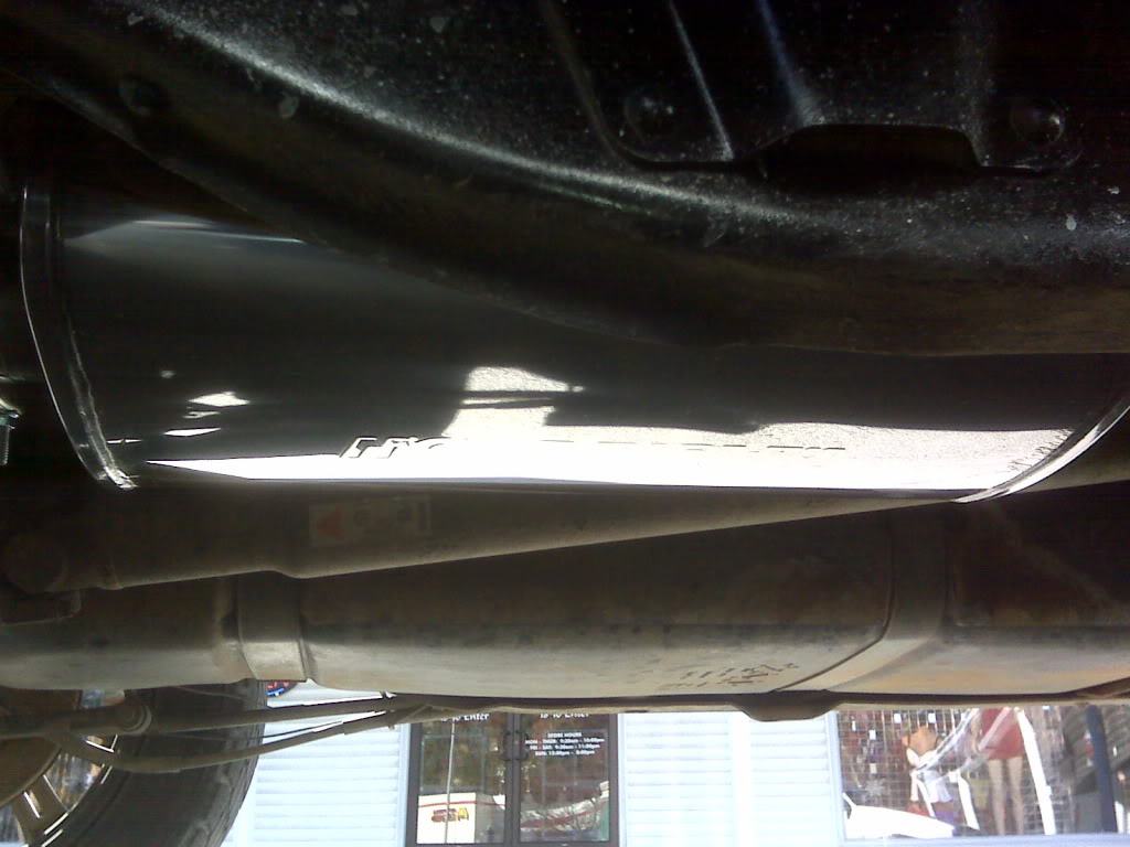

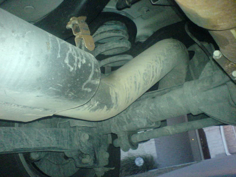

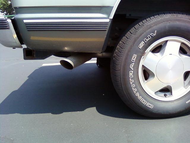

The muffler is a borla turbo 2.5 center in/ offset out, and the y-pipe is a stamped magnaflow 2in in/2.5 in out. When idling you can only hear a light rumble inside the truck. I think its quieter then a fm 40. When accelerating it gets pretty loud but not overwhelming, you can still carry on a conversation. I'm pretty sure it so quiet inside bc im running a single out. One more thing, according to my friends the thing is pretty loud if your driving next to me if that makes any sense.

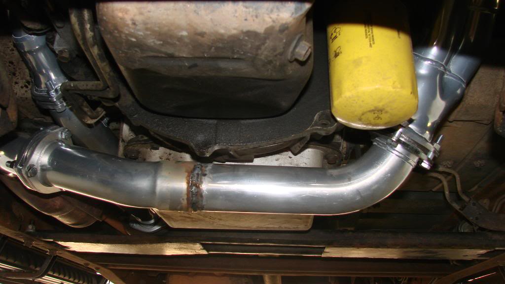

update: It looks like I'm going to stick with the Thorly Y pipe and run it in the stock location. I thought I had enough SS to run it the other way but, unfortunately I dont.
