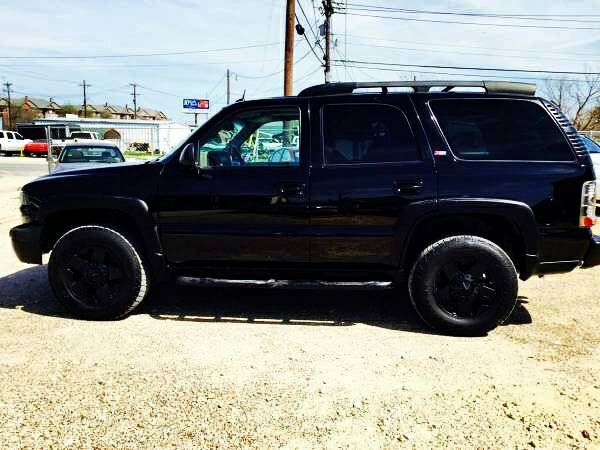

what size wheels are those 35s sitting on and do you get rubbing?
Mines on 17s and not much rubbing unless I put it in a pretty good bind while I'm turning!

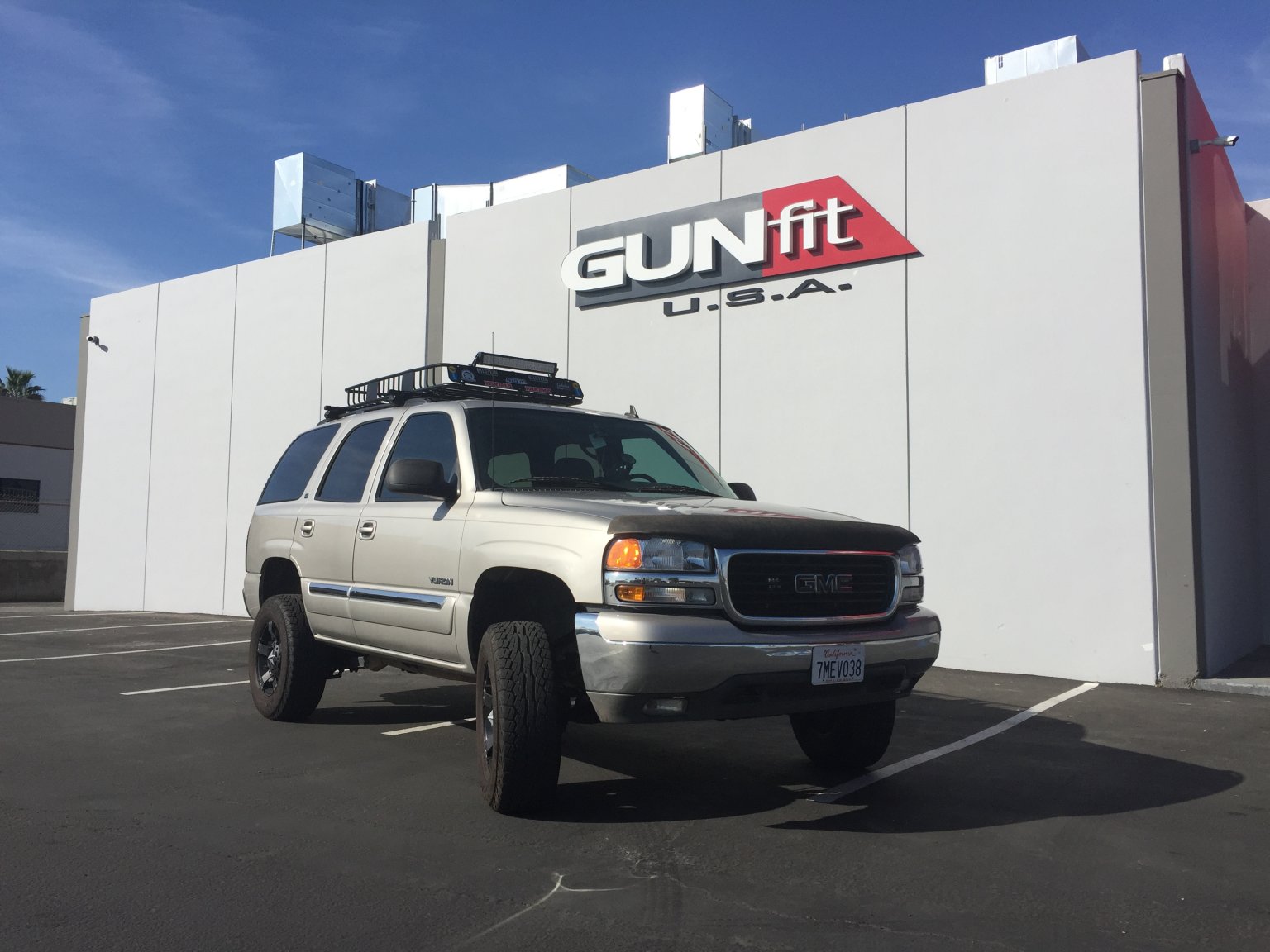

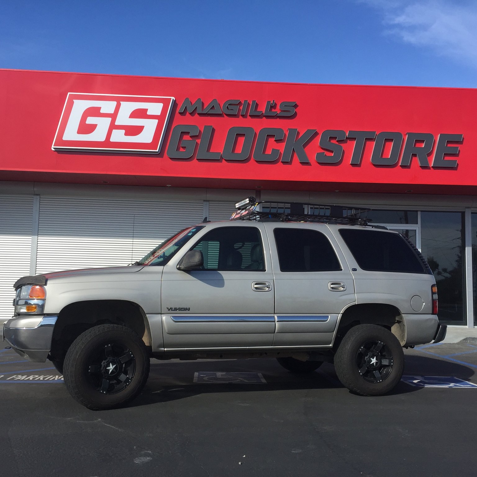

Supreme suspensions lift keys. Passenger side 04 torsion bar on my drivers side. Cranked a good bit on Yukon 17s and low tread Toyo 35s
Does not rub on fender or bumper/valance. Rubs on little metal bracket at full lock. Also rubs on rear shock bolt when rear cycles completely.

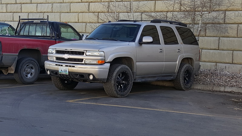

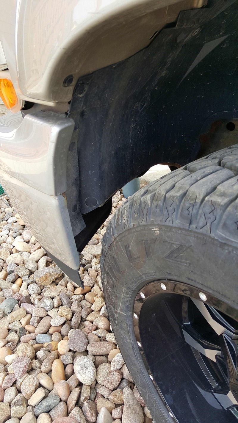

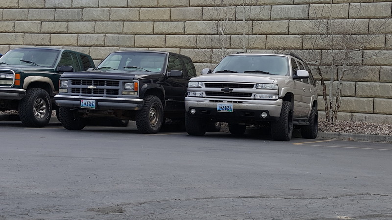

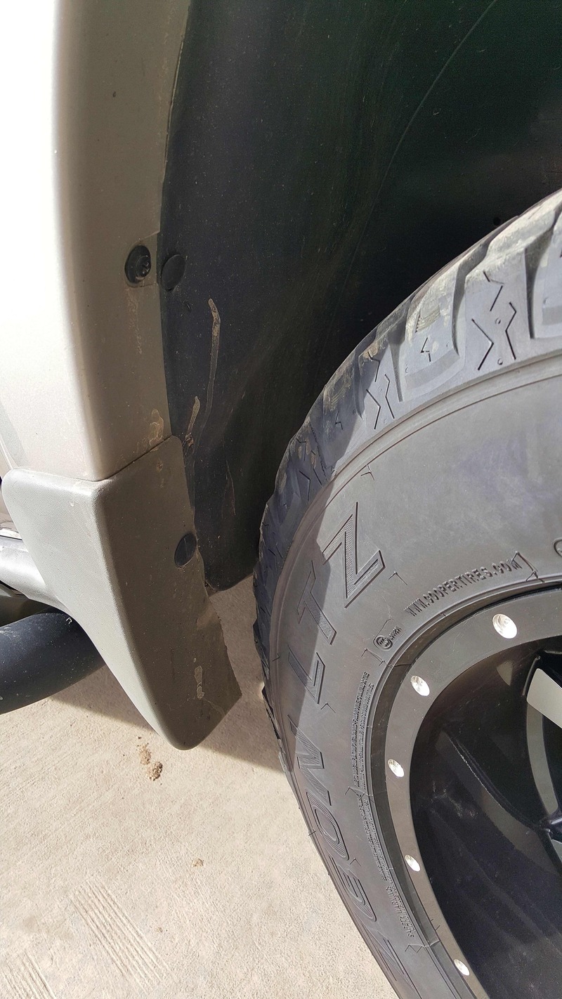

Need to get new pics but here is the gist
Here is the rear
That's clearance you want to fit 35s!
These are all old pics. Will get some new pics tmrw as the stance was adjusted and changed as well as track width in front.
I have 9" of lift with stock keys. 6" lift with 3" spindles up front. In pics it's way de crunk! To be more like 6".
Currently they are cranked like stock for ride quality. So the front is higher. Going to replace my 1.5 in spacer in the rear with either 2.5 or 3 and crank the keys or put in my lift keys. Riding decrunk is just too soft a ride. Lol
