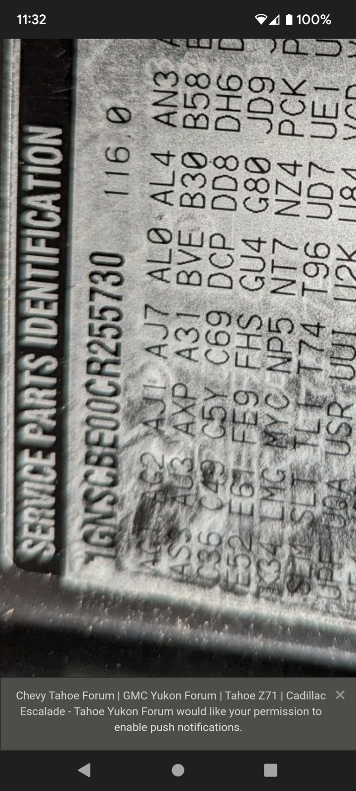

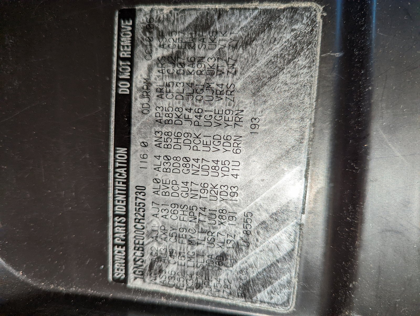

Well, after lots of driving and thinking on this issue I think my next move is to talk to Bilstein and find out what coils are made to work with the 4600's I have in the rear and the ACDelco front struts.
(ACDELCO 540615 (540-615) Strut).
I'm attaching pics of my codes and the springs currently installed. My assumption is they are original.

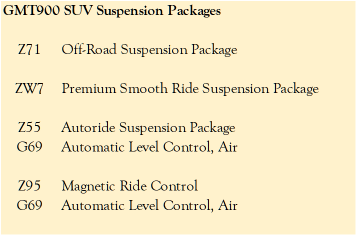

Parts selection and tires contribute greatly to the ride quality. I like having over seven inches of sidewall!
True. I do know that my tires are part of my problem since I have the Brickstone Duellers that are OE for the later models. Still, when I had my GoodYear Eagles and stock suspension, it rode about the same as it does now. But, those were really old AutoRide struts. So, the BT struts just ride stiff, like OLD AutoRide struts and (hopefully) not how new ones would. Mark @S1W99 has Michelin Defenders (IIRC, the stock 20" size), so, he's good on tire selection. It's a parts issue for him and me. More sidewall isn't conducive to my driving style or environment.
Mark doesn't have active suspension, so this part is irrelevant to him: James @swathdiver, can you reset the AutoRide suspension controller in these things? I'm under the impression that they firm up the shocks incrementally based on time, mileage and cycles to account for wear. When I unplugged mine, it rode dangerously soft. But, that confirmed that the struts and shocks were worn and the controller was making them firm. I know the suspension controller can be reprogrammed, as they were on the K2xx due to them making the shocks excessively firm when unnecessary. I'm curious if there's something, maybe in the Tech2, that can be done.
