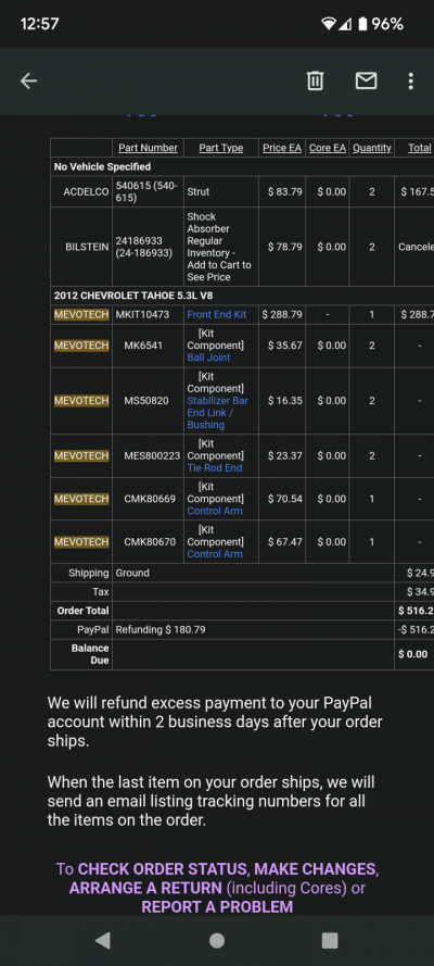

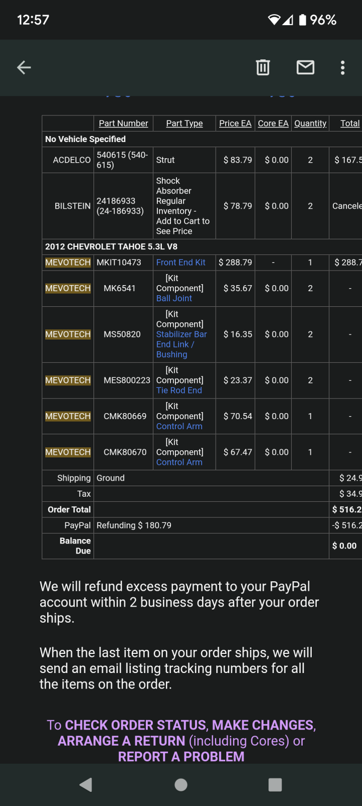

Tried three times today to get the part coil spring part# from Bilstein's site for my truck. Only shows me the shocks. I'll try to call them tomorrow.
As for the front ACDelco strut, with of all the OE parts listed on RockAuto, how do I know which spring is for my truck?
