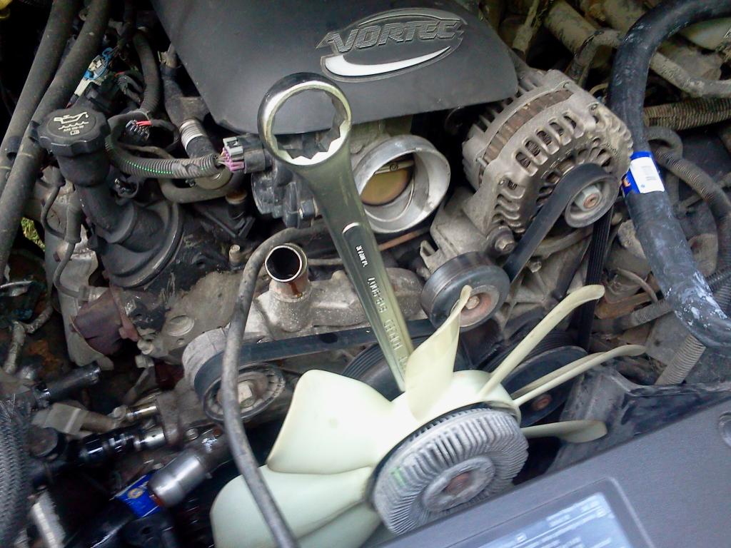

just did mine last month, the hardest part of it was removing all the plastic shields to actually get to the pump
& if you still have the stock fan I think its a 1 1/2" wrench I used to remove mine
