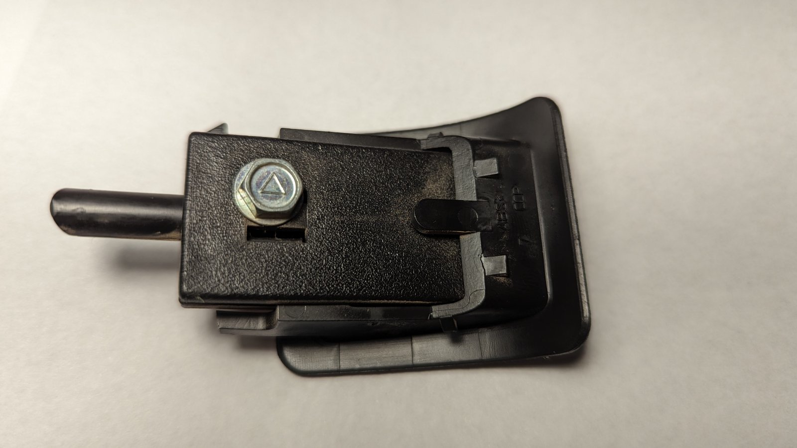

One of the few things I am working on is trying to get those rear doors unlocked :mad:. I can't open the doors from the inside or outside. I managed to pull the lock knobs out and found this:
But removing that bolt, I don't think will fix the door issue. I wouldn't want to but I feel like I might have to "gorilla" the door panel off to get to the linkage. Any thoughts?

check where the front doors latch for a choke cable pull knob.. thats what mine had to lock both rear doors..
