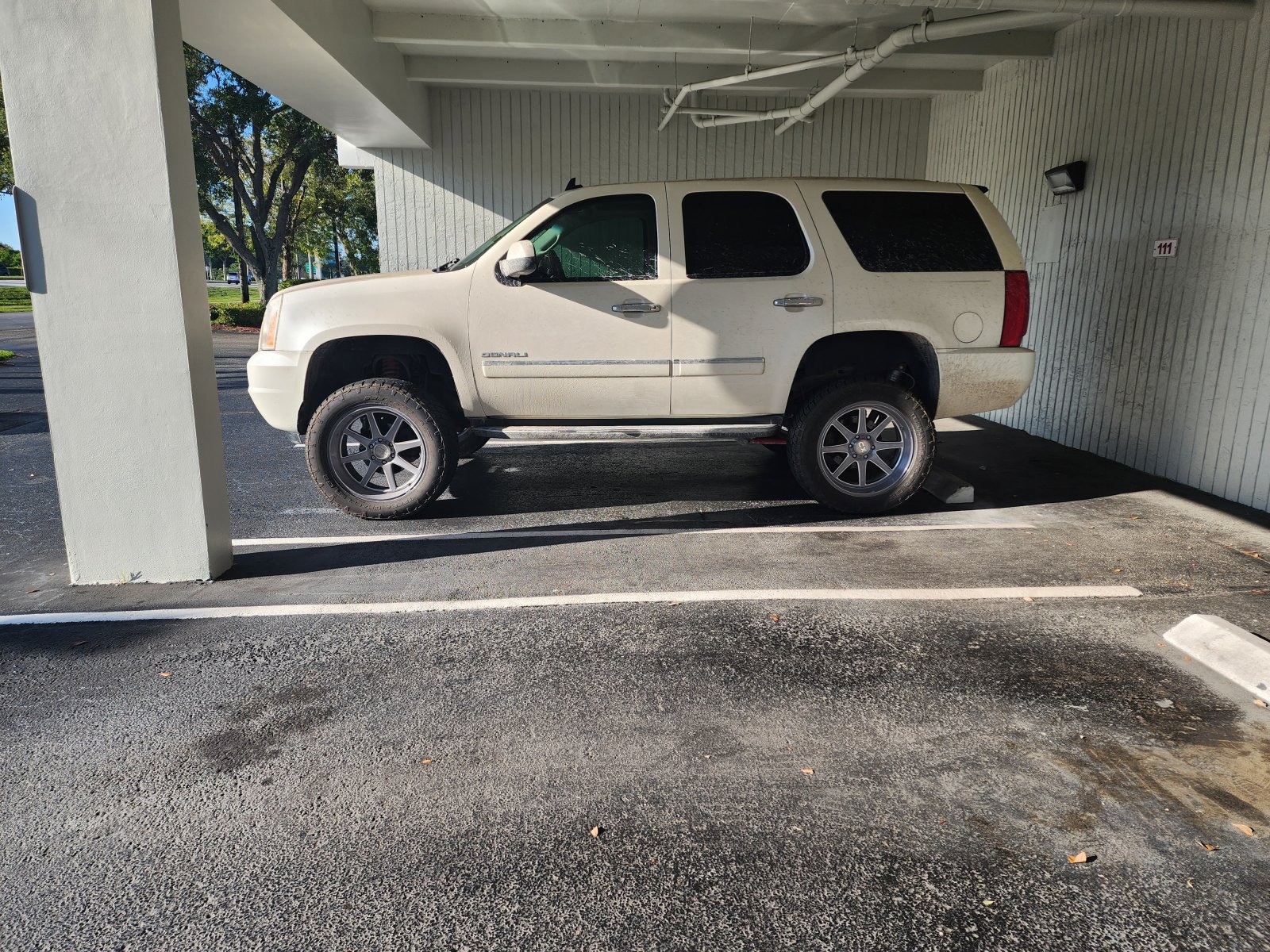

drove yukon to work, its kinda dirty
i95 gauntlet wasnt bad, cruised 80+ most of the way.
rear end feels like it moves so much not sure if spoon bars are flexing or delspheres just allows to much motion or wtf. kind of want to go back to a stiffer poly bushing that restricts most motion to just up and down
