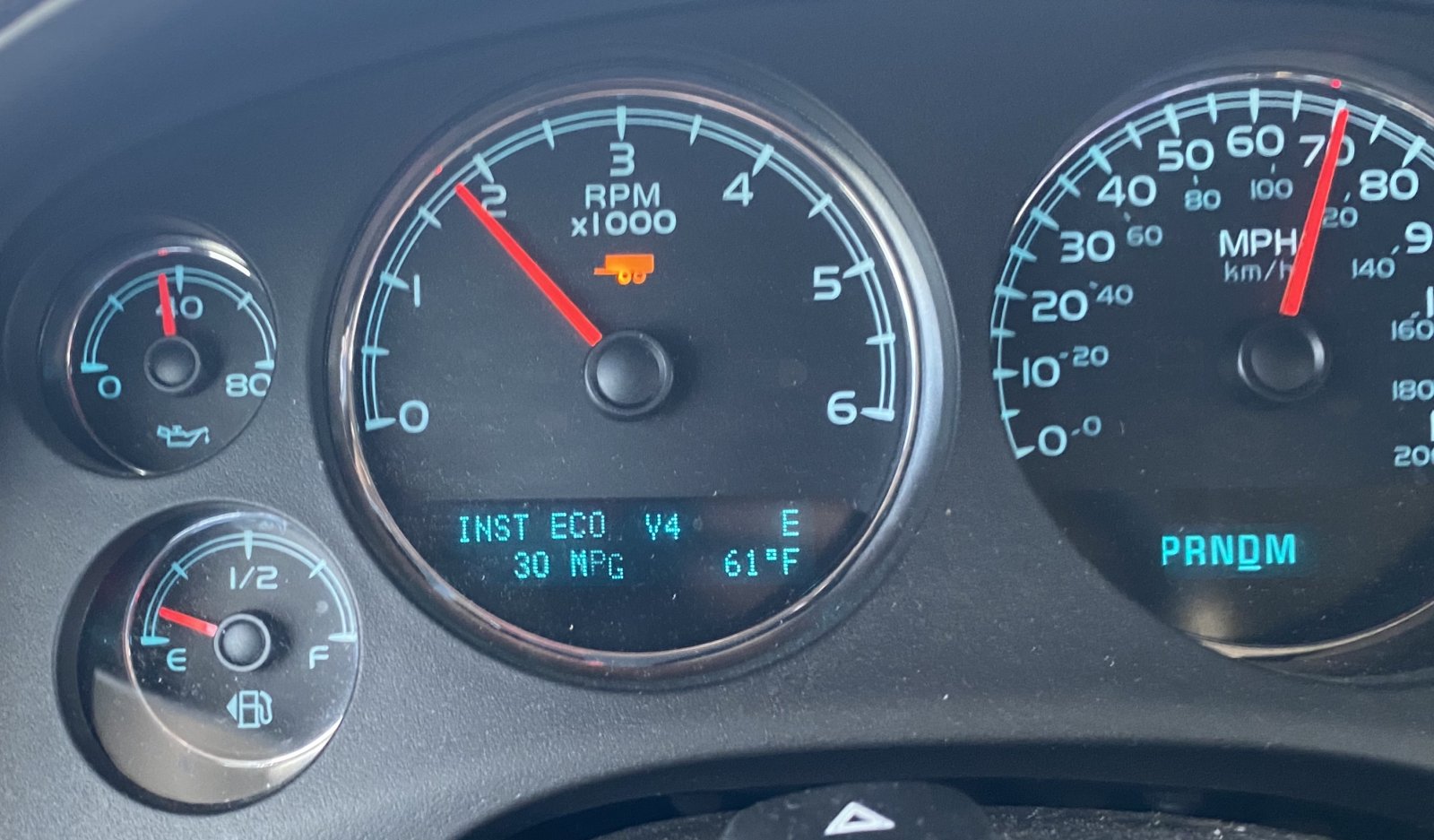

So the disabler wont help at all? I only have the noise in v4 mode and it stopped when it kicked into v8.
And yea what’s $2500 loan for repairs on top of my vehicle loan. Bank said they could approve me. It’s just a game of is that really the issue. Because, like I said, I only rode with the mechanic, and he said based off the sound, and that noise only happening in V4 mode (he finally heard the noise this time, I had went a few times before and they said they can’t hear the noise) that it’s most likely lifters. That’s not on paper or anything yet so
