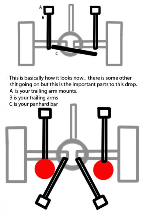

alright here is an education...
If your wanting to install air ride in place of the springs then that is NOT the kit for you. If your wanting to do it the simple way then you will need to fabricate upper and lower cupps for the bags to mount to. And these will bolt into the spring pocket. Doing it this way will get you at the most a 7" drop aired out. and you will not have a low ride height. its gonna be like closer to a 4" drop at ride height. Now if your wanting to tuck tire, lay frame and go all out, (like I am) you will need new rear links (either 2,3,4 or ,6 wishbone triangulated, parallel) a step notch, cut out the floor, & new wheel tubs. Now if your doing all this work to the back; the front is gonna need the UCA's moved up 1.5"s, new lower control arms flipped uppers and welded on bag mounts.
