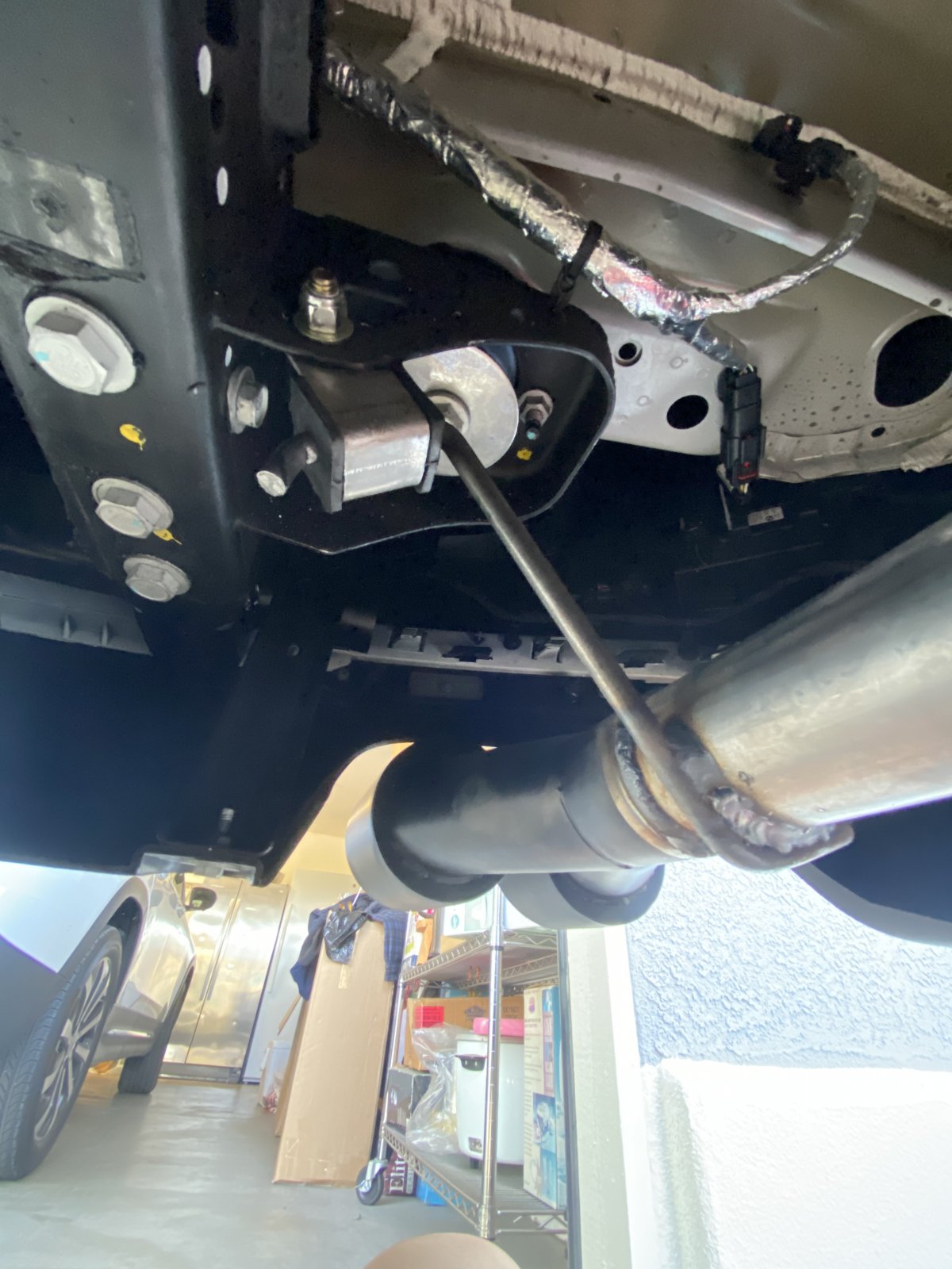

Does anyone know if there are the correct exhaust hangars on the vehicle for a quad exhaust on vehicle with a single exit exhaust? I looked under my z71 on the driver side rear and did not see where the exhaust would mount.

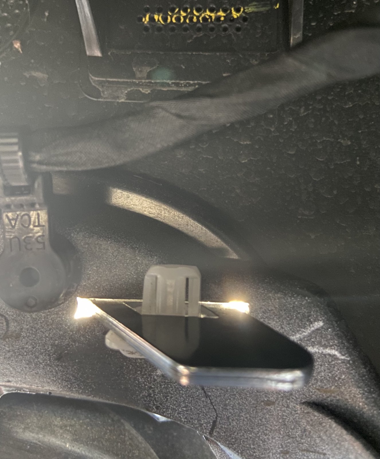

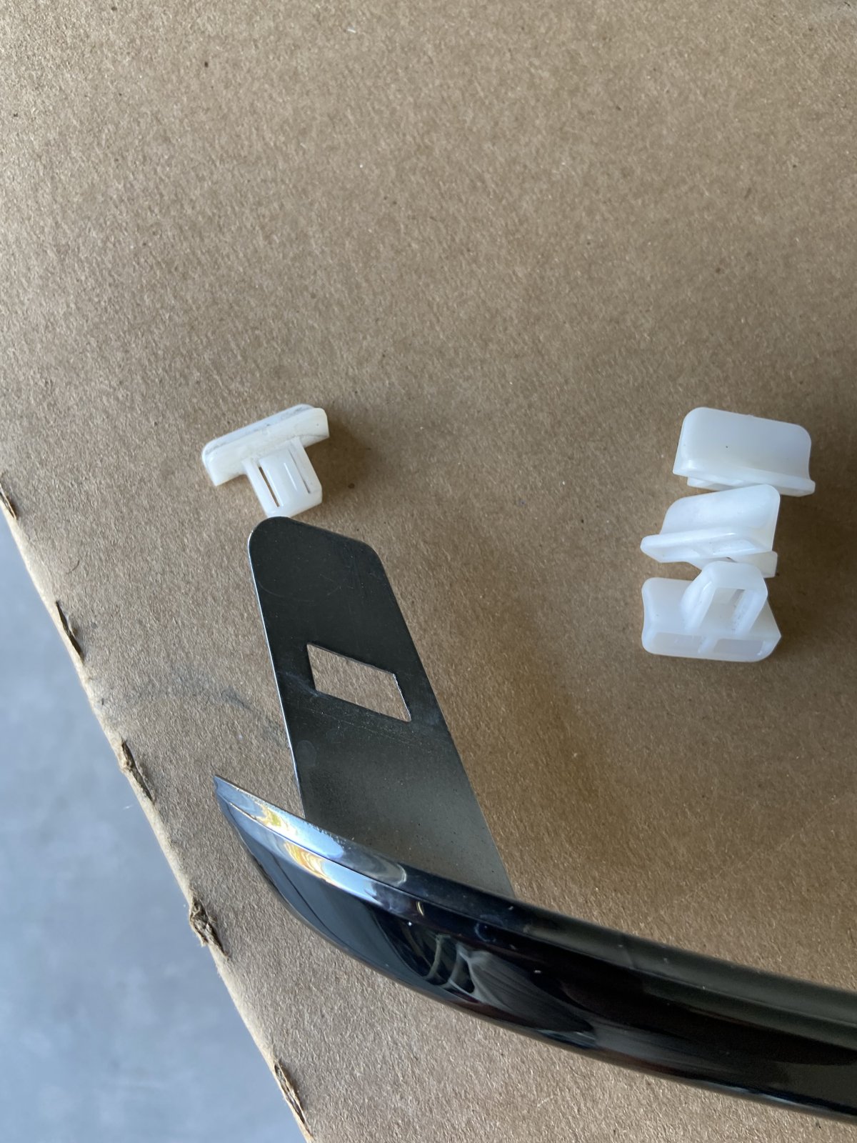

Installing GM Part # 84751055 rear bottom fascia for dual exhaust exit.
After removing tow hitch cover, remove the 2 metal retaining clips (underneath) that lock it in place and move to new fascia.

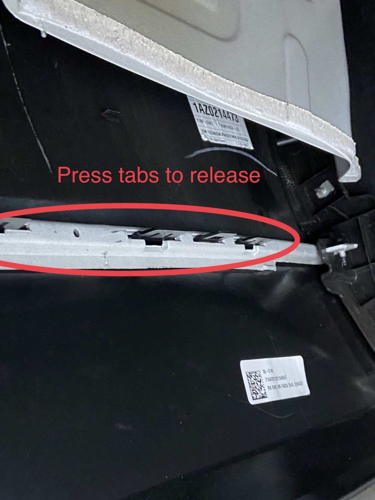

Remove black chrome/chrome trim piece. It’s held by 4 white clips that need to be depressed to release tabs.
1 on each end and these 2 middle tabs.

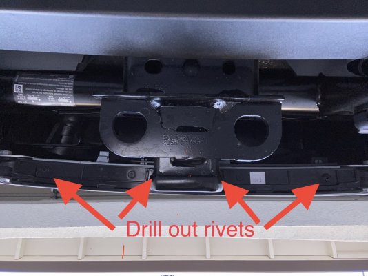

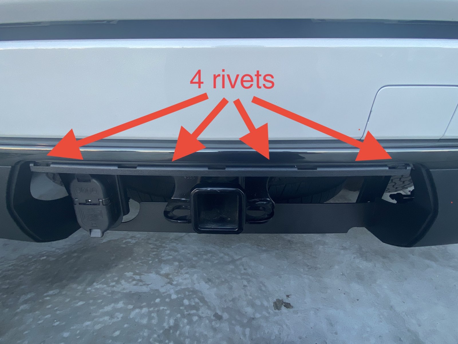

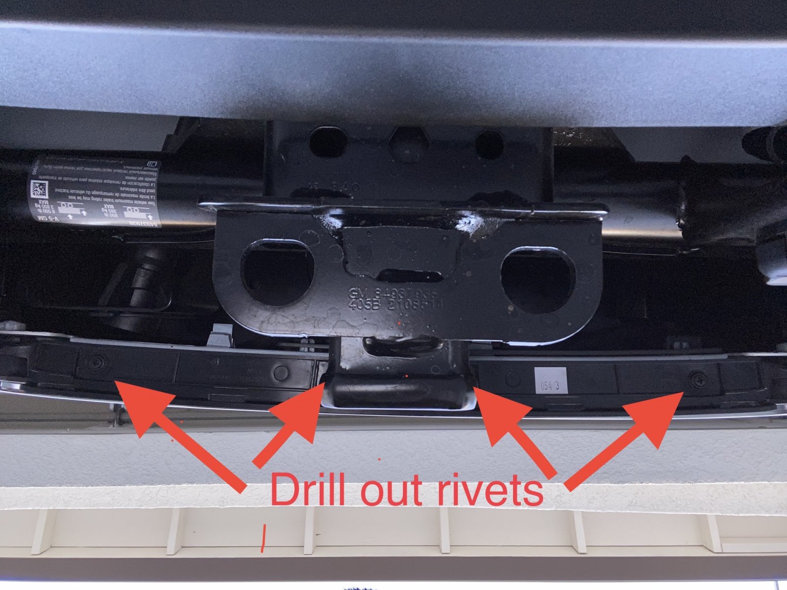

Once black chrome/chrome trim is removed there are 4 rivets that need to be removed. I drilled them out.

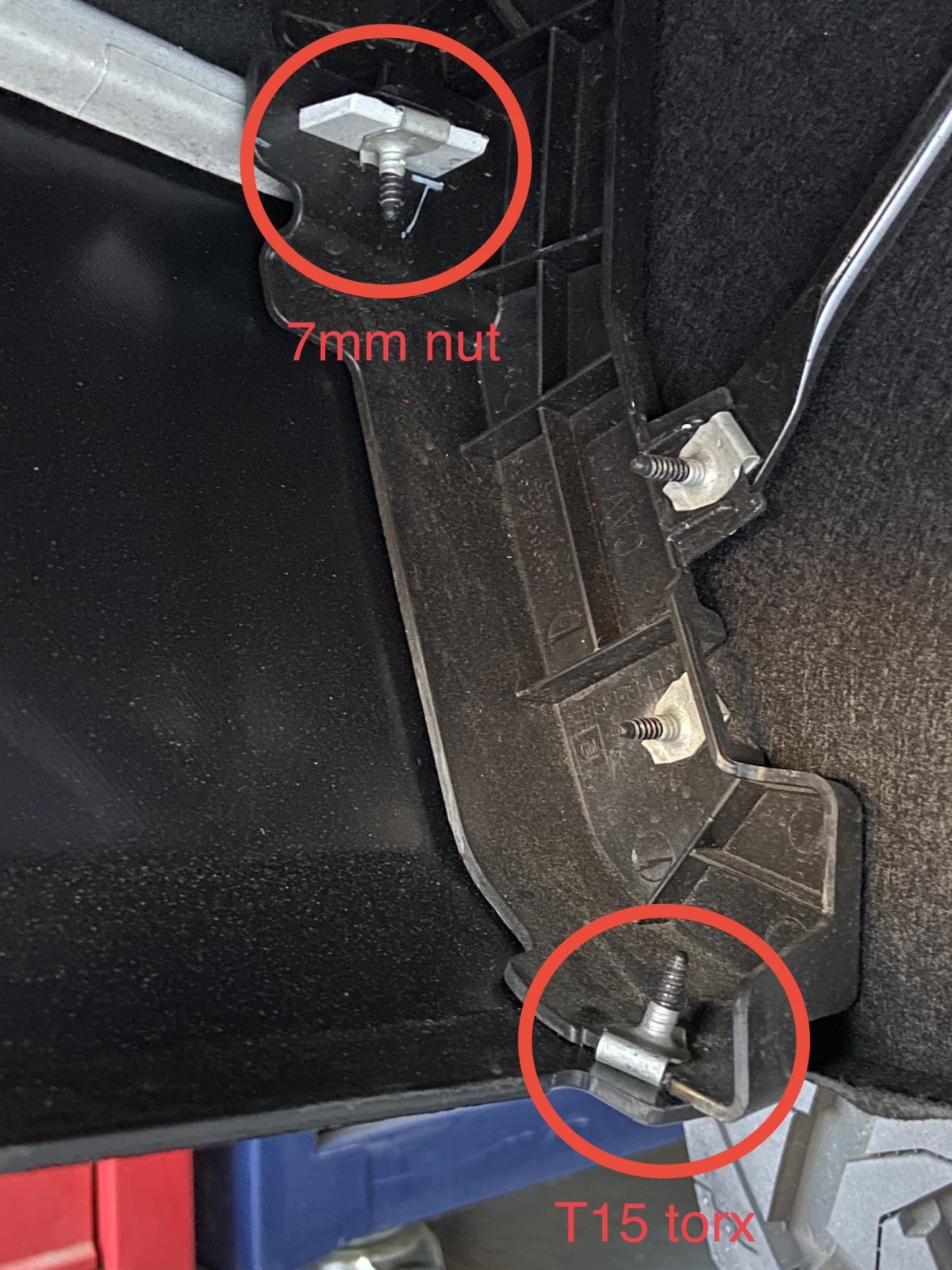

Remove all screws holding fascia in place
Drive side​
