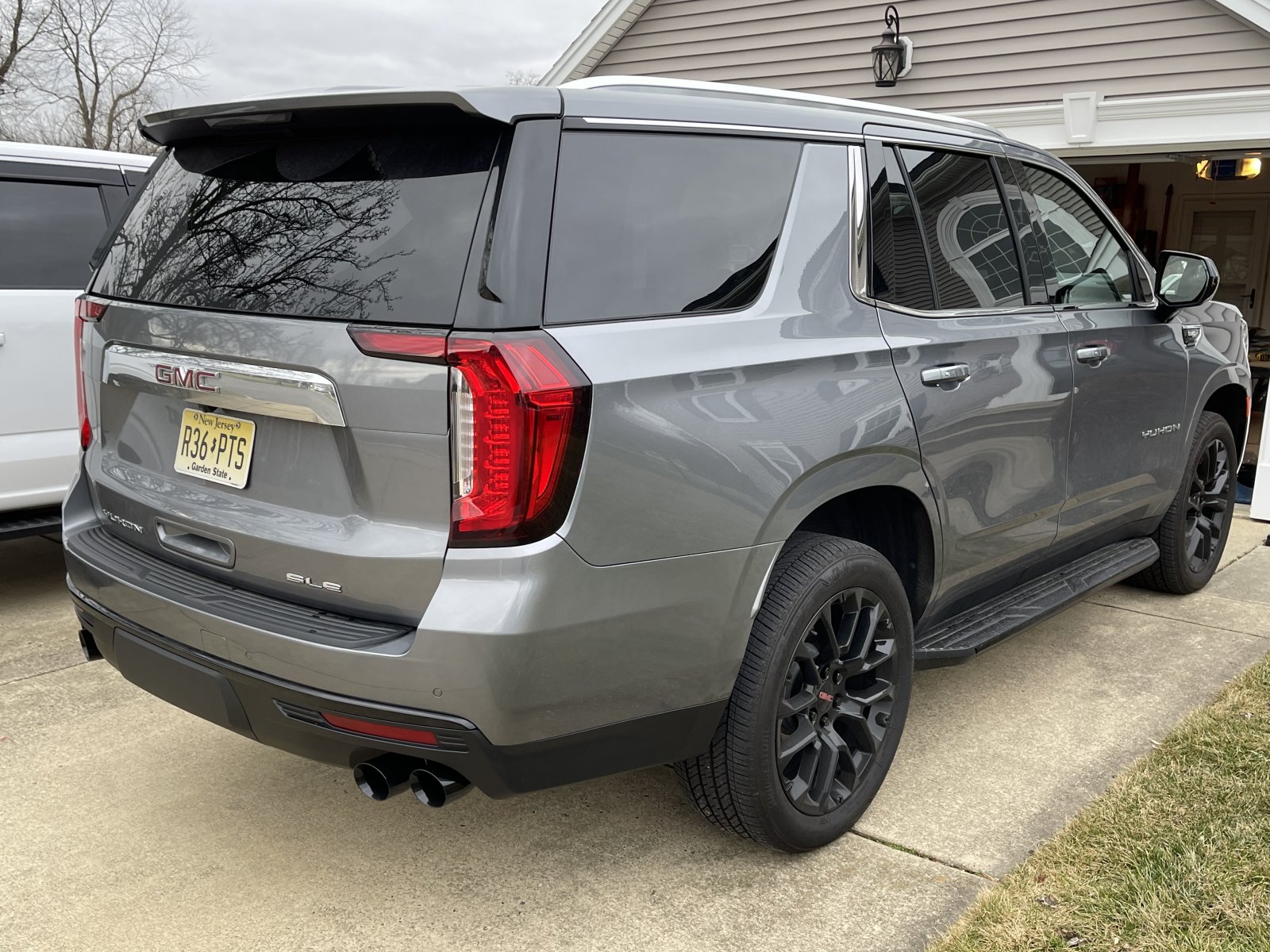

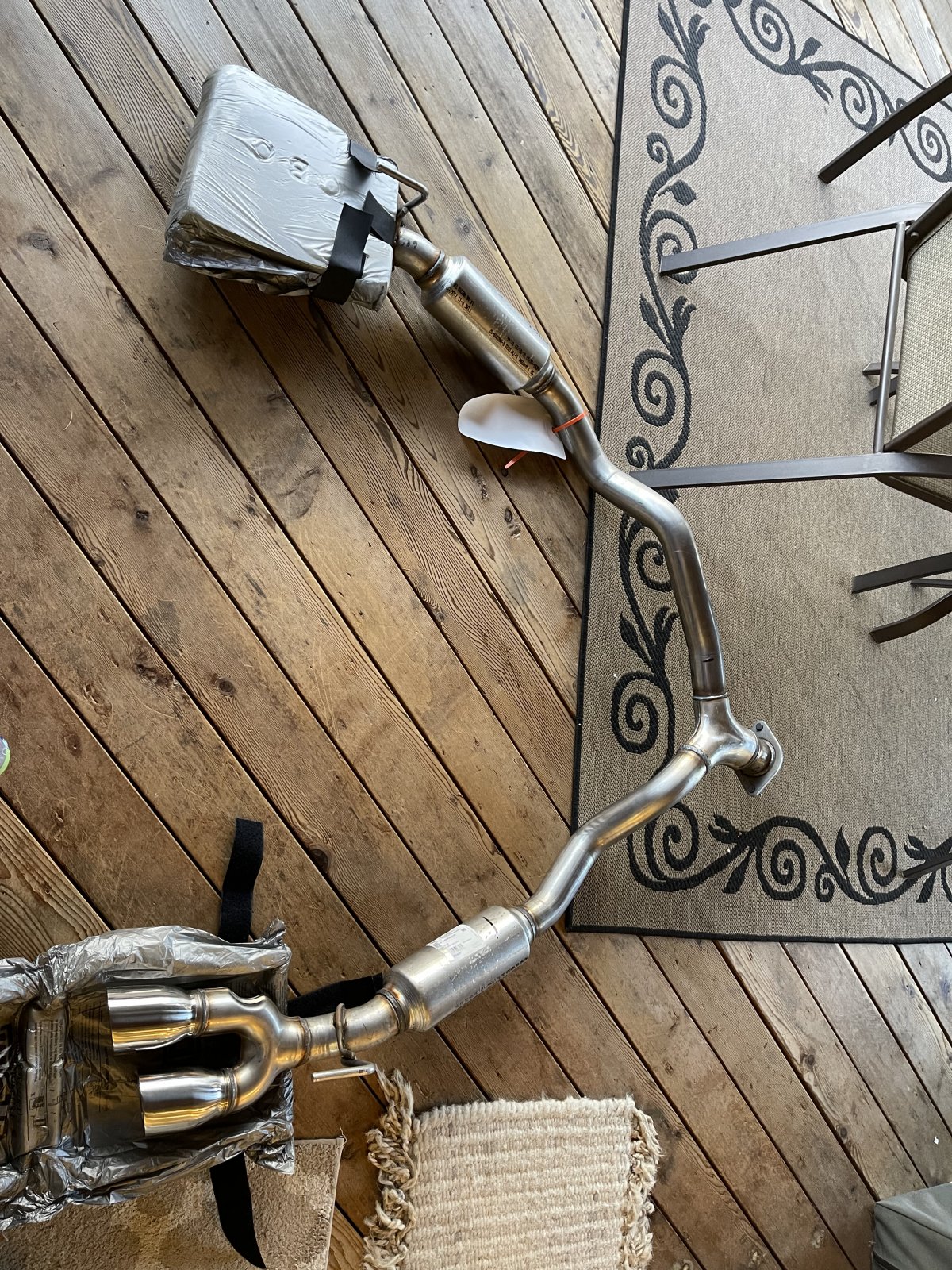

did it to my LT. only issue was to find the right muffle shop. Some crazy shop told me it could not be done that the high country had a different frame lol

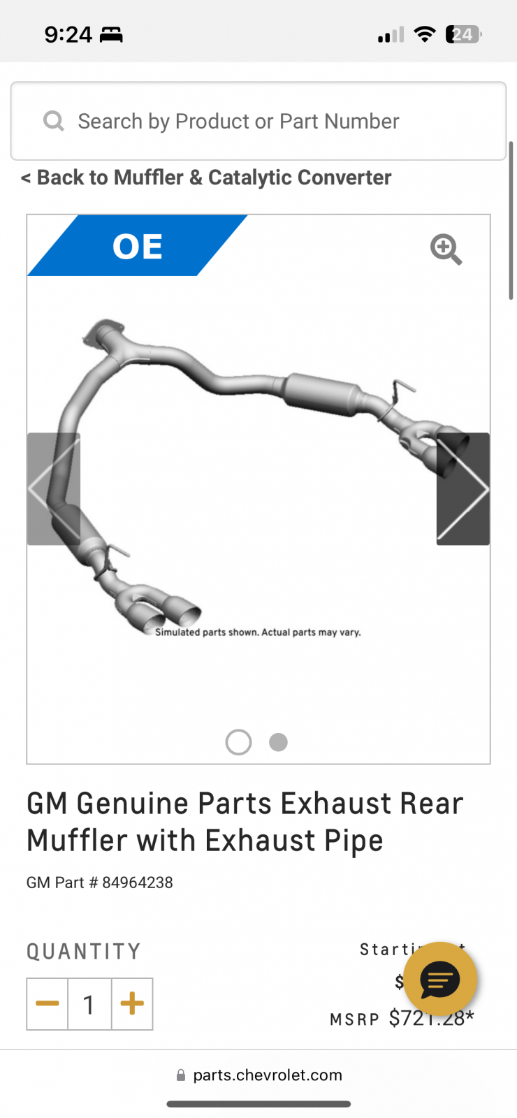

Is your new muffler OEM? If so what was the GM part # if not can you tell me what brand you went with? Thanks

Looking to do this to my 2022 YukonSLT soon, what exhaust set up did you go with?

Will part number 84751055 fit the Yukon also? If not can anyone find the part number for the denali piece? GM part channels only have their accessories at the moment.
Bzmuch102
Jan 10, 2022
Part #84751055 will fit Tahoe/Yukon if you have a suburban/Yukon XL you need part #84751057 I found this out the hard way had to order both parts cause I have a Yukon XL

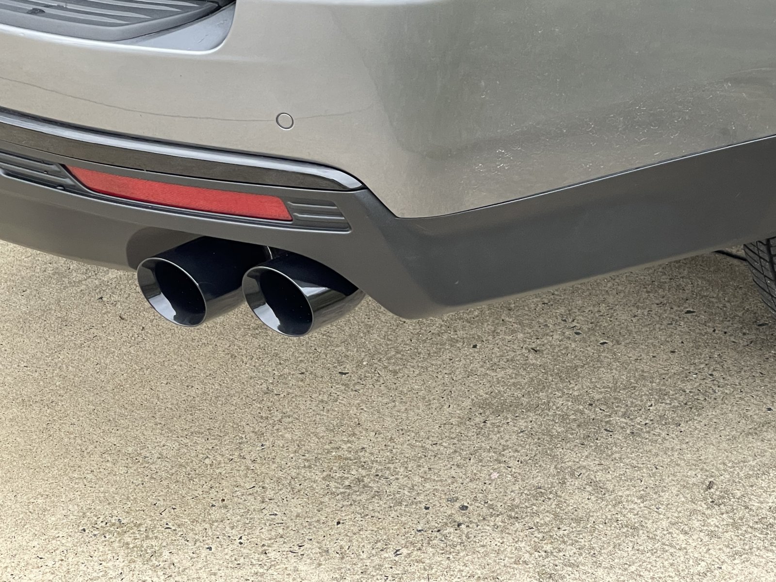

Installed 84751055 dual exhaust lower fascia for my RST. Now I need to figure out what exhaust I wanna install.
