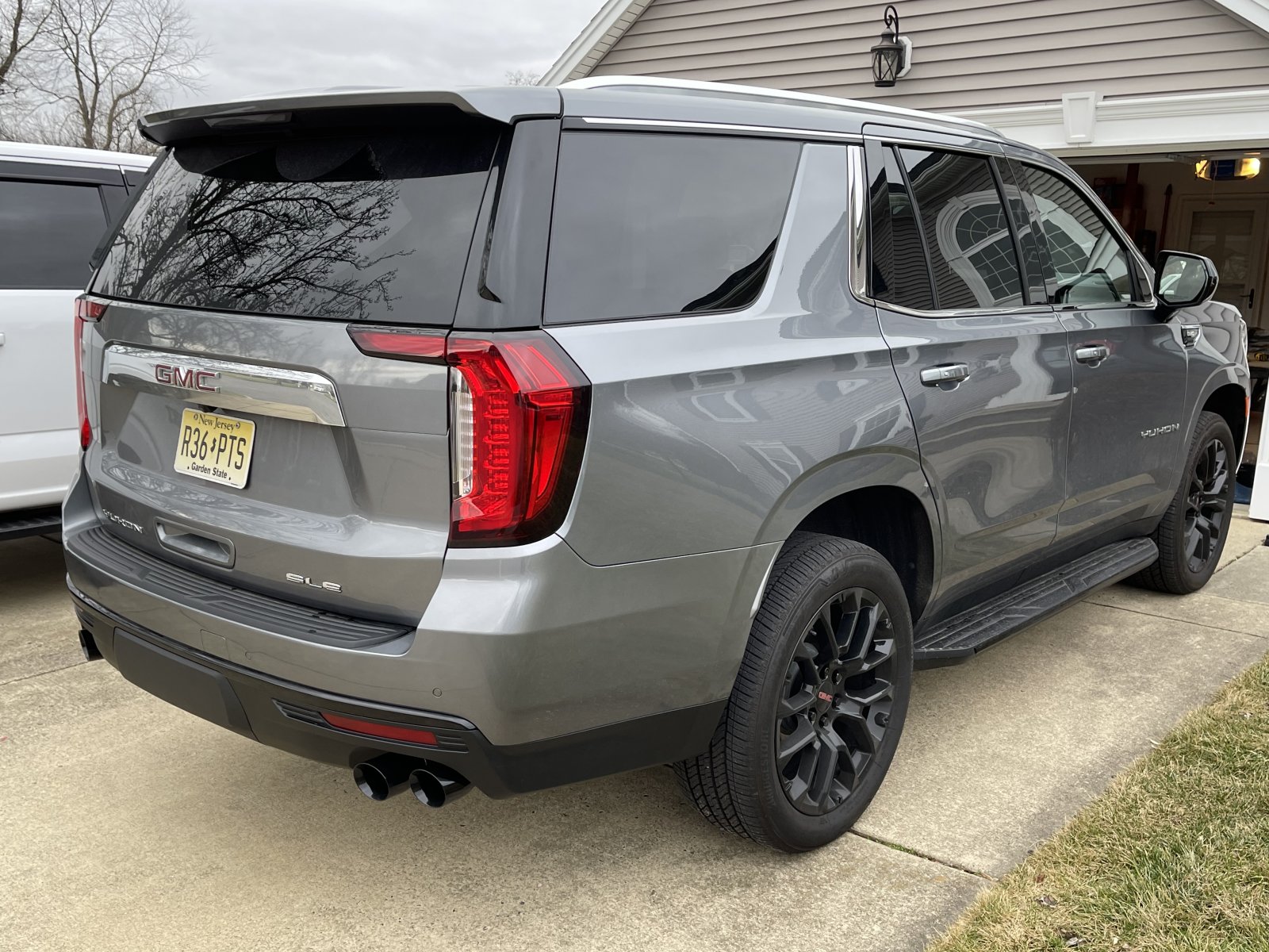

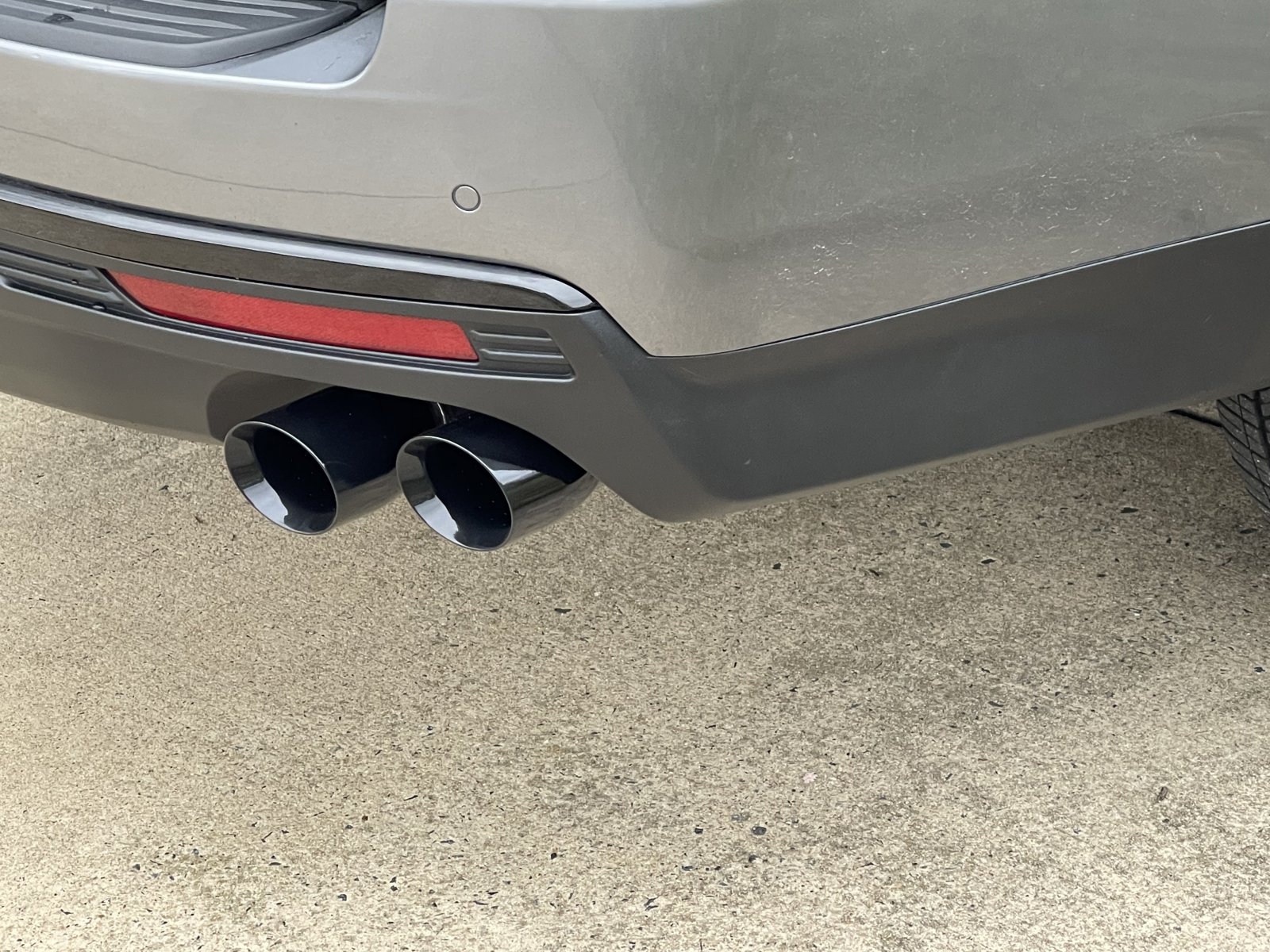

Thanks to the member who posted the original instructions! My install went well and completed in about 1/2 a day in the driveway. I went with all factory parts (list below) and painted the tips black with some high temp paint!

Very nice ,I Too just want to use the stock muffler, can you post some pictures of the exhaust hangers that you used , also how much did you spend on parts

Thanks! I dont have any good pictures of the hangers. They are very straight forward to install one retainer clip and bolt per side. They also have an alignment pin built in. Total cost was right around $1000 but that was with some rewards points and a 10% discount. Below is a pic of the parts at list price.

Looks like 20% off, no?
Anyway, it looks good! Just like it should have come! Bet it sounds better too !

Very happy with the sound! It’s not like an aftermarket exhaust but a definite improvement over the old stock setup. It’s just enough.
As for the price yes it worked out to almost 20% as I had $100+ in GMC rewards points. Check the App you may have more than you think.
