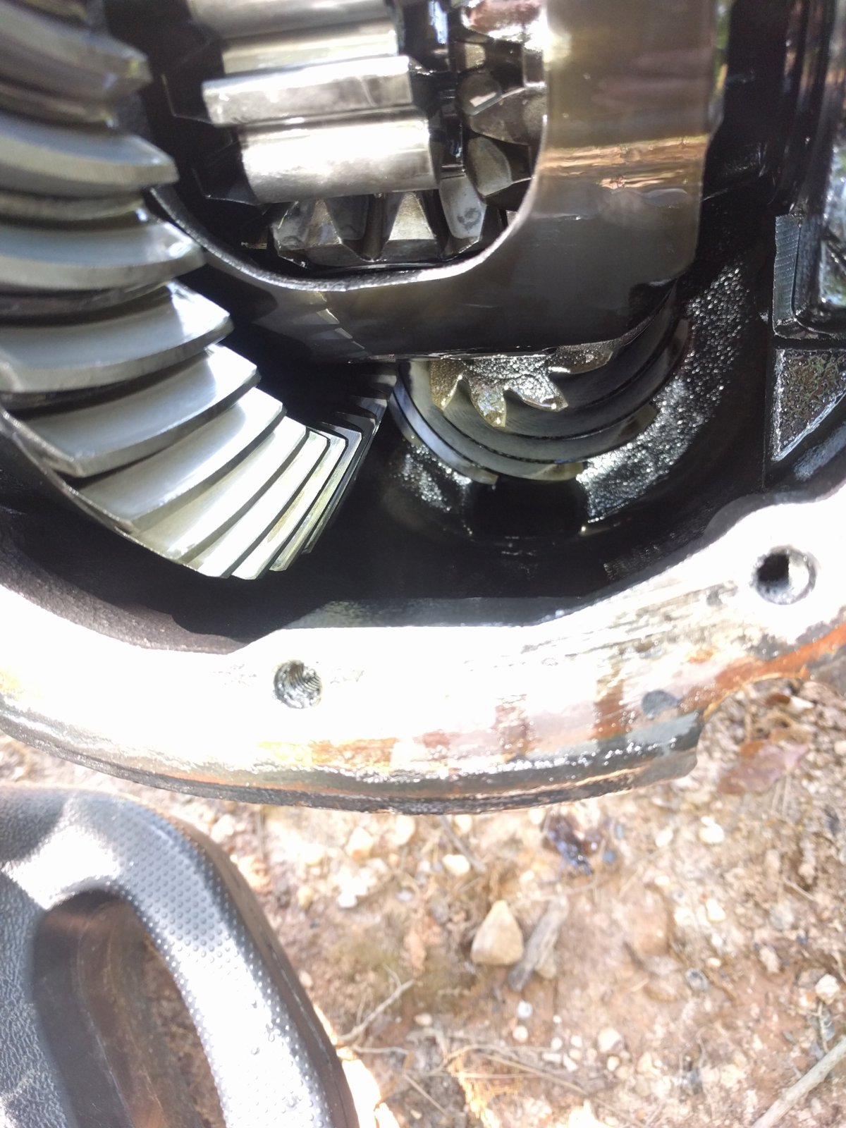

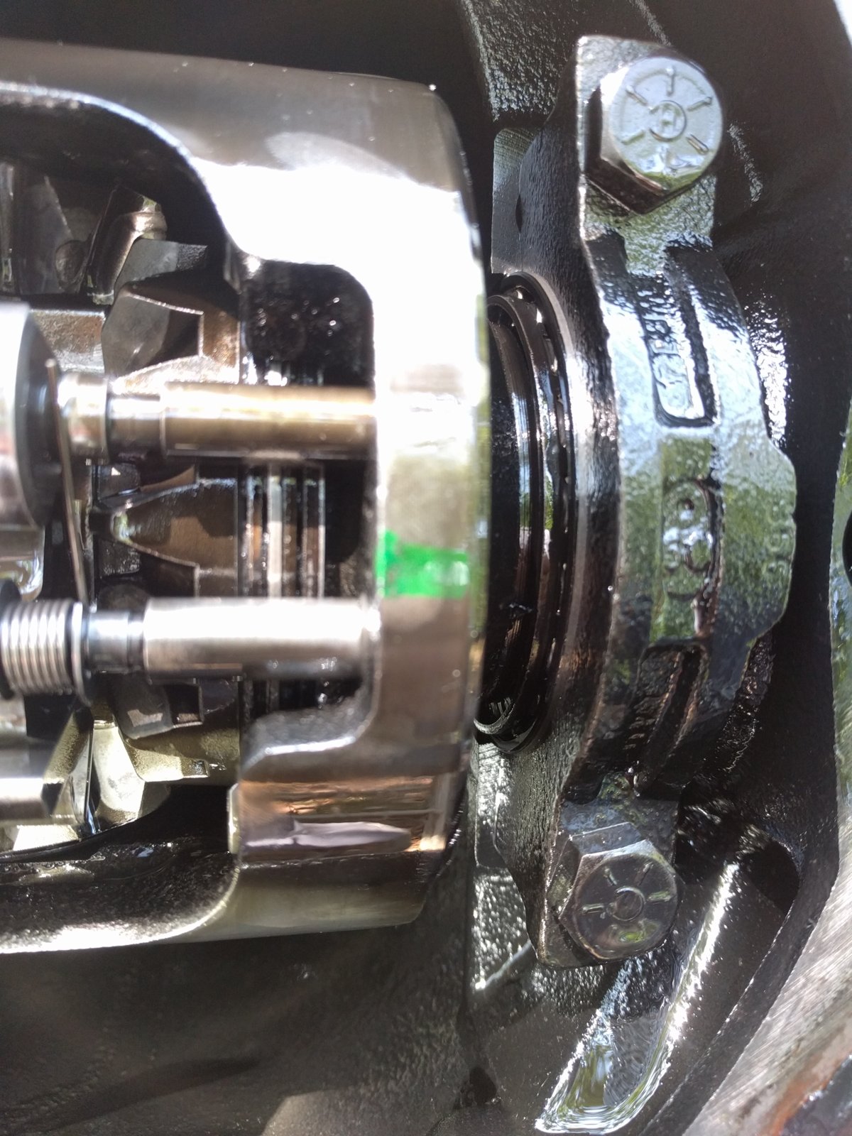

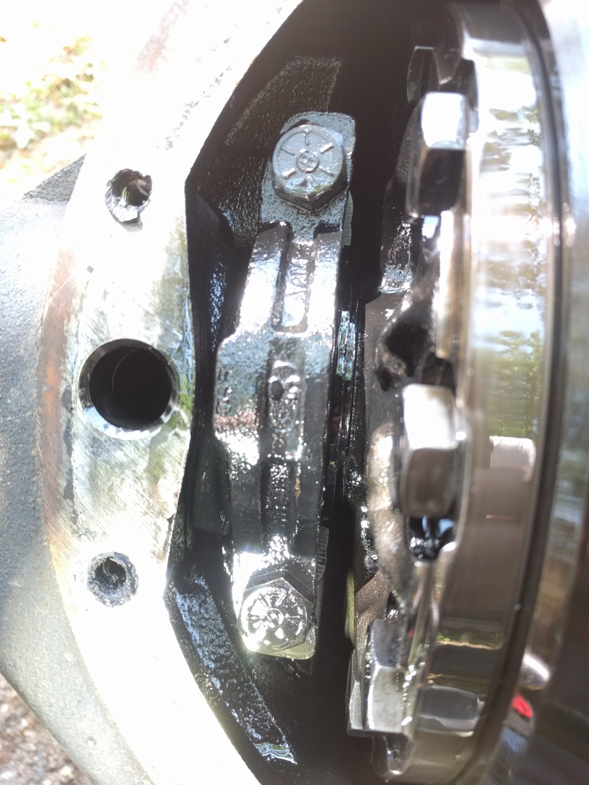

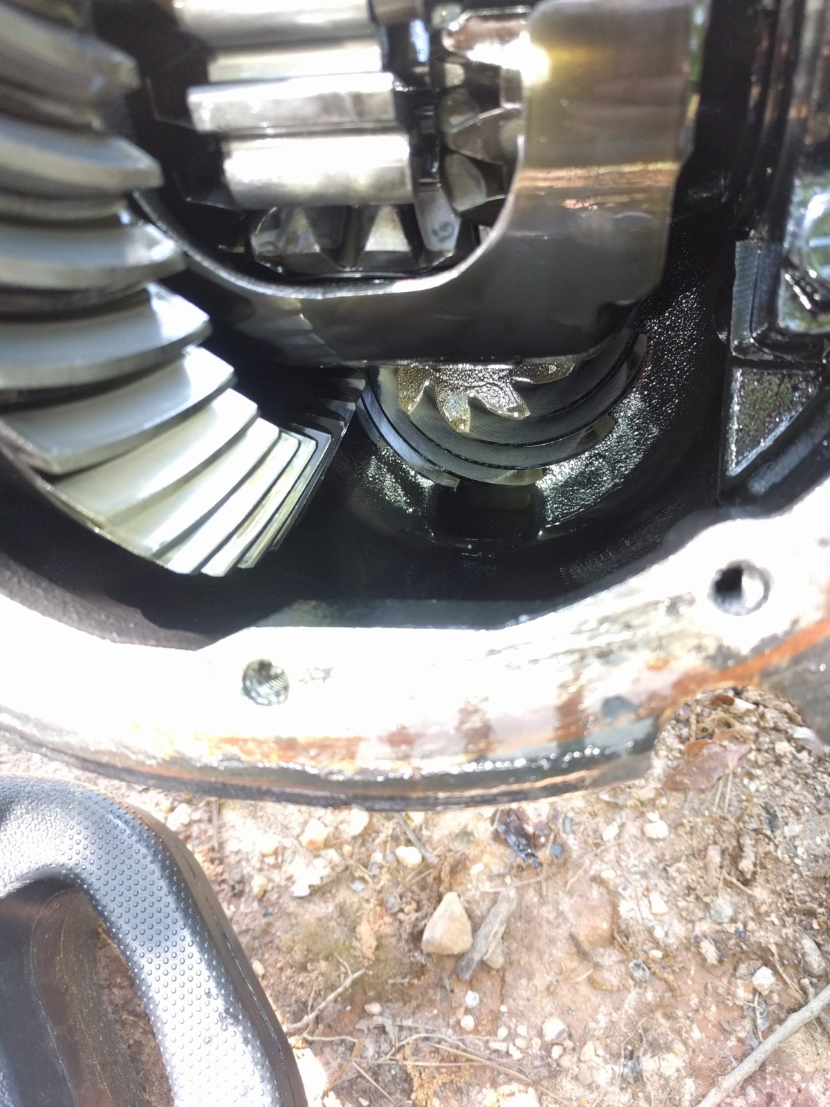

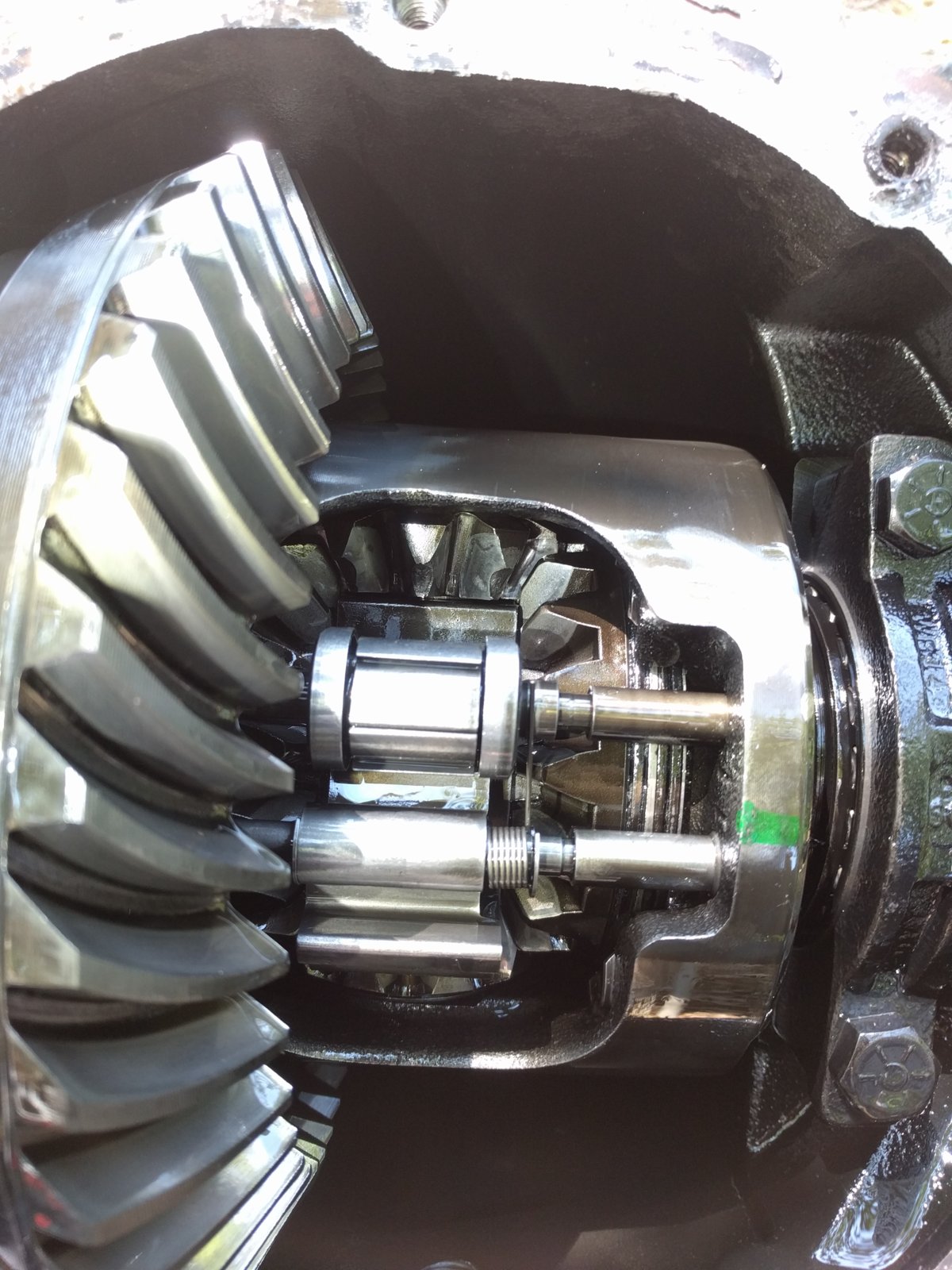

It sounded like mine did. My pinion bearing was shot. Leaking out the front of the rear diff. With the drive shaft removed, did you try grabbing the yoke and try shaking it about? Mine was clunking. When driving it would sound like it’s grinding but if I let off the gas, the noise would change and come back again when I hit the gas. When you changed your fluid, how did the magnet look? Was it ***** with a bunch of shavings on the magnet? It’s possibe you have a pinion bearing that’s on its way out.
I was going to rebuild mine and do it myself. I decided not to because I don’t have the proper tools for setting the diff up and figured it would be less involved just buy swapping the entire rear End. I found the entire rear end for my truck at a local boneyard of a 73k or so avalanche for $675.

No it's constant regardless of speed it's just faster as I go faster, and only in drive no sound in reverse? So I'm not 100% till the cover comes off what it is
