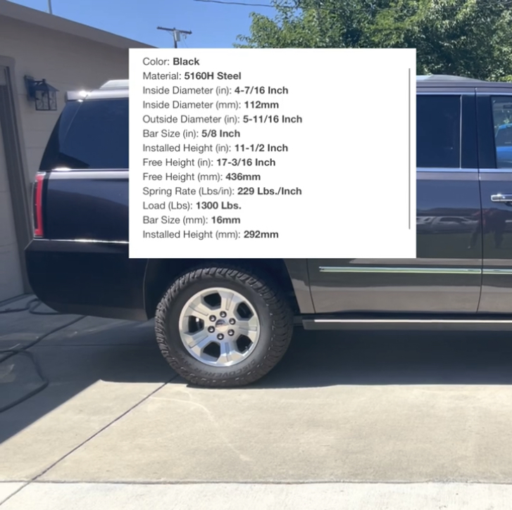

Then a birdie told me about some springs o'reillys sells made by performance spring.
They sell two versions. It looks like a tahoe and a suburban version. ill post pics in the next post. I need to find them. It has the specs
