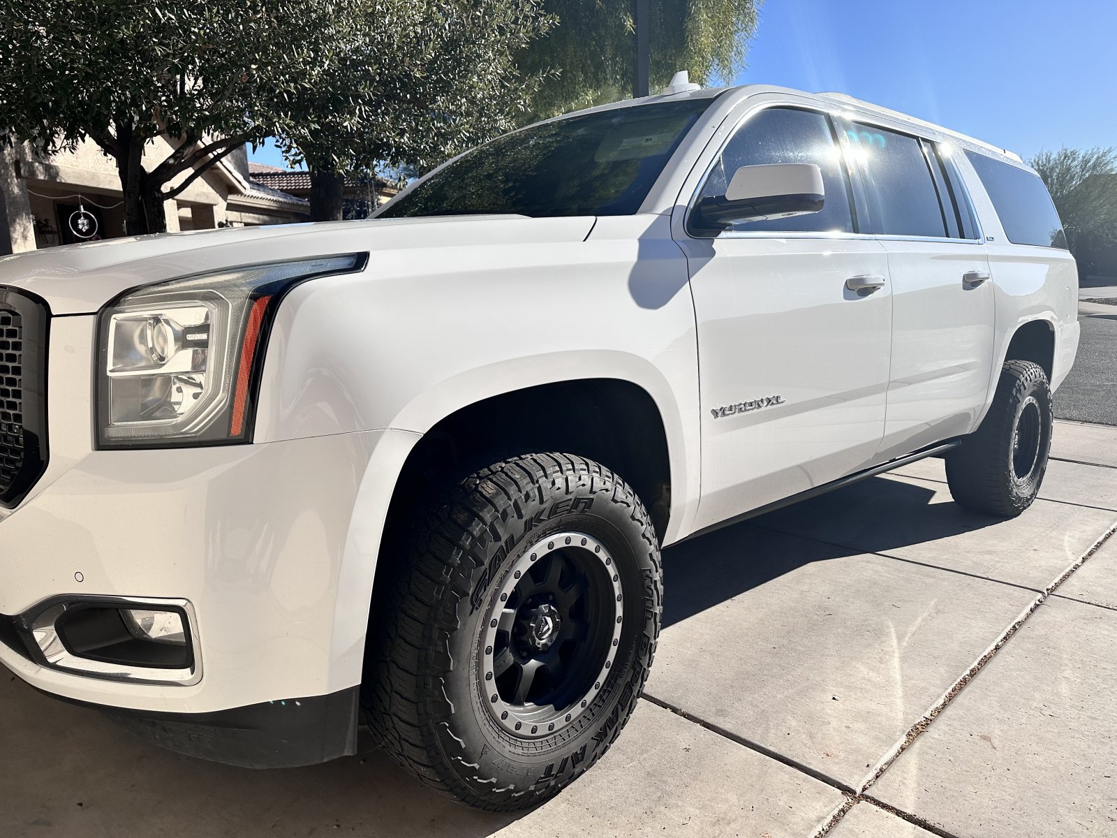

I used these, Dayton springs 351-897HD with Bilstein 5100 shocks 24-253260 and a one inch block I. The rear. The front has a 2” leveling spacer with 5100s as well with it adjusted up two notches. The ride is so much better then the factory air leveling system.
22ECO
Nov 20, 2017
11
Sorry I didn’t realize I forgot the pic. 8C2E0607-ED0A-491A-9887-586DBDEFD198.jpeg
