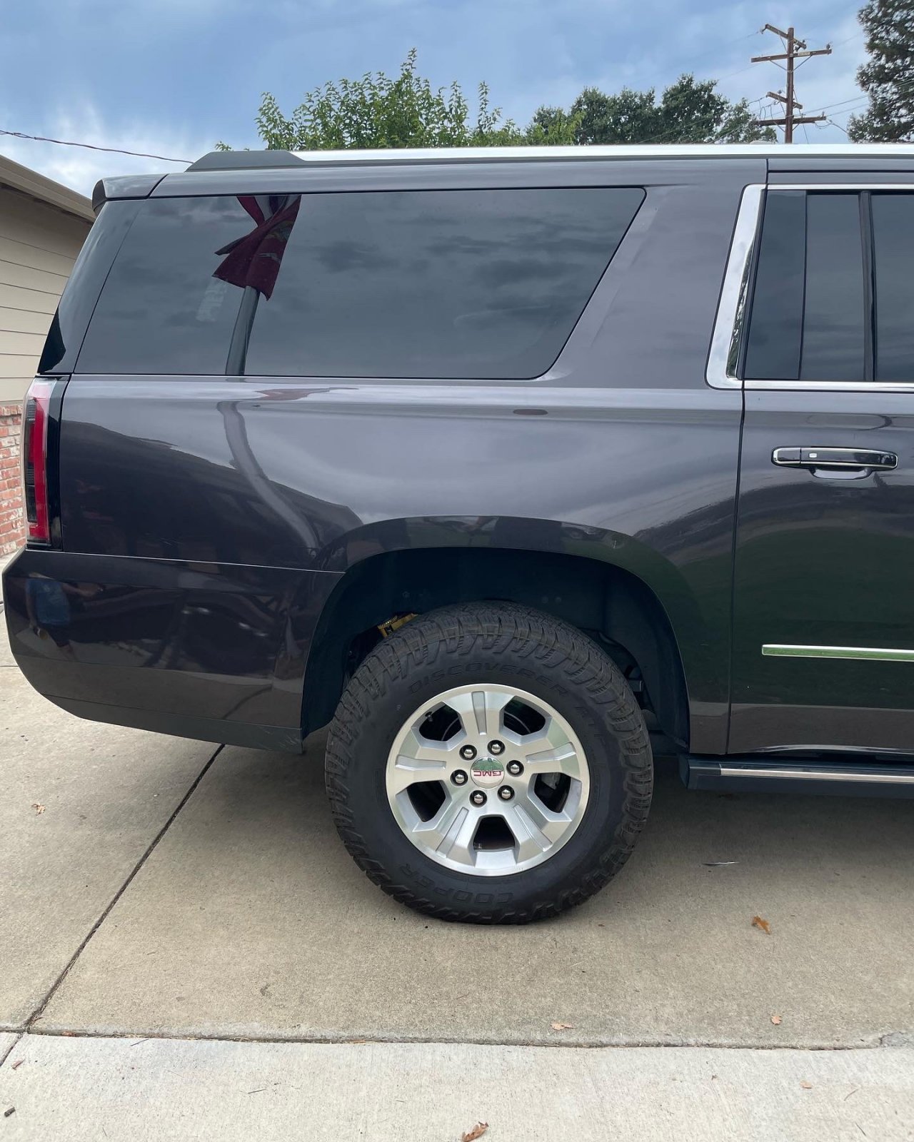

I'm just getting started looking into lift ideas for my 2016 Tahoe but it seems there are only spacers available to lift the rear of the tahoe in the 2-3" range? Does no one make aftermarket springs that lift the rear 2-3"? I plan to 4-wheel my Tahoe a little bit getting to some dispersed camping areas and I like the idea of having better articulation/wheel travel in the rear suspension but if spacers are the only choice then I guess that's what I will use

Yes.
I have the z71 suburban border patrol springs.
I’m trying to remember how much lift over a Denali xl spring. Iwant to say it’s in a post
Running 10” shocks, started with multimatics and now running ADS Racing.

I think I listed 2 springs. One is for the Tahoe/Yukon and one is for the suburban/XL.
The difference is the spring rate. All external lengths are identical. But the stiffer spring rate (suburban/XL) will give the taller stance and more load capacity.
Not a lot, just a bit, because it’s simply to make up for the weight increase of the longer vehicle.
Again, I’m running the suburban springs on my XL.
