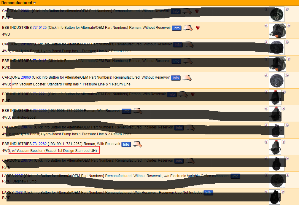

Next I want to order a new power steering pump... might as well, I have 250,000 miles but I see there are multiple different pumps. Not sure if I have; hydroboost?

@Fless Pictures of master cylinder... Is that a hyrdroboost? Curious is it something would be good to upgrade to if not?
Super Moderator
13,329
27,139
Elev 5,280
That's not hydroboost, it's a vacuum booster. There are some Youtubes on converting to Hydroboost, and doing that would take a different power steering pump along with the other hydroboost parts.
