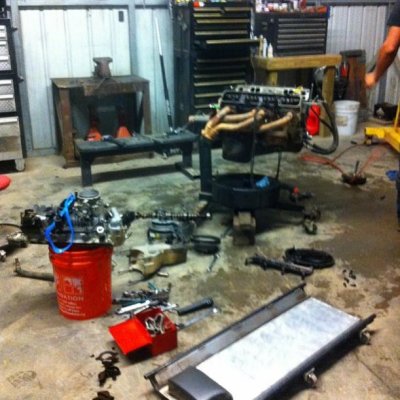

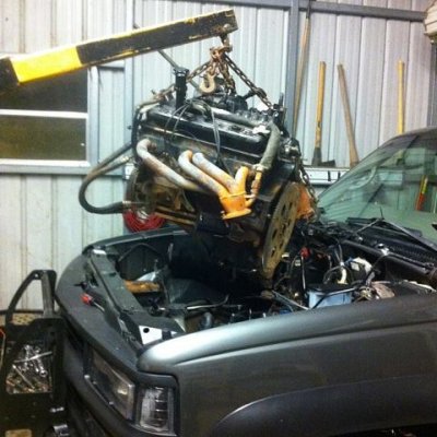

Well pulled the cam, intake, rocker arms off so far. I can see the cam bearing are worn the crap out.. So ill tear it down and see what else is wrong. I should be able to reuse the pistons.
So i need a suggestion on a rebuild kit, and what about the ''ram jet'' rv cam? Or any suggestion a better cam to use with stock tune. Thanks..
And yea we got the motor out fast, drove it in, and in 2 hours had it on the stand, oil still warm. And them got everything off the motor in like 15 mins.. to bad putting it back together wont be as easy/fast.

WOW, got the motor out in 2 hours?!! That's pretty darn FAAAAST.
Just noticed that head kit in the link above comes with 2.02 intake and 1.60 exhaust valves, I thought stock Vortec heads had 1.94/1.60 valves. Looking at some machine work on that.....something to look into.
I'd go with new long block but I understand that money's tight.
Good luck with your tear down and keep us posted.
