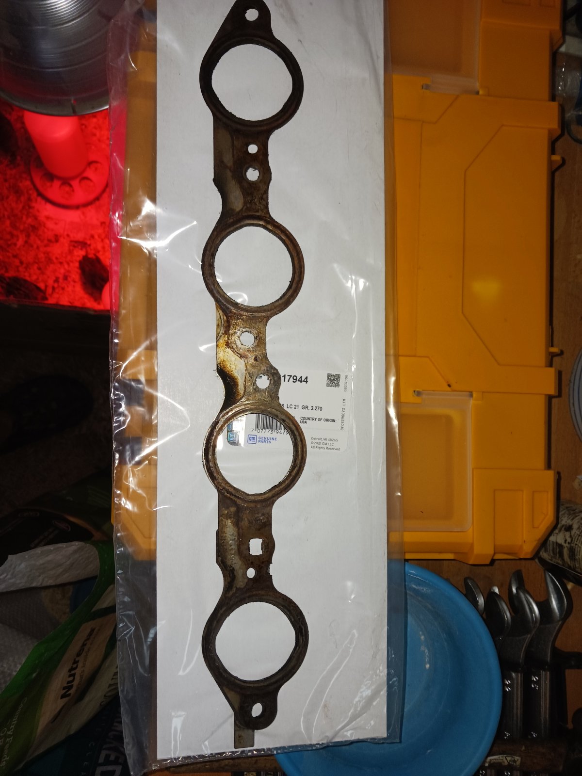

I have a question then.
If manifold is held in place by simple bolts, do I really need to disconnect it from the exhaust pipe to replace only gasket? Won't it move away from the block enough to simply remove the old gasket and slide the new one in?
donjetman
Oct 22, 2018
1,615
2,872
:waytogo:go far it, but it may fight you getting it to line back up? Let us know please.
j91z28d1
Feb 28, 2022
3,311
4,121
these are copper and I'd use oem 3 layer but notice the end bolt holes are slotted. if you can do that to the gaskets you have, you should be able to pry the manifold out a bit slip them down in.
as for getting the old ones out, leave one of the front or rear in, should be able to pull up the gasket, and then put say the front in, remove the back and pull it the rest of the way out.
I've not done this on one of these trucks, only an older small block chevy motor with more flexible headers. but might be worth a try.

Have AC Delco gasket ordered. Next Saturday will be the D day. Will report back
