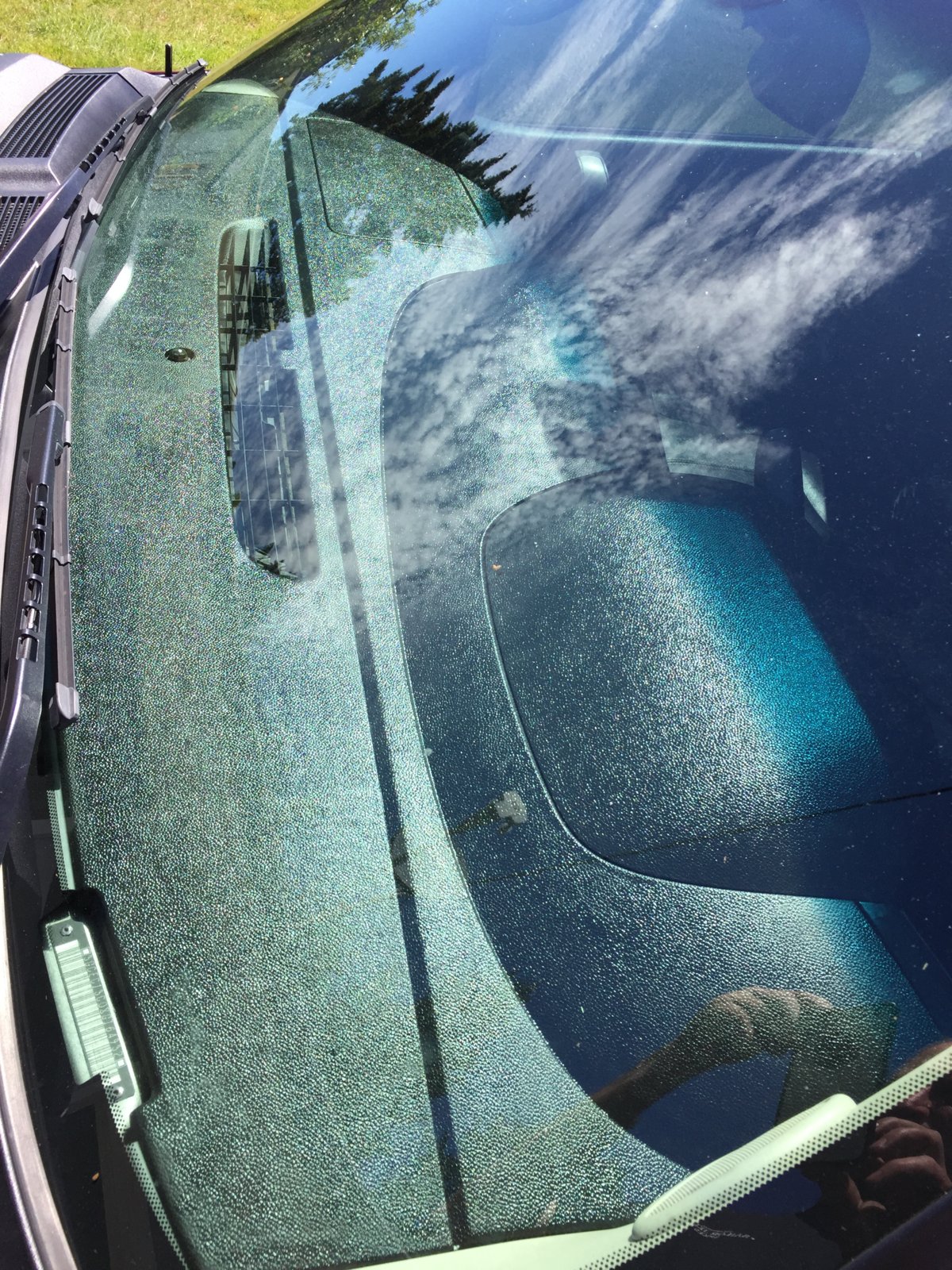

Whole thread on here for dash replacement and people are adding what year and where they broke and what state. I remember reading someone with a ‘13 just broke.... its sun/uv beating down into truck...depending on where you live. More south no garage/tint = broken dash no matter what year.

my 2012 is cracked by the center speaker, it probably cracked from the weight of the speaker
that's really disappointing to hear...when I had mine replaced back in 2014, the dealership told me MY2012+ had a new dash with different materials and structure to stop it from happening :(

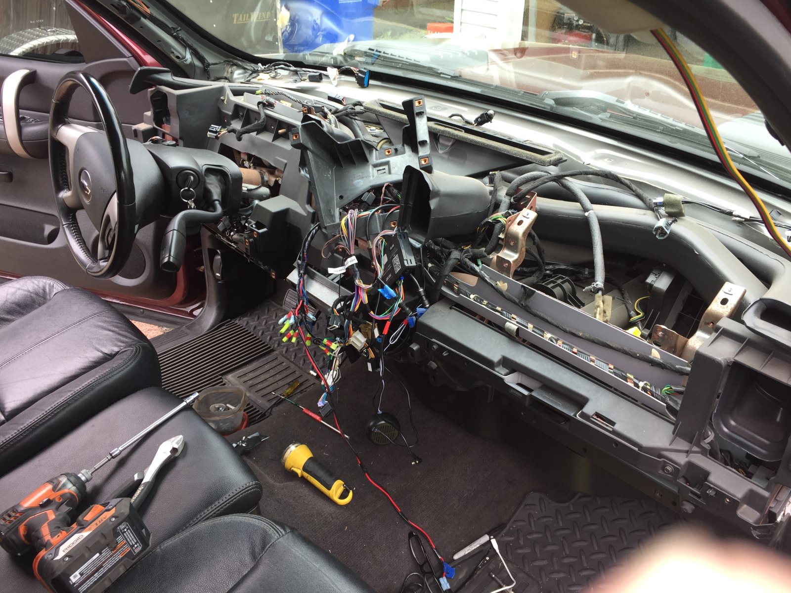

It is a PIA and way too expensive to fix this though...just finished mine the other day on my CC. Anybody that's interested in my trials and tribulations with my dash, there's about 10 pages devoted to it in my CC build thread here:http://www.tahoeyukonforum.com/thre...ilverado-build-aka-the-machine.100281/page-74. I first pulled it and attempted the repair with a plastic hot-melt staple gun and steel/ epoxy reinforcements but the plastic was so brittle that as soon as I put it back in, it broke again. Plus it never looked that great after the repair. Now it's done right.
