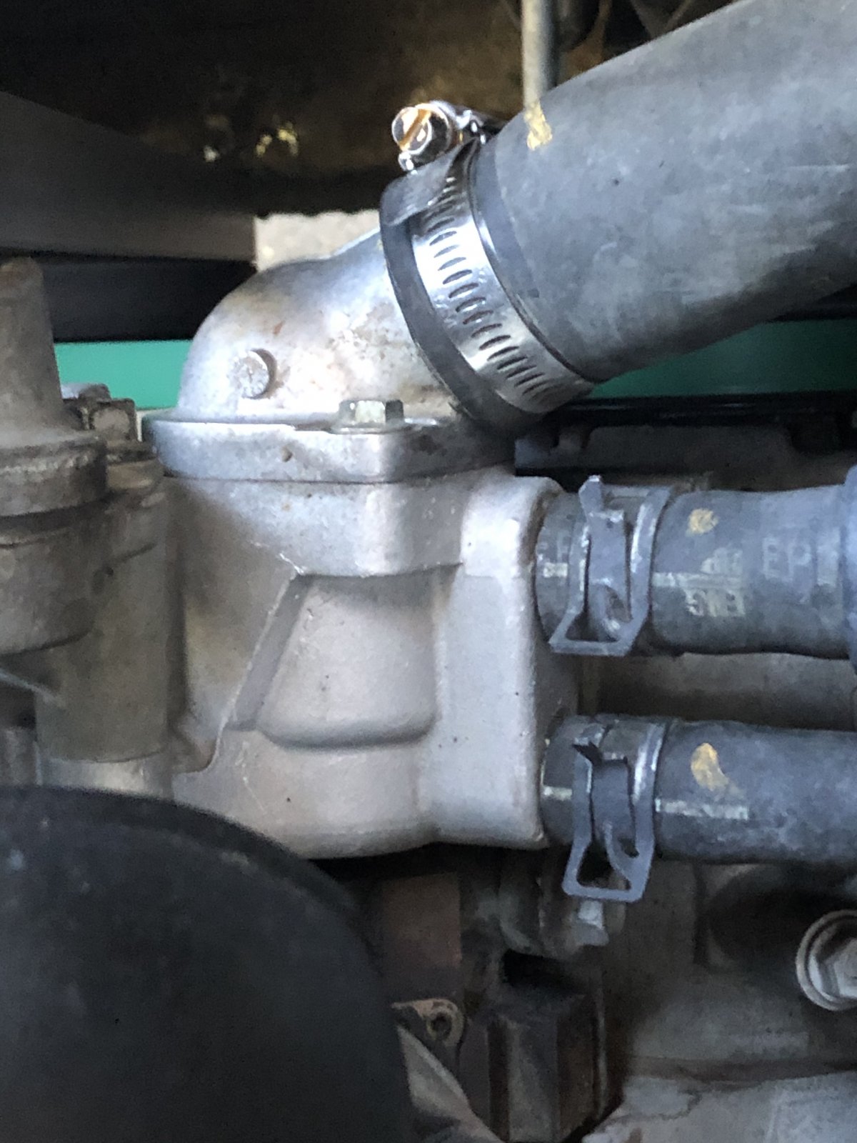

About half way into detailing her Porsche I notice a big puddle of coolant under the front passenger side of the truck near the water pump.... I’m like seriously?!?! It had better not be the damn water pump. It’s already been replaced TWICE! Ugh..... so I finish up and clean up the spot on Bruce’s freshly paved driveway. Lol.
I roll towards home, stop into the Carquest and grab a couple gallons of coolant. And then head home. I’m watching several YouTube videos thinking my water pump might be bad. I take the intake off and the upper tensioner pulley and the serpentine belt just above the water pump. Thankfully because I have electric fans I didn’t have to mess with any of the fan stuff because they’re not in the way. I’m staring at the thermostat housing, and it’s got ever so slightly a gap in between the housing and the water pump and it’s soaked in coolant. Coolant had run down the water pump but was not coming from that or any of the other coolant hoses. So I’m like alright that’s an easy deal. When the shop replaced my water pump last January, “due to bad pum gaskets” according to the shop..... he replaced the thermostat and housing. So it’s only a year and a half old. I called him up and he’s like “ I wouldn’t do the whole thermostat and housing is see if you can get the O-ring for it, and just replace that. and he talked me through how to replace it. NAPA had it in stock and my mom gave me a ride over to pick it up. It was like 4 dollars and change.... lol
Pulled the lower radiator hose off, let it dump coolant out, and then unbolted the T-Stat housing and pulled out the T-Stat. Sure enough the O-ring was flat as a pancake....after only a year and a half
Holy crap!! T-Stat and housing cleaned , new gasket on and bolted it back up to the water pump. While I was in the process of putting everything back together I decided since my air filter was already off the truck to go ahead and clean it up and re oil it. Especially since I’m leaving tomorrow to drive to Laughlin I figured it couldn’t hurt. Buttoned everything back and filled up with coolant. Let him run til got up to temp, which always takes FOREVER, when coolant is fresh with the right amount... lol. And then put the cap back on the surge tank. Pressure washed all the coolant out of the pulleys and the underside. So far now that t-stat housing is dry as a bone and no gap whatsoever between the housing and the water pump. Drove to the gym and back for evening HIIT class and so far so good. Will be keeping a close eye on the truck during the drive tomorrow to make sure.
