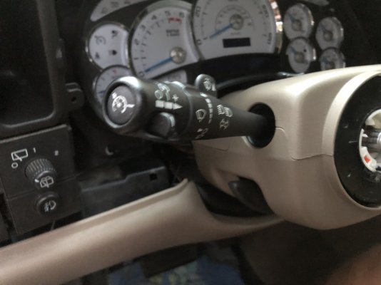

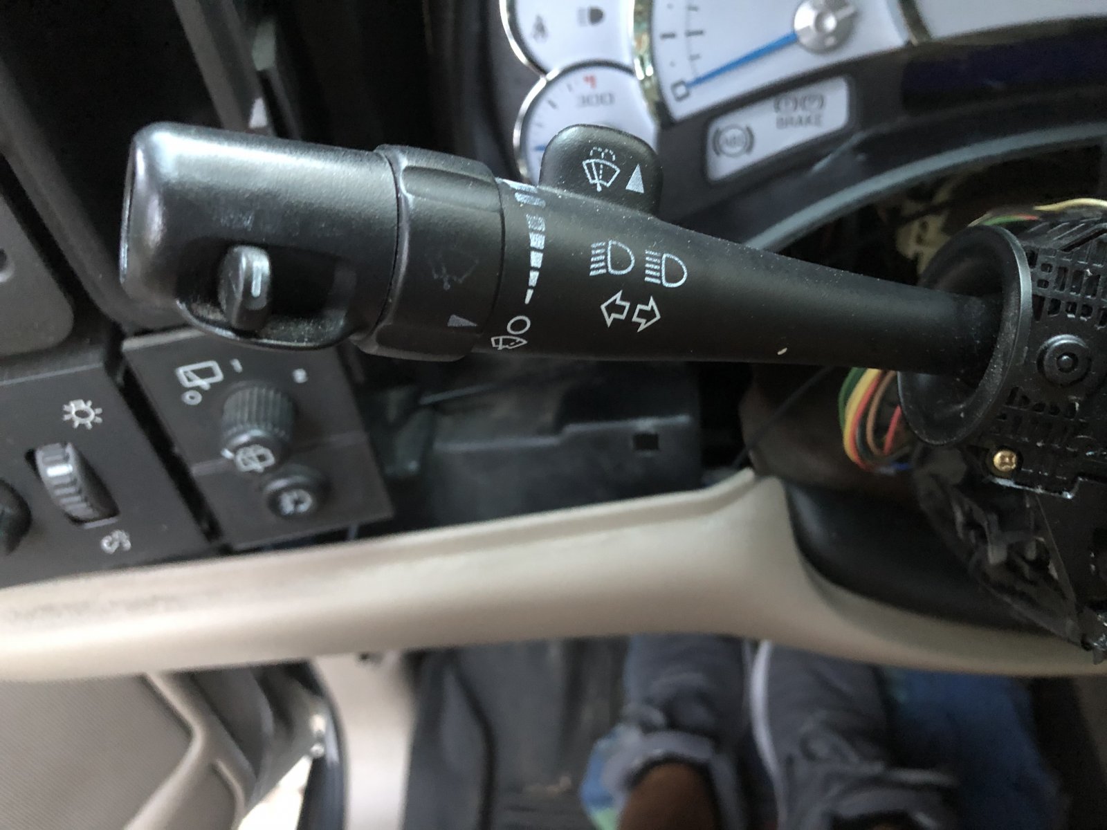

My passenger side turn signal has been doing this funky thing, AFTER my HID install, which is odd, where when the auto lights are engaged it stays partially illuminated. And I ensured there’s no crossing of ANY wires anywhere. I was very careful. Except it’s only the green arrow in my cluster and the red LED in my passenger mirror glass. And then when I engage the turn signal it hyper flashes like there’s a bulb out. It’s really irritating. The only two bulbs that could be bad are the two front turn signals and those are both new. My rear turns are LEDs in the tail light housing that do have laps resistors properly wired in. After bulbs I replaced the flasher relay just below the steering column hoping that would solve it. Nope. That didn’t work. A few weeks back I pulled a multifunction switch from a 2004 Denali thinking it might solve the issue of mine was going bad. I finally got around to swapping it out this evening after gym class. Original is getting pretty worn:
The replacement looks surprisingly good.
But unfortunately it didn’t solve the problem. And the switch is fully functional. Everything works as it should. Engages both turns, hazards work, cruise and wipers all work with the replacement switch. Anybody got any ideas as to why my tie single might be doing this?!?! Help!! Also I’m keeping the replacement switch cuz it looks so much better than mine.... lol

My S10 did this after a cheap LED turn signal bulb swap. I've also heard of poor grounds causing the power to backfeed.
