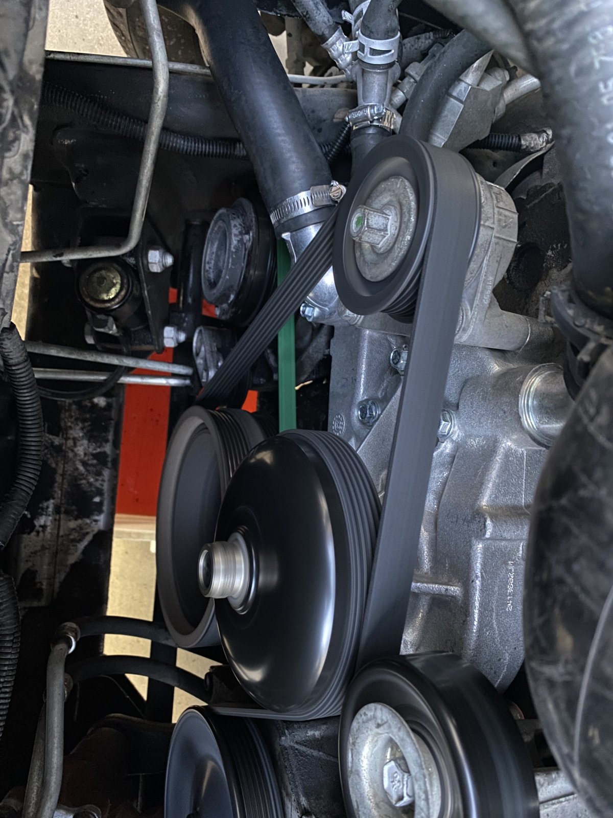

After a short break to have some cookies it’s back to work I go to get front brake pads replaced. Guess the metal piece on the brake pad that just fell off the second it came off the caliper bracket would definitely be making noise….. oops

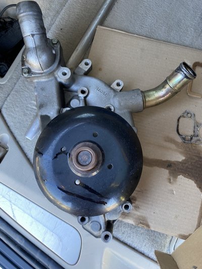

Welp….. fired the parts cannon too soon and shot myself in the foot with it…. :banghead:
Apparently my water pump, which is only a handful of years old and probably no more than 60-ishk on it maybe? I don’t know I’m tired of replacing stuff lol. But got a new water pump in today…. Leaky Mtrucker….. lol
