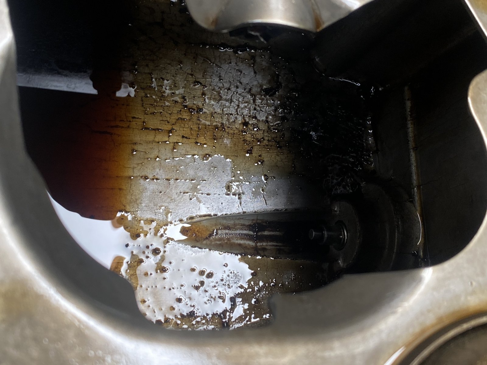

So when I finally managed to get the oil pan out, after fighting the diff and it not coming of the truck despite being completely unbolted from the truck, I got my first look at the inside of the oil pan. Not a single flake of metal and I was surprised to find almost nothing where “dirty engine sludge” is concerned. Like the oil pan was clean except for the dirty oil. lol.

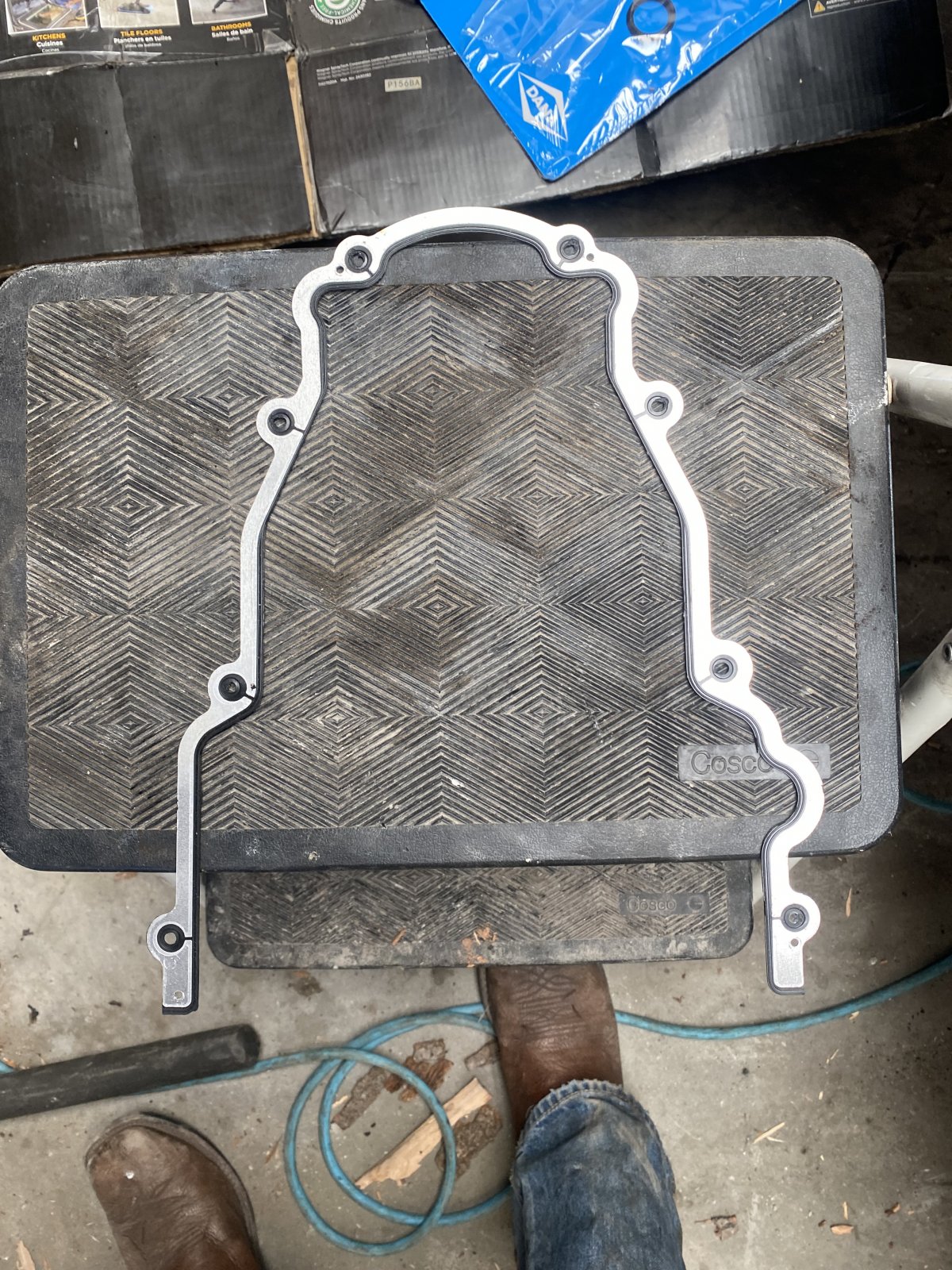

Definitely could see why the timing cover was leaking…. Half the gasket literally fell off as I pulled it away from the block. I was surprised that getting the new oil pump installed was pretty straight forward.

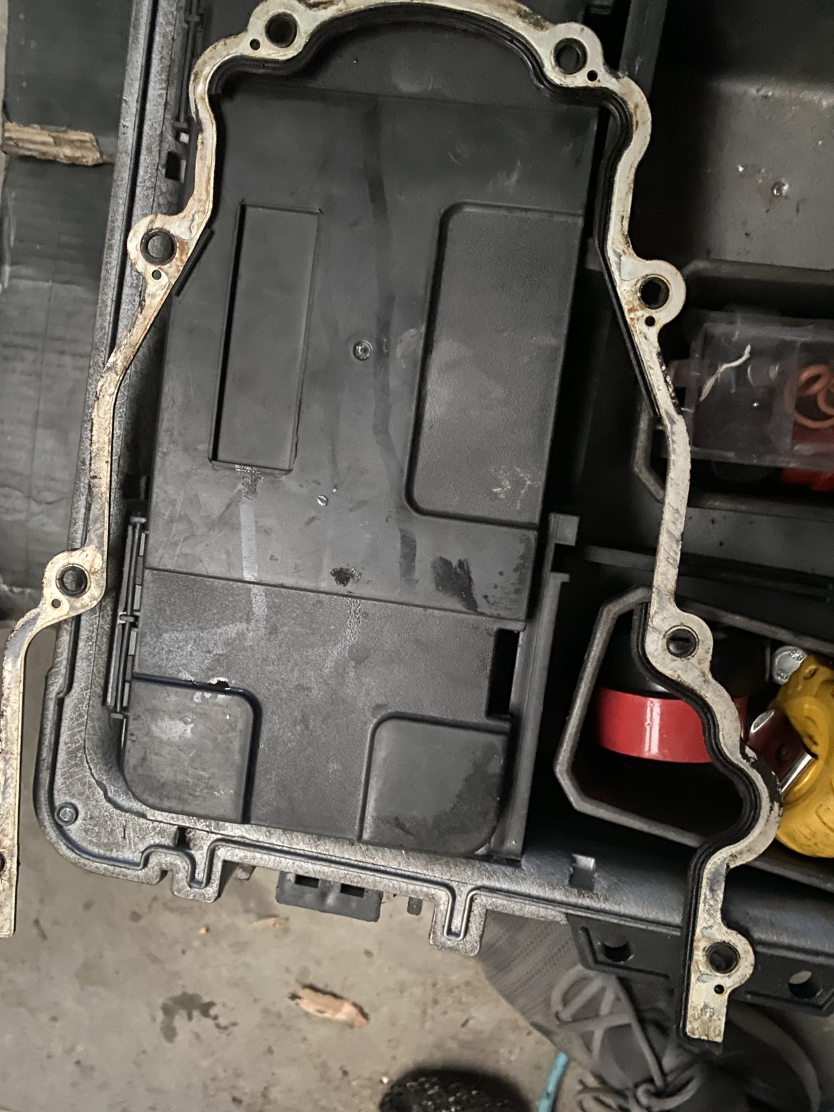

Oil pan clean and new gasket in proper position ready to go in. I knew it would be a difficult maneuver to get in with the diff still in place but I took my time and wiggled it up slowly and steadily in one shot, and then put the jack stand under it to hold it in place a couple inches below the engine mount so I could reach up and dab RTV into each corner. I think that sort scared me the most of the whole job and it went relatively smoothly. The rest of the reassembly fought me and many many loudly yelled swear words happened in the process lol.

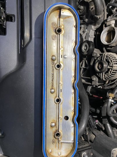

Threw new valve cover gaskets in, did the passenger side a couple weeks ago when I had a few spare minutes, and then the drivers side before the disassembly of the oil pan. Was having a weird little oil smoke under certain driving and figured it’s been close to 75k since the valve cover gaskets were replaced. Can’t believe how easy it is to swap out valve cover gaskets on these engines. Put new rubber grommets on the valve cover bolts as well since the came with the new gaskets this time around.
