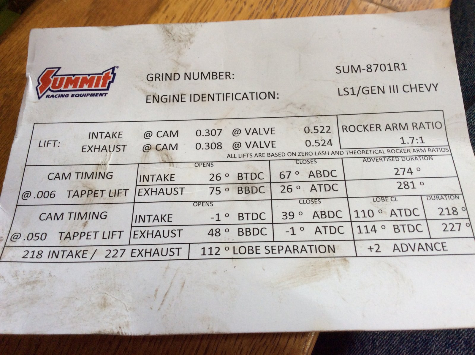

Well Richard Holdener dynoed a 5.3 with the summit 8720 which i will post the specs for, but it is virtually identical to yours valve timing wise at .050 lift. BUT with more lift. He saw about 60 hp increase, so i would wager a guess that you MAY see around 40 to 45 increase since you are still running full exhaust and he just tested with headers.

I do have headers and magnaflow cat back. The only stock part is the y pipe, I figured I could use the 02 sensors to help with the fuel injection, tuning that sort of thing. I was expecting more gains but in the long run I am fine with removing some of the drawbacks from stock and let those ponies run. I think I might go with black bear, I like the idea of mailing, there’s no way I can drive a distance to get it tuned.
