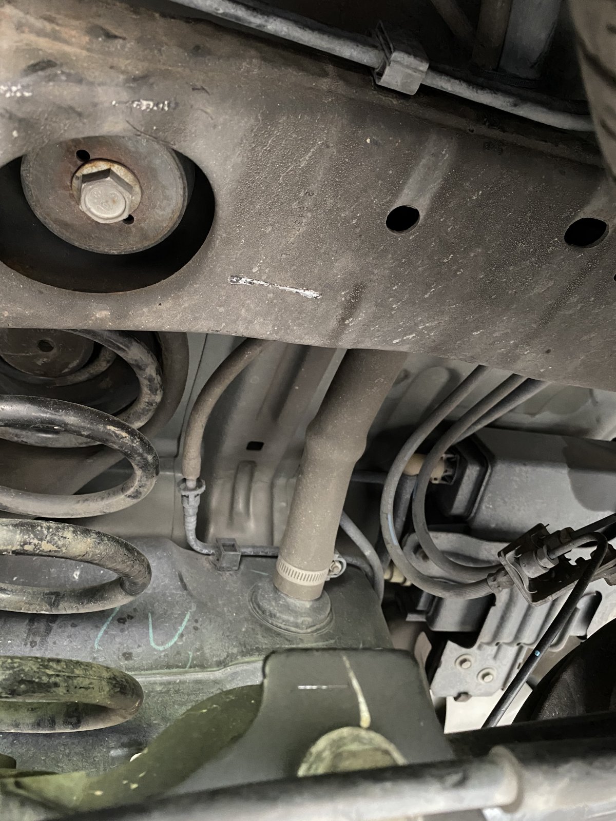

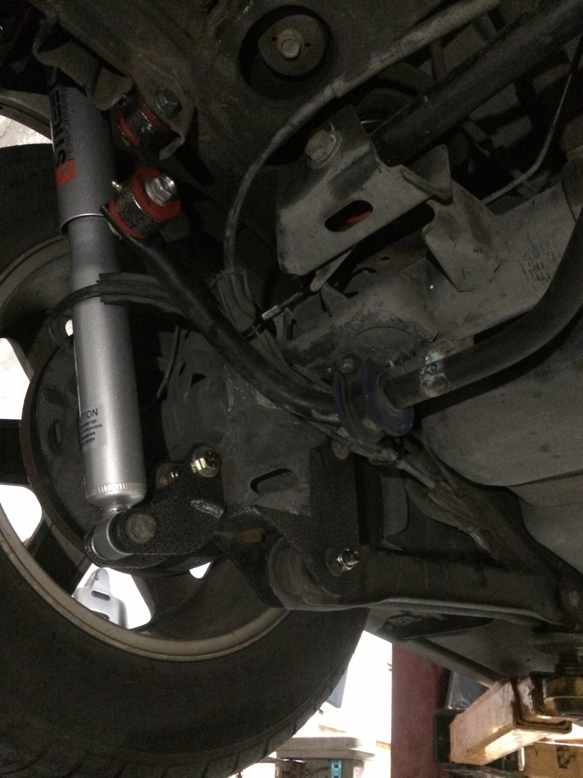

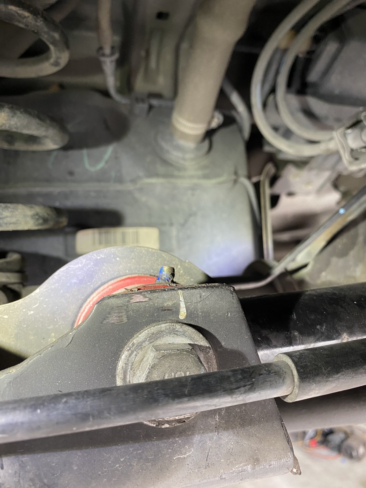

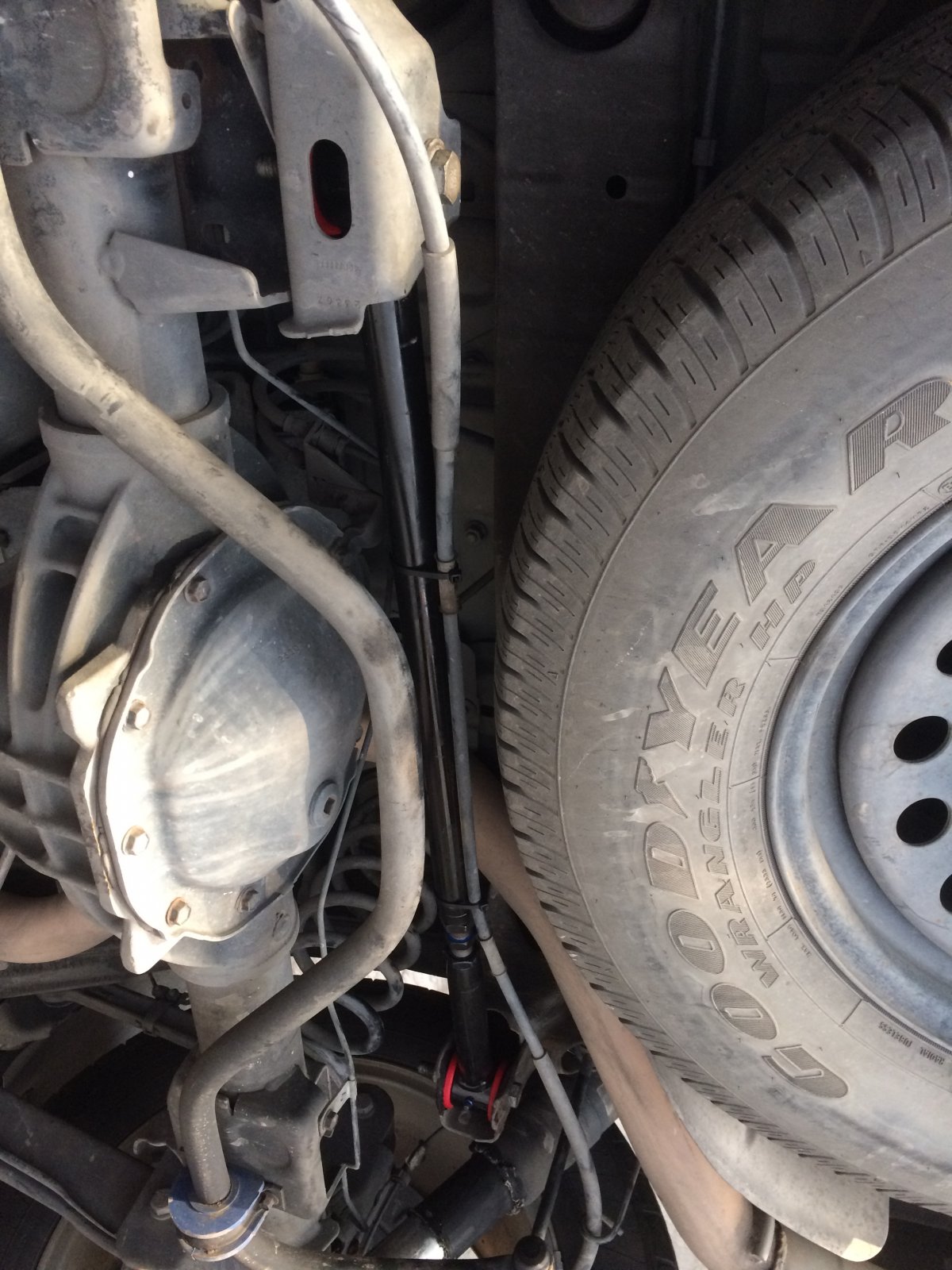

Cool! Movin on in life. Here's my FTM stuff. Note the UCA. I detached it from the axle, loosened the frame side, rotated it up outta the way then tightened the frame side bolt to hold it. Only took a few seconds with the impact to not have that arm in the way.
