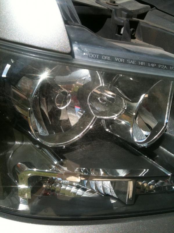

The headlights on my 07 tahoe have an unclear, foggy, haze. I want to know how to restore them back the way they were from the factory. Anyways I know the they wet-sand and then buff/polish them. What are the steps on how to do it. Please include the grit of the sandpaper i need, the materials such as what kind and brand of rubbing compound i need. Also include detail in which ways to sand and techniques( up an down, left to right, circular motion ect). Or let me know if their a more convenient way to do it?
He are some pictures of the headlights.

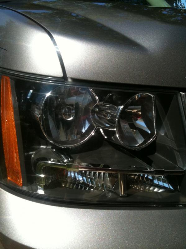

After
Turtle wax headlight restore 10 bucks and some free elbow grease. Been 2 months still looks good
The before pic looks like mine now. I'll have to try that stuff. Is it a kit with sandpaper or just a polish?
