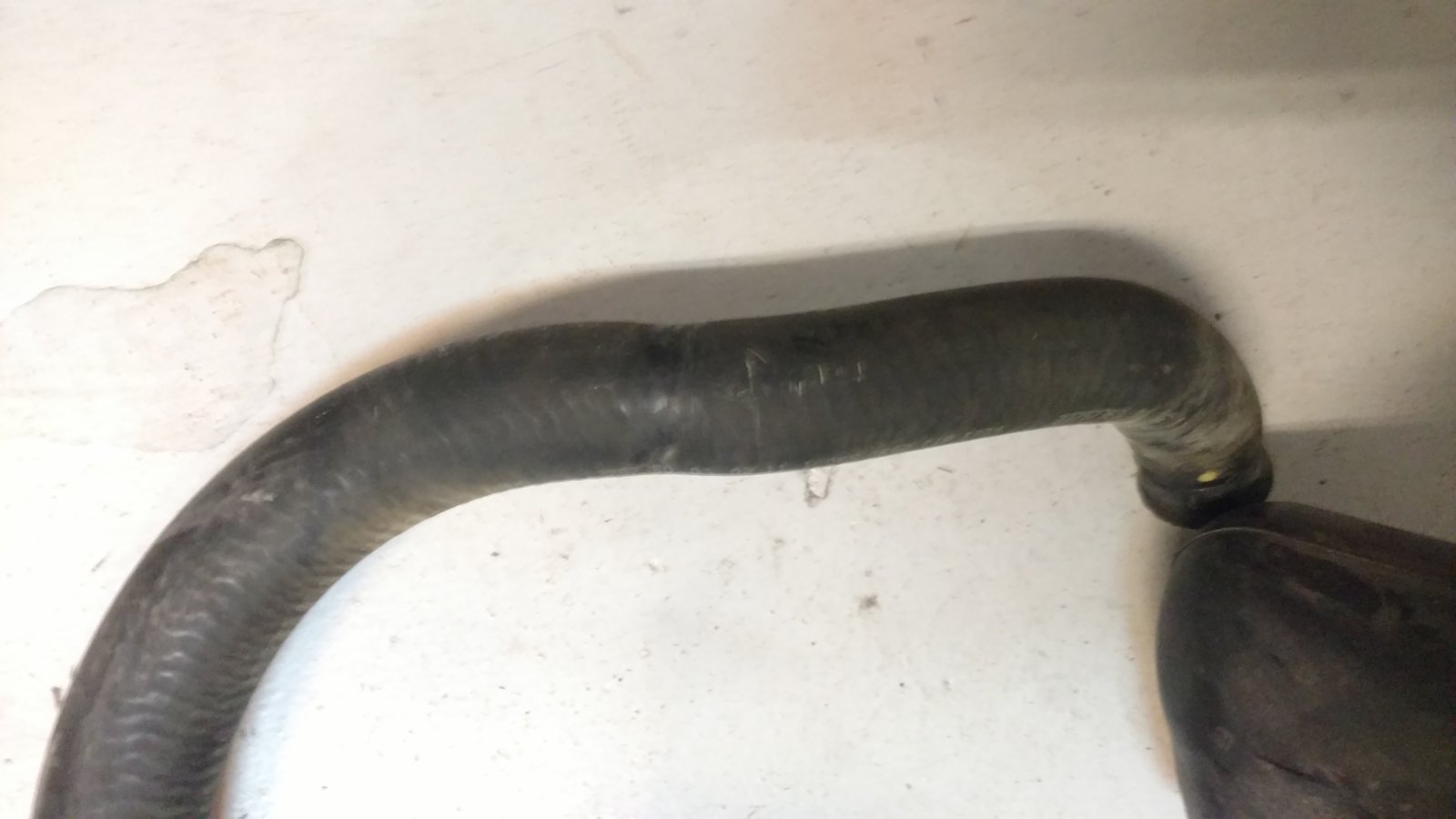

3. Discovered that my HP power steering hose and one of the AT cooler hoses is leaking. I have ordered a new HP power steering hose and will keep an eye on the AT cooler hose.

-I attempted to change out the power steering pressure hoses (to and from the rack). Unfortunately, the seals were leaking and replacement was a PITA! I spent about 6 hours meticulously scraping out the old cup seals and installing new ones. This part of the rack was very difficult to get to on jack stands. The new seals were very snug so I am keeping an eye for leaks. Bottom line is replace the entire steering rack if your rack is older and you have leaking pressure hoses. It's not worth spending an entire day scraping and pounding new seals into the rack. I might end up replacing the whole rack in the next year anyway.
