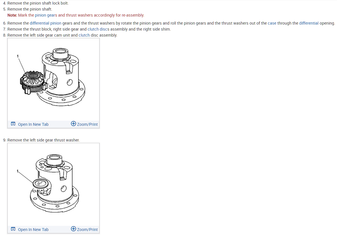

I have a 2011Tahoe with a GU4/G80 differential, limited slip posi. I already have pulled my carrier and am replacing the spider gears and side gears. Can someone explain to me how to use the marks on the gears to line them up and roll them in. Sorry but this is my 1st time digging into the rear end just having trouble rolling the new spider gears in with the new thrust washers. Any and all advice will be welcome. Thanks much in advance.

"Marks on the gear to line them up"? Never heard of this?
What axle is this?
The shims/spacers are supposed to be tight fit, to provide a force so the bearings/races don't chatter. I think if you install the shims, you can tap the spacer in place carefully.

On the spider gears, as you roll them in.... You'll want one gear turning one way and the other turning the opposite way. When everything is in the right place and the gears mesh and rotate, you'll be surprised how easily they roll in.....
rdezs
Nov 6, 2023
281
397
Maybe try it once without the thrust washers to get the feel of it

Thanks for the advice I will try again. When I read about the marks on the side gears and spider gears I thought they may need to be lined up a certain way. I will try rolling them in without the thrust washers just to get the feel. Could have been when I tried that one or more of the guide clips on the clutch pack may have moved into my way. I will post an update as soon as I can. Thanks again for the advice

It is a 3.08 limited slip posi with the gov locks. There are 2 marks on the spider gears and on the side gears inside the differential carrier that are supposed to be some sort of line up guide. Hard to find much about them on the net. They are not on the ring and pinion gears as far as I know

I didn't use any special tools to remove the gov locks just a long skinny punch to tap out the pins. Then I used a small magnet to remove the square pin holder from the center . After that you have to be careful because the side gears can fall out with the clutch packs and guide clips. One side gear has a snap clip to hold that side together the other side doesn't have the snap ring and could fall apart. The guide clips are one size on one side and another size on the other side clutch packs. I found a diagram of the clutch pack and put it back in order according to it, put that one on the side bearing and used a rubber band to hold my guide clips on the corners, dropped that side back in and gently pulled the rubber band out. Repeat that for the other side gear. Just have to get it all lined up right so I can roll those spider gears back in place so I can get it all together and back in the Tahoe

Hello again, Gents. I said I would come back with an update and here it is. I finally got the carrier reassembled. My mistake was thinking I needed to use all the shims in the clutch pack that I originally took out of the carrier. As I was having trouble rolling in the spider gears with the thrust washer on them I decided that I had one to many shims in the clutch pack. I took one out and like a magic trick, they rolled in perfectly, lined up perfectly, and I put the gov locks back in and all is well. So tomorrow I am pressing on the new bearings and putting this monster back together. Just wanted to thank the guys that tried to help. On another note, the marks on the spider gears and side gears didn't mean anything.
