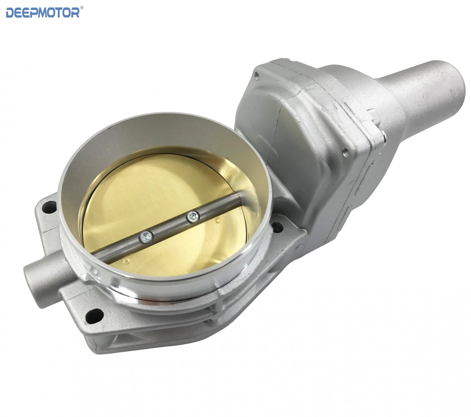

Canceled throttlebody order. This morning a friend of mine let me put his 2008 Avalanch tb on. Relearned it, went and drove, does the same thing. Put mune back on, relearned and same thing. I do notice that the idle thing starts when its 100 degrees or higher. Being annoyed, took it to a second dealership, explained it, and they tested it, said they have no idea, and they said they have a handfull of customers Tahoes with the same braking problem. They said mine was the worst yet, same problems, no idea. They did also state a lot of customers have come in and suffer from vapor lock.

This is almost always a throttle body issue. What is the percent at idle? Even after cleaning and old worn out throttle body can still do this.
Anyway, if you don't want a new throttle body, have a tuner raise the idle 50 rpms.

I have a tuner that i can look at load, thought about that but never tested it, will check it out tomorrow. They said too late to cancel throttle body, but i can return it once i get it. Might just keep it, especially i trust an AcDelco unit better than the Doorman. Had issues in the past with Doorman items.
