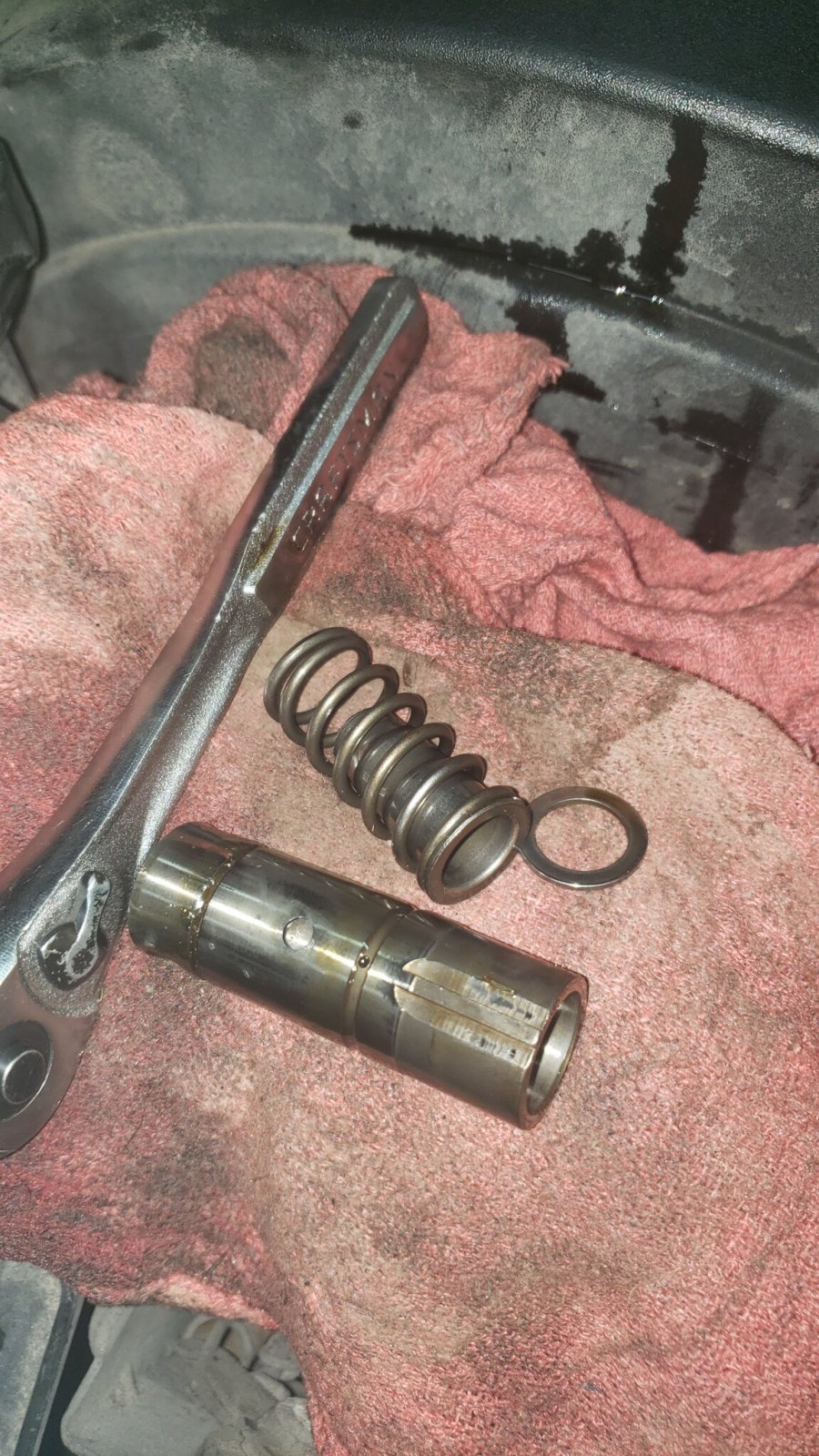

Hello folks,
I finally got around to fixing my 5.3 2012 tahoe and got rid of afm, it's now running smooth and no faults.
I used a kit from Texas speed along with oil pump and timing chain for long term piece of mind.
I had help from retired mechanic relative who supervised my spannering. There were a few issues such as a nest for some creature under the intake. I had some unexpected repairs to make once we started digging around underneath.
I decided if I was going in deep I may as well do the chain and oil pump. I was tempted to get some more power but kept it stock to avoid dramas.
I kept the VVT as I used a L96 cam ( from a 6.0) which works without DOD.
Dropped the diff out as a seal had gone which made oil pan removal easier. I purchased an LS Oil Pump Pickup Girdle for the oil pump which worked really well and used 2 bolts rather than one that gm had.
Camshaft was well chewed and roller wheel was scored but not sure what was wrong with it and it appeared ok.
If I had to do it again, I would take engine out for speed and ease of access. It was done on axle stands in a small garage which not ideal but can be done.View attachment 371090View attachment 371094
