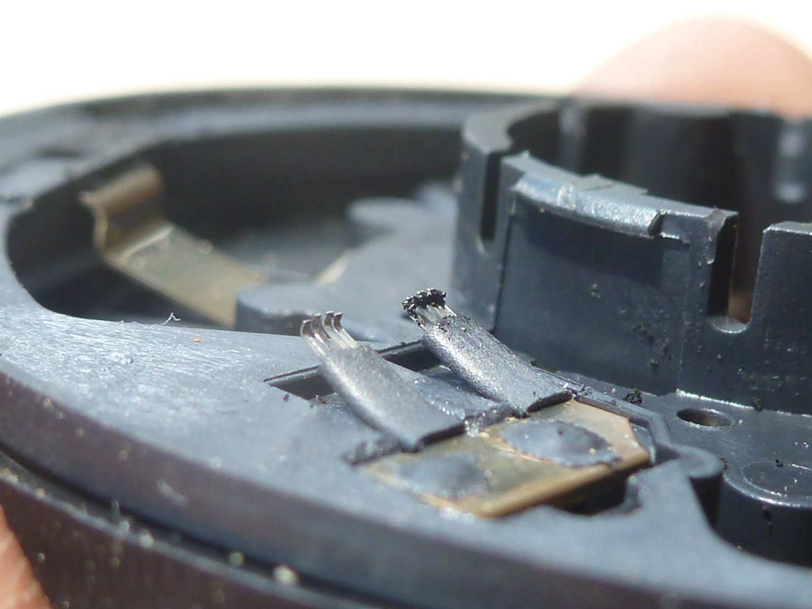

Just a thought here. Last year I replaced the position sensor inside the encoder motor on my 05 Yukon. There was some degradation of the resistive material as well as some 'schmutz' on it that I suspect came from grease on the shaft but could also come from a leak from the seal on the transfer case? Mine has been fine since the replacement sensor went in but if I were seeing multiple failures I might be tempted to have a good look at the seal on the transfer case, or at least do a thorough inspection of the encoder position sensor of the failed unit.

Ok thank you for sharing. When I give up on the dealer I will look for this. I know when I changed the encoder motor the shaft/gear was pretty clean and not oily like in your picture. When i took the old one off I looked for this issue before replacing and did not notice a build up on the little fingers but who knows. I am headed back to the dealership as soon as the Service 4wd message come back on. Unfortunately it typically happens when I start it to go to work at 5:30am and the dealer is not open. lol
