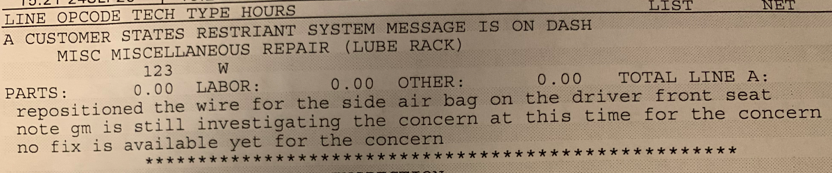

they’ve had my Tahoe 3 times and still can’t do anything about it.
Just bought a 21 High country and experiencing the first gremlin. Getting a popup on the dash and the airbag light goes on. Popup says "Service Safety Restraint System". It lets me dismiss it and both the popup and light go away. Seems to come back after a period of driving and or the next time that I am in the car after about 5-10 minutes.

FYI. I have had mine to the dealer twice and the problem went away for a week or so in both instances.

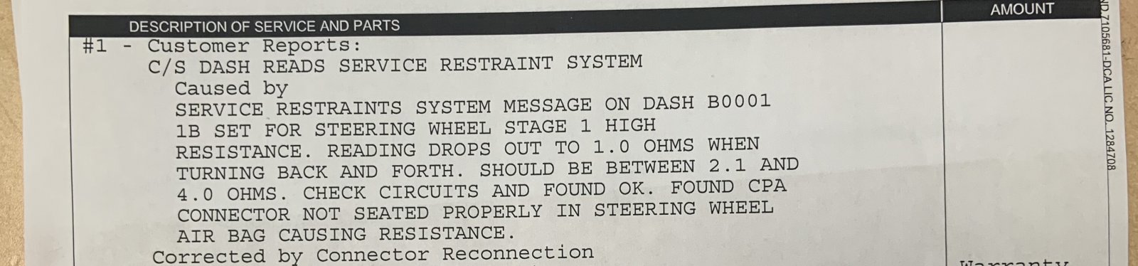

Does anyone know what exact airbag/connector theirs says it is? Like driver's bag in the steering wheel, driver side curtain, etc? Then we can see if everyone's is the same one.

Update- brought my 2020 Silverado LTZ to dealer and they said that it is an airbag coil. According to the technician, it is intermittent because of changes in electrical resistance in the circuits that occur when different systems are active or not. They were able to recreate the problem consistently and tie it to a change in resistance. So the airbag coil is on order and my truck is out of commission for two weeks. Driving a loaner. I am not convinced that this will be the fix, though I hope it gets done and that I do t have to chase electrical gremlins for the next year.
