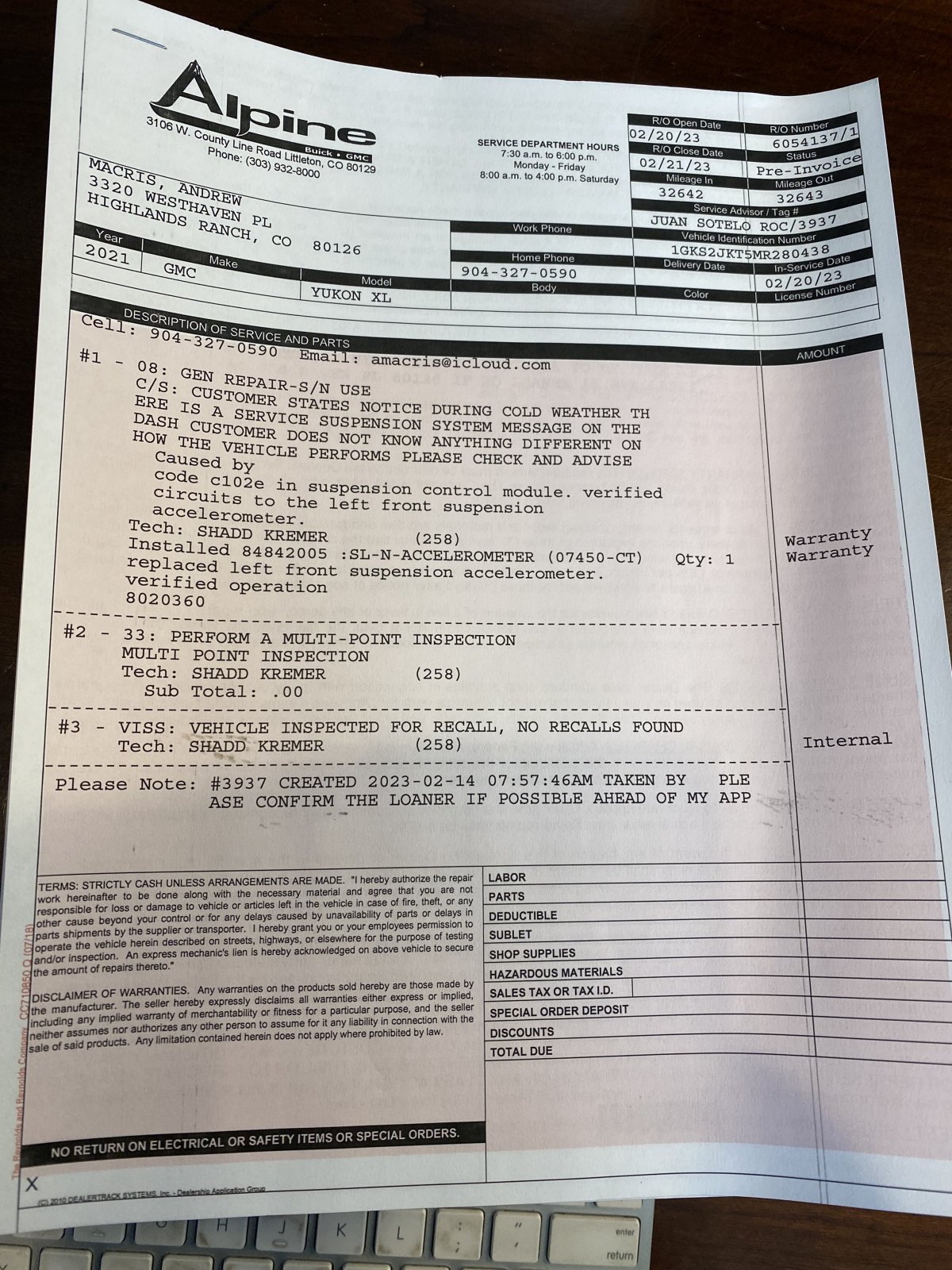

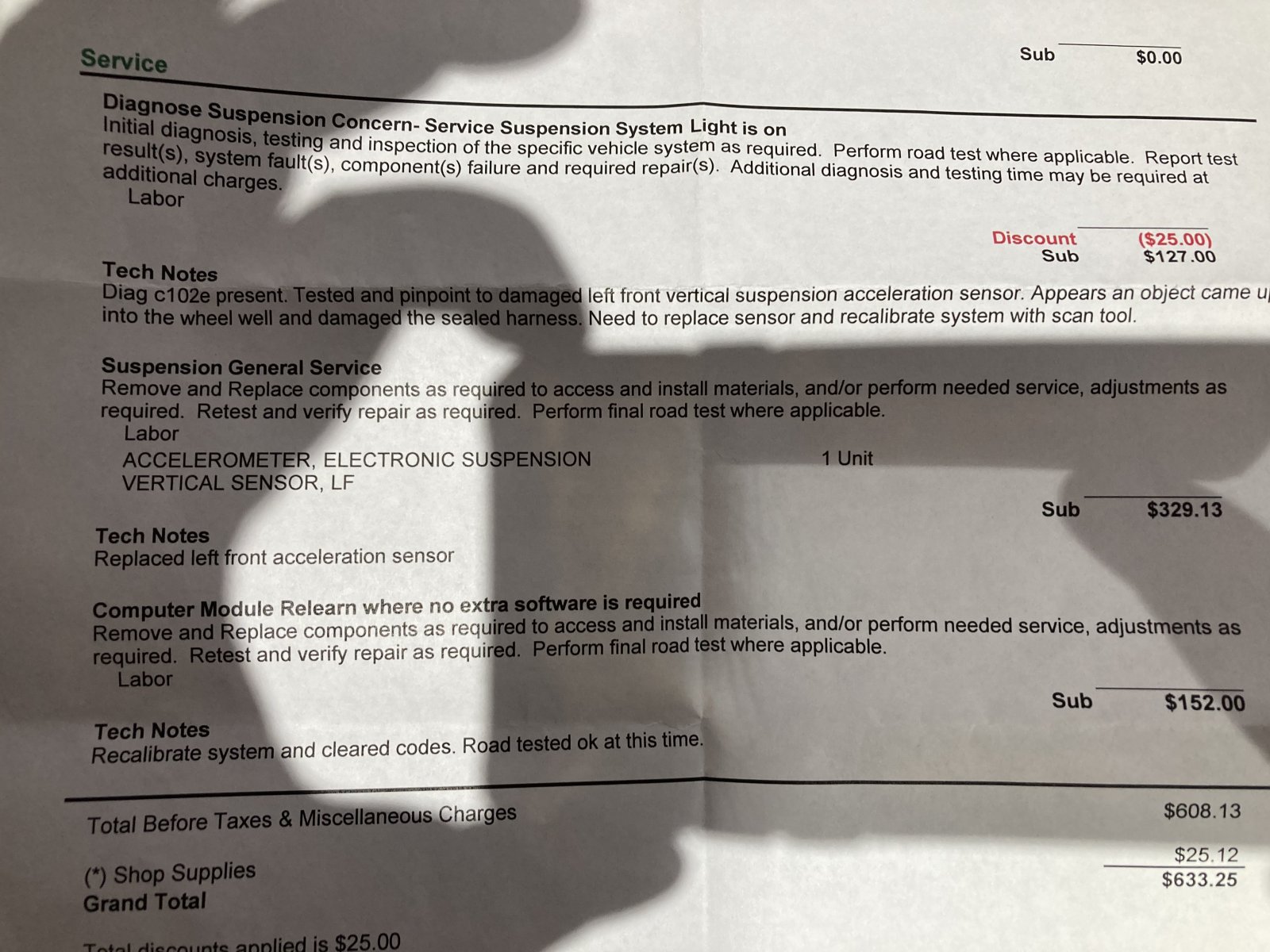

My 21 Tahoe had it at 30k
Dealer said front right wheele wire connected to a sensor relates to suspension is cut, they replaced that

Yea, my original dealer said they had swapped the module, but the message came back the same day I got it back. I took it to Alpine right down the road and it was fixed in 2 days and still fixed. Needless to say I have switched my preferred dealer.

Thanks for the information. Hopefully this can help my dealer get the issue figured out for me. Interestingly enough if you Google the dtc C102E the attached video pops up that walks through diagnosing the issue and replacement of the sensor.
I had the same issue with my Tahoe. Took it to the dealer several times. It ended up being a faulty accelerometer. Replaced that and it’s been fine.
