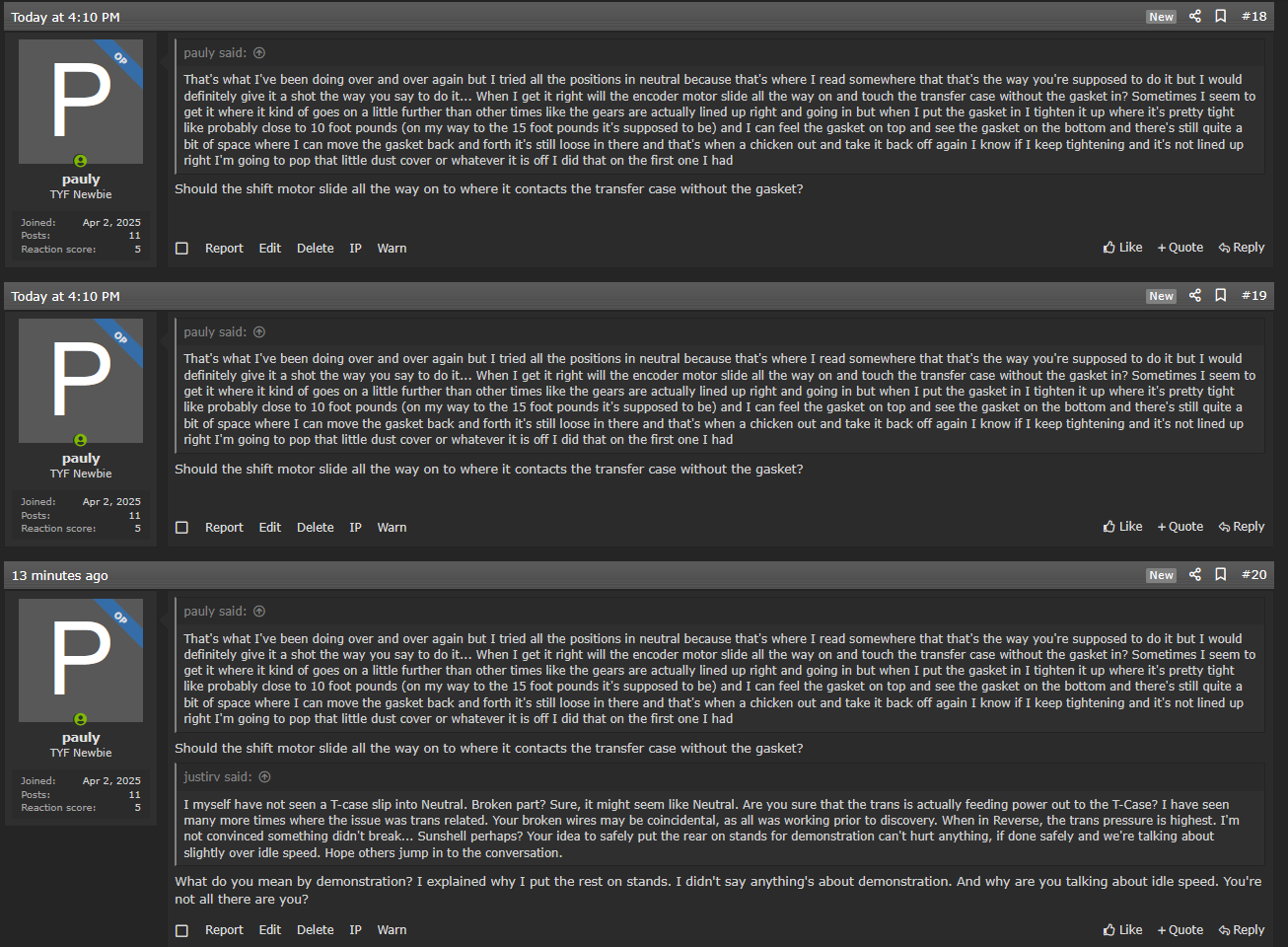

That's what I've been doing over and over again but I tried all the positions in neutral because that's where I read somewhere that that's the way you're supposed to do it but I would definitely give it a shot the way you say to do it... When I get it right will the encoder motor slide all the way on and touch the transfer case without the gasket in? Sometimes I seem to get it where it kind of goes on a little further than other times like the gears are actually lined up right and going in but when I put the gasket in I tighten it up where it's pretty tight like probably close to 10 foot pounds (on my way to the 15 foot pounds it's supposed to be) and I can feel the gasket on top and see the gasket on the bottom and there's still quite a bit of space where I can move the gasket back and forth it's still loose in there and that's when a chicken out and take it back off again I know if I keep tightening and it's not lined up right I'm going to pop that little dust cover or whatever it is off I did that on the first one I had
Should the shift motor slide all the way on to where it contacts the transfer case without the gasket?

I myself have not seen a T-case slip into Neutral. Broken part? Sure, it might seem like Neutral. Are you sure that the trans is actually feeding power out to the T-Case? I have seen many more times where the issue was trans related. Your broken wires may be coincidental, as all was working prior to discovery. When in Reverse, the trans pressure is highest. I'm not convinced something didn't break... Sunshell perhaps? Your idea to safely put the rear on stands for demonstration can't hurt anything, if done safely and we're talking about slightly over idle speed. Hope others jump in to the conversation.
What do you mean by demonstration? I explained why I put the rest on stands. I didn't say anything's about demonstration. And why are you talking about idle speed. You're not all there are you?
