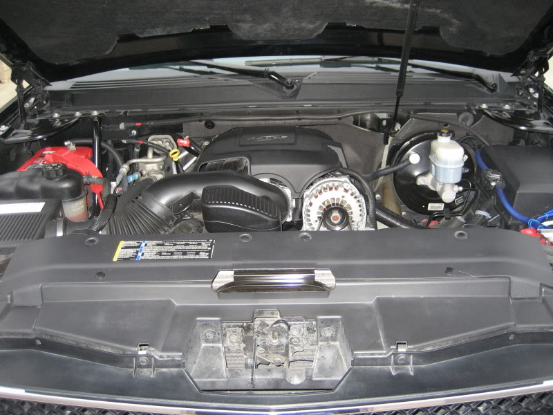

What model yellow top should I get for my 07 Denali?
I can get some numbers off mine, but if you go to an auto parts store that supplies them then they'll know which model you need.

sorry to thread jack but I noticed a few of you recommending the optima yellow top batteries and was wondering if you guys run those with a stock setup or have some type of audio system? I don't plan on adding any subs, probably just keep it at the stock NAV and speakers as my wife could care less for sound and wanted to get a new battery just couldn't decide red or yellow
I ran the yellowtop with a stock setup for a little bit, but I installed a system not too long after getting the yellowtop. The battery has held up pretty good, and hasn't quit on me yet. It starts up the truck with ease (no matter if it's cold or hot) and I've had it for 4 years now. I like it because it's made for systems and has a higher reserve capacity.
