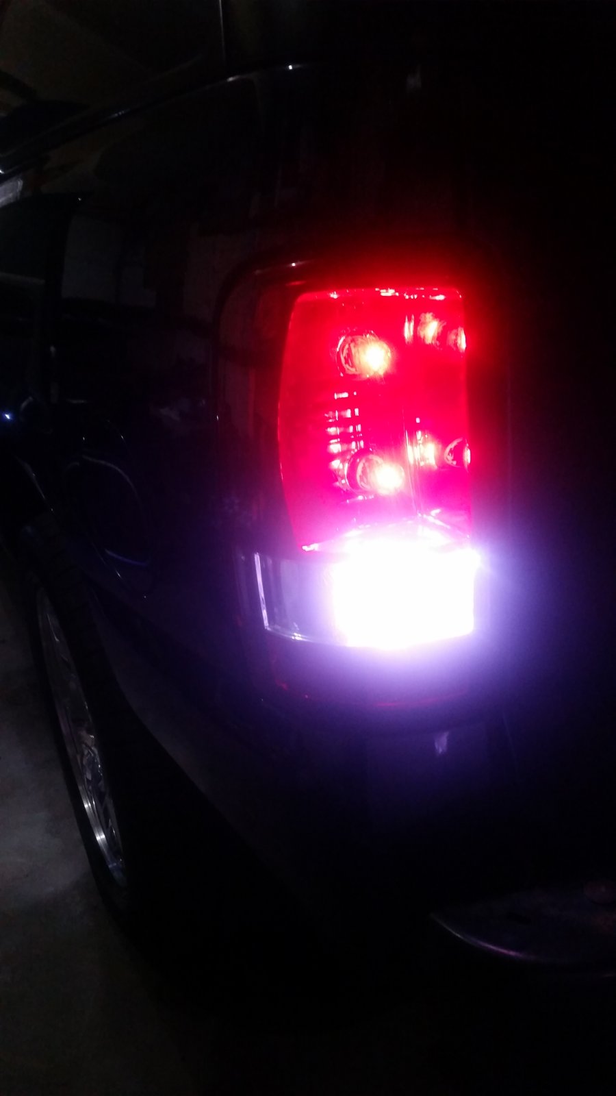

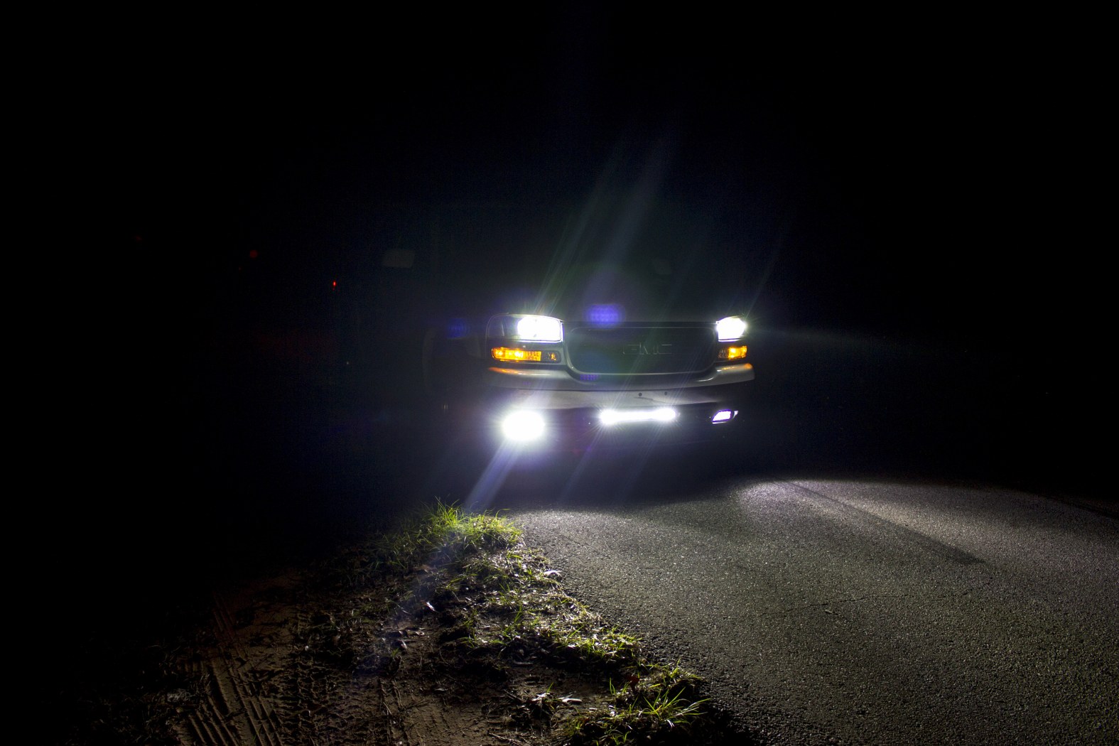

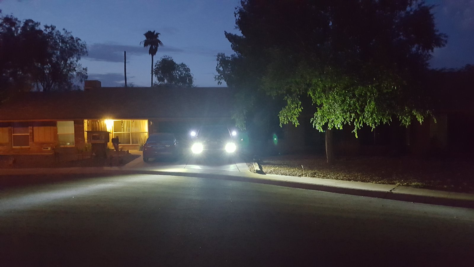

6000k ddm hid lows
6000k 60 smd switchbacks
6000k morimoto fogs
Also drl delete and added turn signal for full row signal mod plus 50w 6ohm resistors.
Newest mod, i added Anzo clear turn signal housings

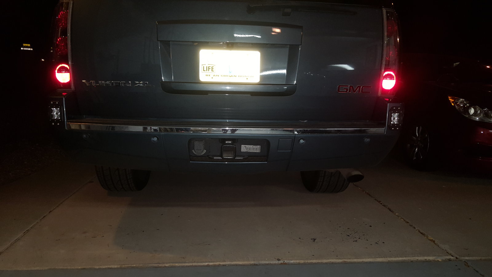

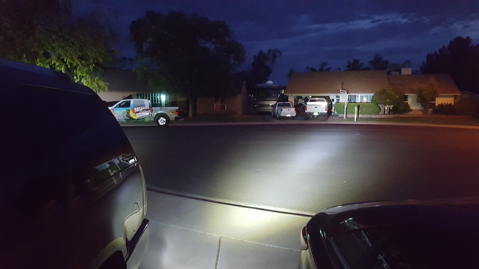

I'll start with my puddle/courtesy lights in the mirrors. Instead of the festoon 42mm led replacements I built a plate out of plexiglass, abs plastic or aluminum will work but i had this laying around, and bolted in some led 23mm projector eagle eye bolts.
They are insane bright and one of my favorite light mods I've done to my tahoe.

Factory headlights for now. Wanna put in depo projectors or retrofit later. Fogs are factory too but I cleared them. I'll put up pics.

The leds you have in them don't blind oncoming drivers? I know I've read on here to not put the leds in factory headlights.

I have hids not leds, which are actually brighter.
Yes you will read that everywhere , not just here lol.
Nobody is blinded , but yes hids are a little distracting to some but they'll live:waytogo:
