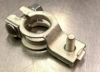

Military-style clamps like these actually provide more solid backing for multiple accessory cable connections... The fat block on the accessory side of the clamp won't cave in on you. Something like these would be much better.
I would do these on top. You can also swap out longer bolts, if you need more room.
Those are excellent with use those at work when we have something custom with lots of accessories needing solid battery power

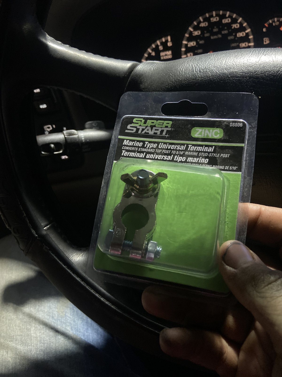

Well you know what to get when you have to get a new battery! If you get these military clamps or the marine ones I think you can get away without cutting the factory wires down just remove the factory terminals and plastic covers and use the ring that remains to mount it

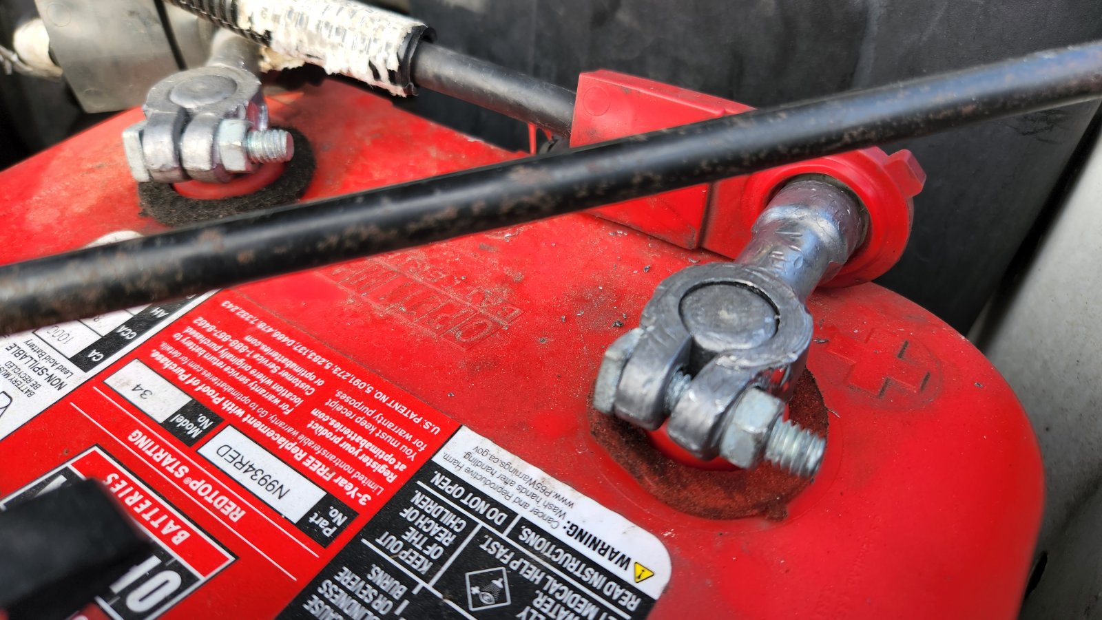

I second @Fless you may have issues drawing enough current with that positive terminal not making contact with side of battery. Either way, it's also going to come loose on you and constantly be a problem. You can buy the terminal bolt at the parts store. I don't know what it's called but they sell them.
Then don't attach accessories / addons at the battery, use the post on the under hood fuse block. Or the red junction box next to the alternator.
I know a lot of people like the top posts... I've never had issue with side ones though.
