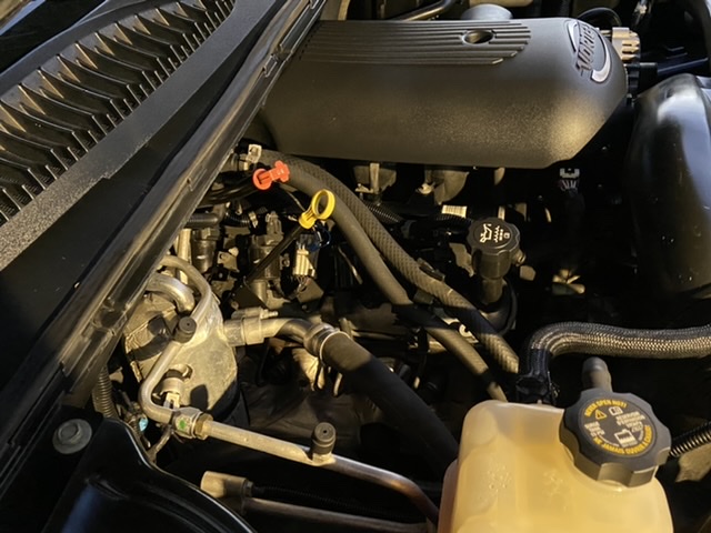

Then I suggest buying the vapor canister and purge solenoid and replace both of them while you’re under there. The purge valve is on the fuel rail under the hood and can be done after you replace the others or before.

Sure- buy a new gas cap, purge valve and vent valve if you want to try all 3, or the canister itself. After that if the code doesn’t go away it’s the lines and you don’t need to buy new ones, just blow them out like mentioned.
And that's exactly how I spent my day today! Ordered all 3 from Amazon...the ACDelco replacement parts.
Pretty easy job actually...except for the stubborn hose clamp tabs on the Vapor Canister Vent Valve (the one under the truck). Still, pretty quick and easy. And just enough clearance under the truck so that I didn't have to jack it up!! Yes!!
So...now I just have to put some miles on it and see if the CEL comes back on. Hopefully not. BTW, in taking off the old parts, I didn't see any debris or charcoal bits coming out of any lines, and no rust underneath anywhere. And I never had any 'slow-fill up' with the gas, so maybe the charcoal canister itself is ok?
Thanks for all the advice and help guys...greatly appreciated!!!
