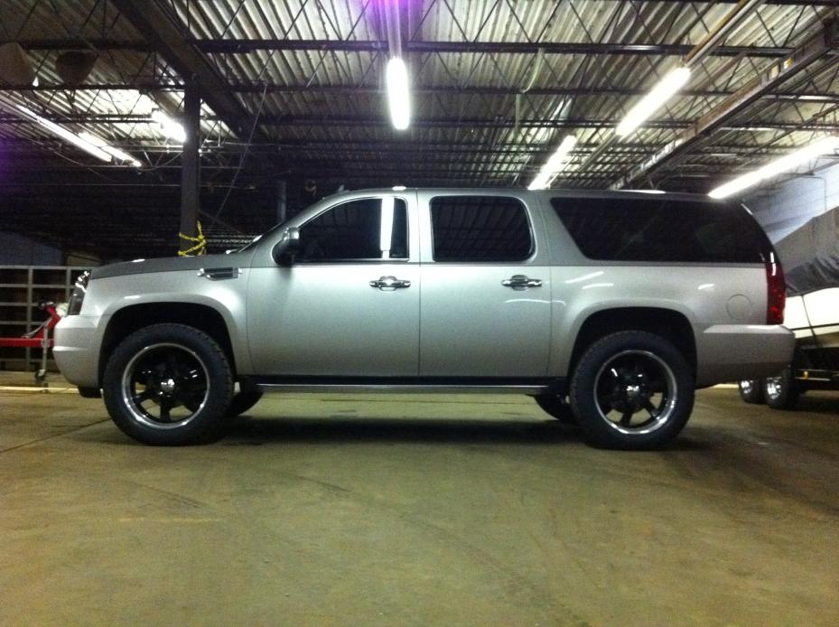

If you are willing to do some trimming you can run 35s with out spending $1500+. Run a 2.5" lift kit in the front and do a 2" body lift. If you are running +32mm offset and do some trimming, 35s are possible. I am running 34s with just 2.5" front lift and 1" rear lift with minimal rubbing on +32mm offset wheels. I drive 98% of the time on the street, so I do not need much clearance for articulation. If I were to decide to spend more time offroad, I would need another 3-4" of lift.

Could u post a pic of ur ride? And I have 2.5 an 1 in back leveling kit already. Nobody makes a body lift for nnbs Tahoe though
