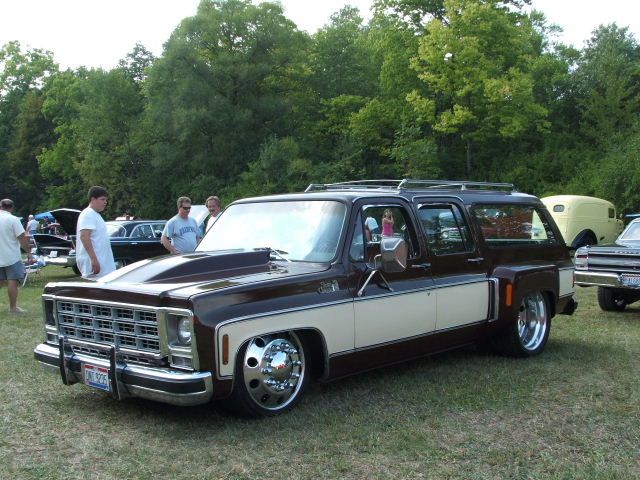

This is slightly off-topic, but 2015+ you can buy a Suburban 3500HD as long as it's for a fleet. There aren't many out there, but occasionally you can find one on cargurus or similar.

Would be cool if it also had dually fenders and a duramax engine :naughty:
