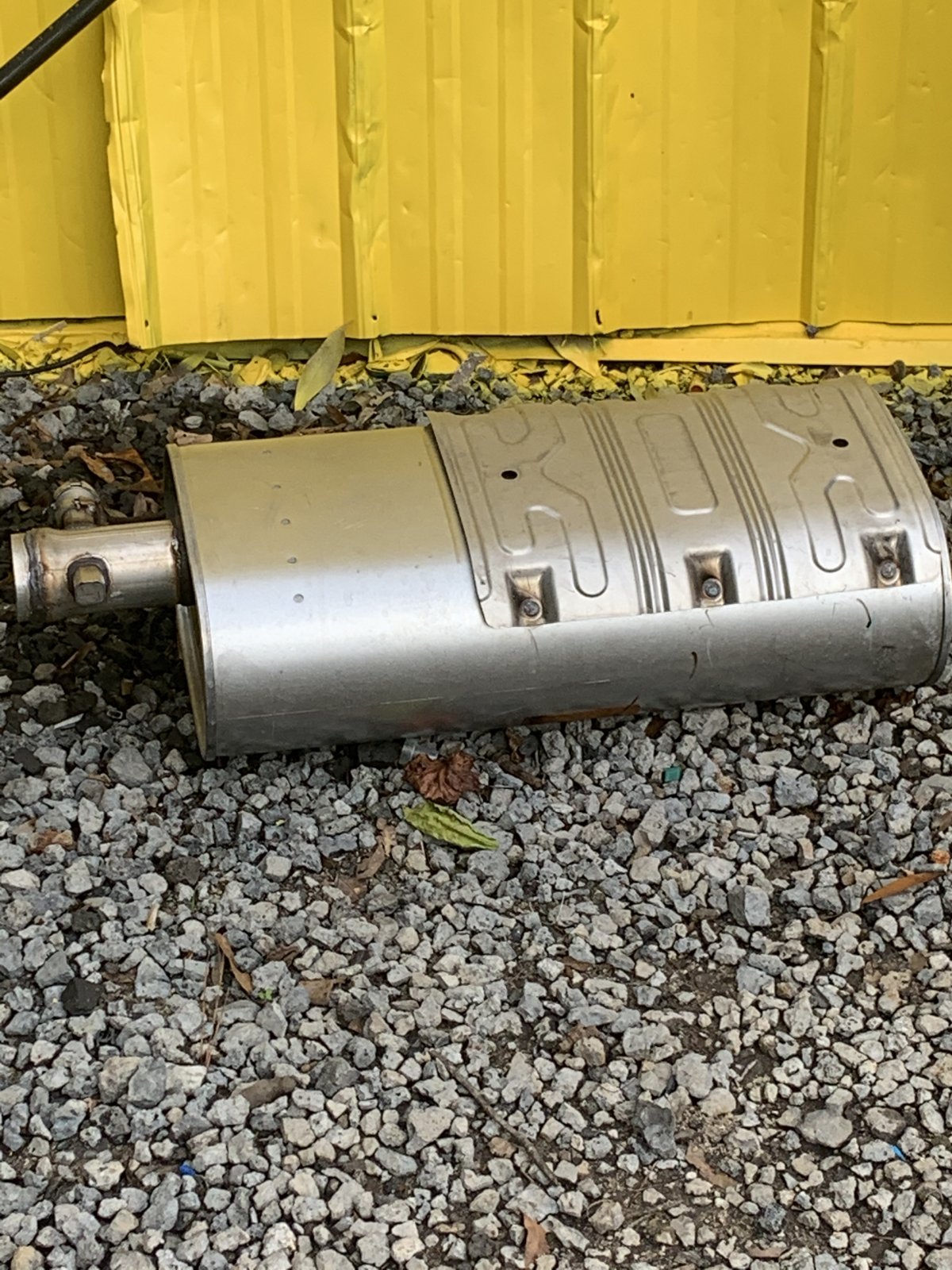

MY 6.2 has a flapper on both sides of the muffler. If you look at my pic in previous post it is even stamped "adaptive Valve". My understanding is that 19-20 Sierra and Silverado only have it on the Egress side toward the back of the vehicle. My 16 Yukon Denali also had 1 flapper valve. Borla actually made a catback for for GM that had the valve to reduce drone.

Did you notice a second valve on the other side of the muffler? This looks like the ingress side. Any info what I need to do to wire mine?
Only one front side of the muffler. You just need to rotate the valve clockwise and find a way to secure it if you want it open all the time.
