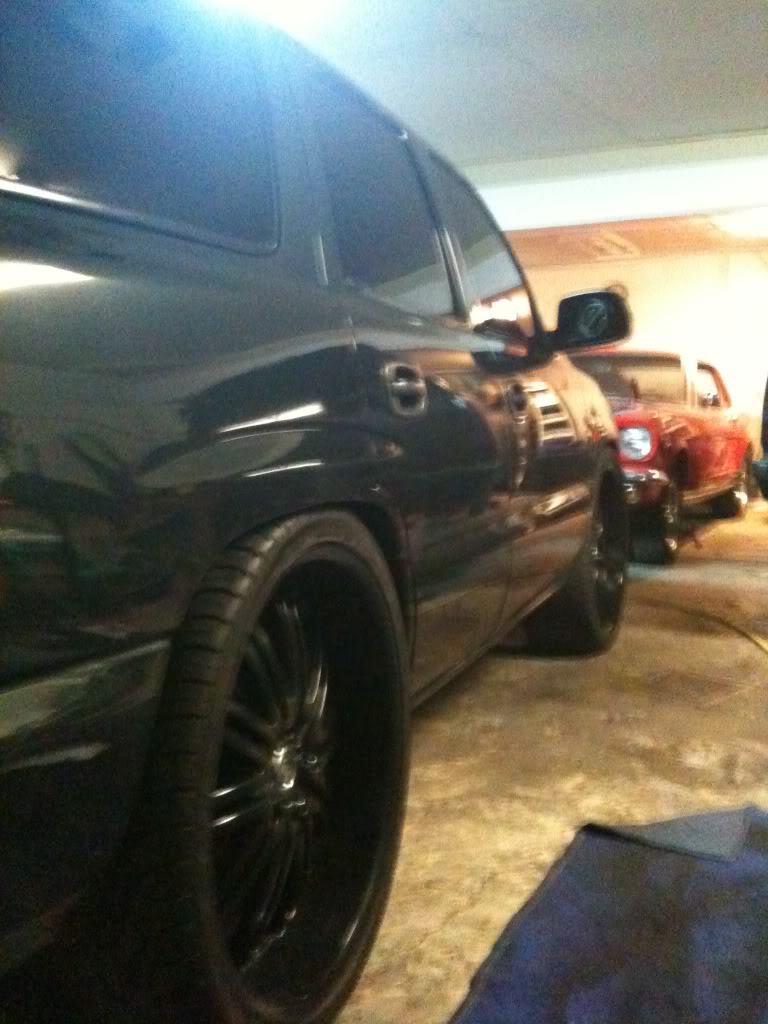

got my tahoe back today and decided to install the DJM end links that I ordered from StylinTrucks
they looked REALLY short compared to the stock ones but it shouldn't be that big of a deal considering I'm 3 inches lower in the front
go to install them, get everything torqued down take the jack stands out and let it drop and the sway bar is touching the tie rod end
when I drive its really difficult to turn and you can hear it rub
what did I do wrong?
there are no instructions that came with the links nor can I find any online :(
