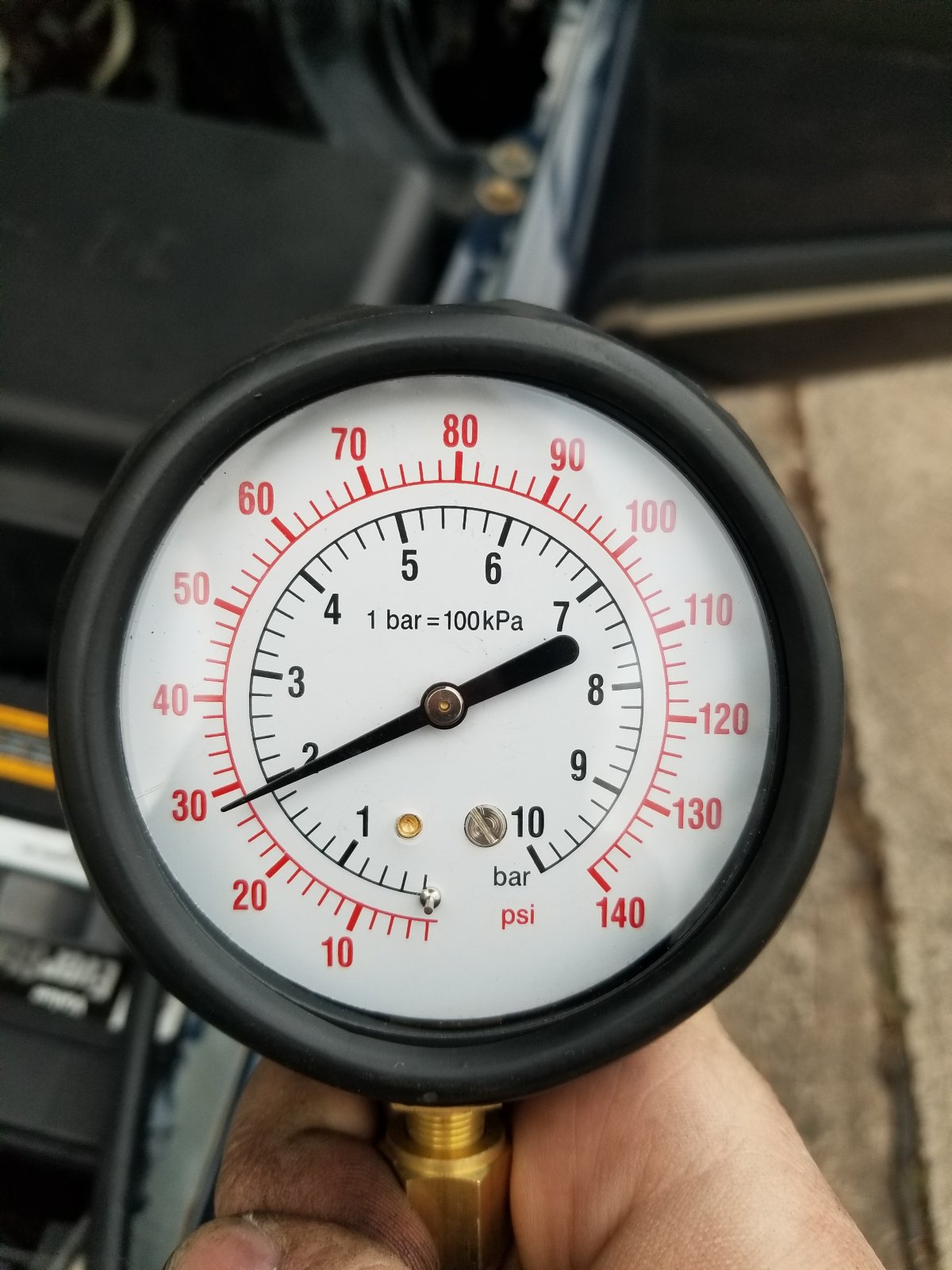

Would this oil pressure testing gauge work alright for what I need? The oil pressure sending unit is all the way by the firewall behind the intake correct?1673493226079.png

Would this oil pressure testing gauge work alright for what I need? The oil pressure sending unit is all the way by the firewall behind the intake correct?View attachment 389389
Sure and yes. There's a special socket available for it if you need it.

So I got the oil pressure tester. But I dont believe any of these are the right size? Reading online it seems like it's a 16mm male into the threads where the oil pressure sending unit goes.
I bought that same oil pressure gauge kit from Harbor Freight. It does NOT fit LS engines out the box. You need to buy or make an adapter. Since I replaced my oil sending unit just prior to buying this gauge, I used my old oil pressure sending unit to make an adapter. I drilled it out and tapped it so that the threads on the hose in that kit would screw right into the base of the old send unit. Harbor Freight sells a cheap tap and die set that has the correct size tap you need. I believe it was about 10 bucks or so. But it's a CHEAP set. The tap handle broke as I was using it. But it served it's purpose, to tap that one hole I drilled in the base of my old oil sending unit. After you make that adapter, it will screw right into the intake manifold where the oil sending unit screws in. And it will also screw into the block at the oil access port right above and behind the power steering pump after you unscrew the pipe plug from the port.
I think I'll buy an adapter on Amazon.... lol. I'm also considering just running a thicker oil like 10w40 for now to buy me some time because I'm low on funds at the moment.

M16-1.5 male to 1/8" NPT female:
I was going to originally do that, just buy an adapter. But it would have taken 2 or 3 days to arrive, and I was ready to get it done. After I couldn't find anywhere local to buy one, that's when I decided to just drill out my old oil sensor and just make my own adapter.
