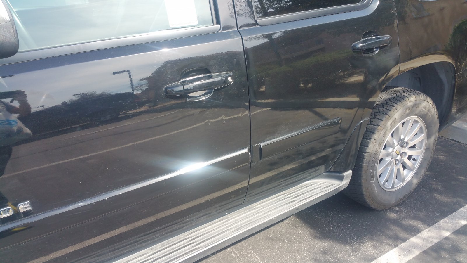

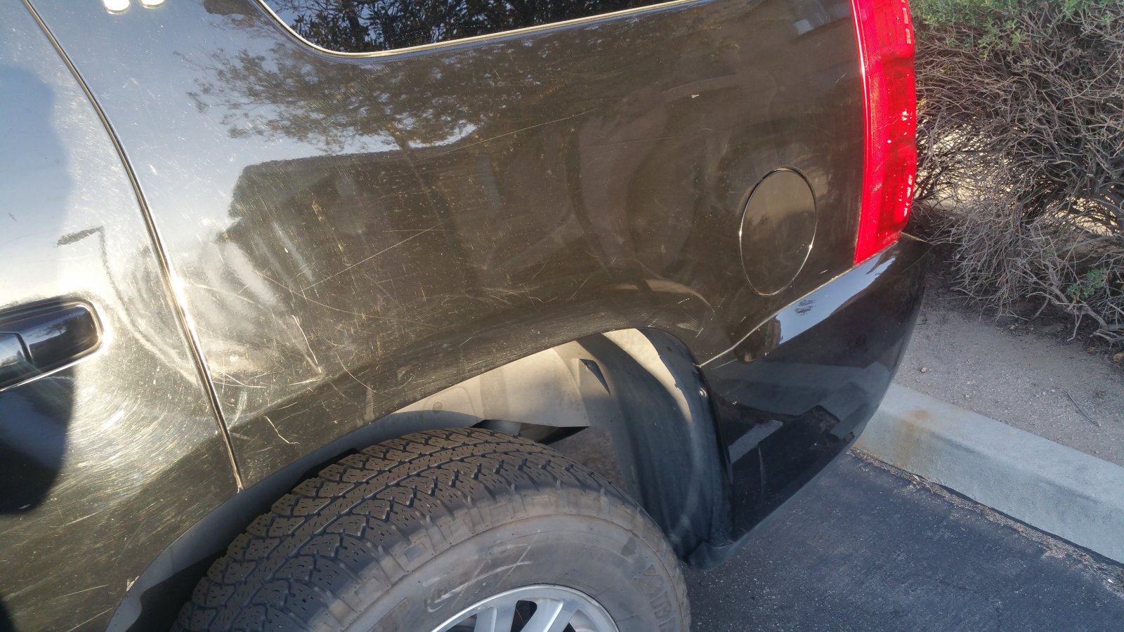

Those are barley even scratches. That shit buff right out. The ****? if it’s totaled then let me buy it off you for cheap. I’ll bring u cash right now for the low

Hit it with a good compound like Meguiars Ultimate Compound and a moderately aggressive pad on a DA polisher. I'd bet that you can make most of the scratches disappear.
But first, try parking elsewhere and see if you notice any difference in terms of new scratches.

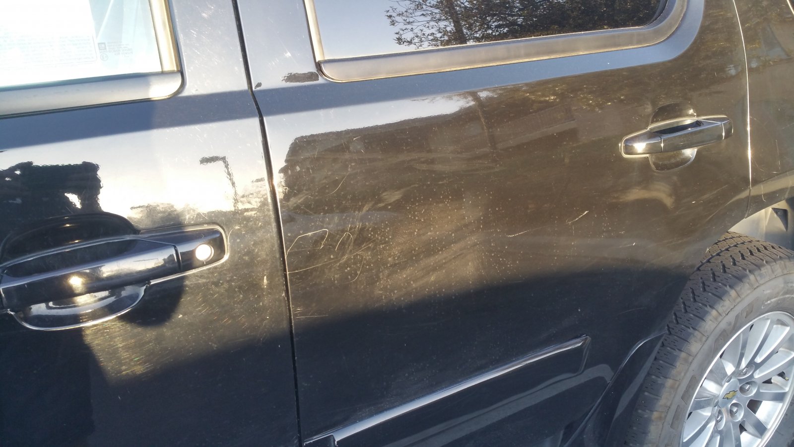

Looking at the pics it really looks like it was waxed over to hide the scratches at some point and maybe that coating has worn off and exposed the existing scratches? The paint appears to be badly swirl marked + scratched.

1. are you sure you didn't accidentally cause the damage when pressure washing the paint at the car wash?
2. if the previous owner/dealer covered the scratches with a tinted wax and you pressure washed it clean, you most likely stripped the wax and uncovered the scratches
i agree with the others that mentioned the scratches look weird.
